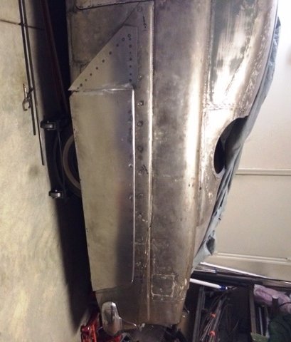

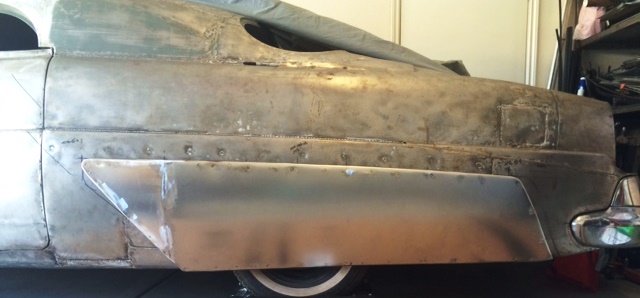

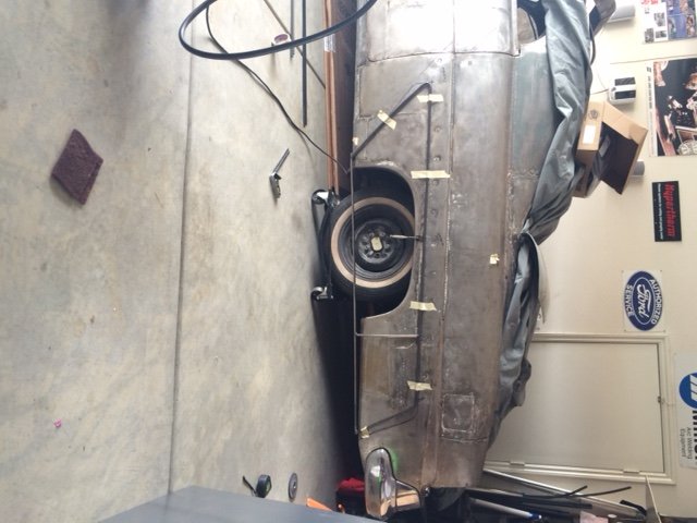

    Hi Nailheadjay, nice Buick. I wanted something different for my Merc and found a guy on here that did some super long skirts for his Cadillac project. He made them out of a skeleton of 1/2" round tubing and then skinned them with sheetmetal so I gave it a shot. See pics, maybe this will give you some ideas? they wer not that hard to do, just took some time and patience and a little help from our borhters here on the HAMB with cool ideas! Mercury Skirts (1).jpg Mercury Skirts (2).jpg Mercury Skirts (3).jpg Mercury Skirts (4).jpg Merc Skirts 5.jpg Merc Skirts 6.jpg
