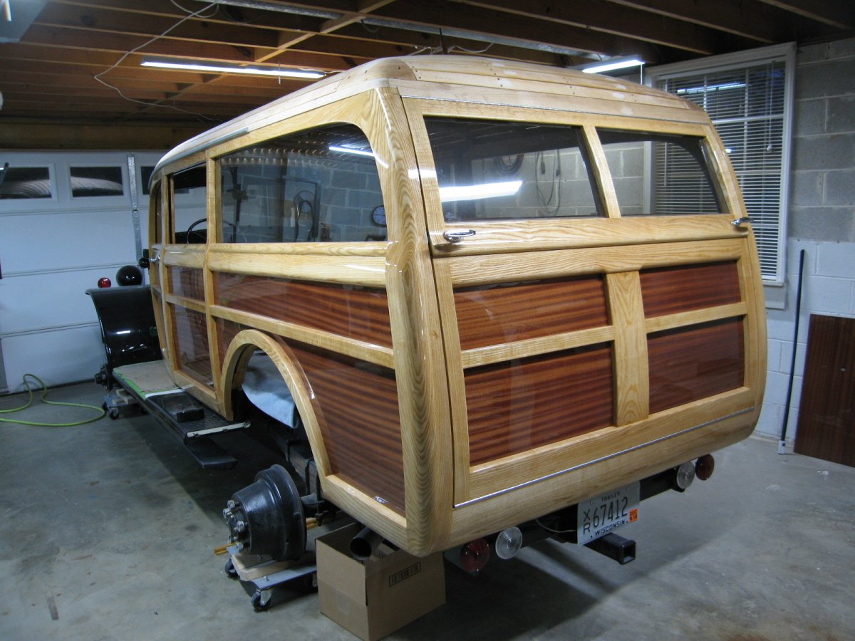

    Getting very close to the end, still have one window to install and a few interior panels. Have to get the top upholstered and reinstall the rear fenders. The list is getting shorter. I ran across this old picture tonight and thought it made for a good contrast. My opinion is obviously biased, but I like the new one better. IMG_3785.JPG IMG_4705.JPG

  9. plywoody47
    Joined: Jan 23, 2007
    Posts: 3
    plywoody47
    Looking great.
    If you don’t mind, could you explain the rear floor construction? Specifically the “spacers” used between the planks in the finished images.
    I’m rebuilding a 47 Plymouth woodie, and missing any remnants of the rear floor, so looking for good references and any guidance there.
    Thanks
    Mike
  10. mamllc
    Joined: Aug 26, 2008
    Posts: 148
    mamllc
    Between the planks is a caulk that I got from Mcmaster Carr, it had the physical properties I wanted and a color that was good enough. The planks are fully finished when installed. I tape off the top edge, put enough caulk on the edge of the board that when it is installed it completely fills the gap and bulges out the top enough to trowel off with a spoon. Then peel the tape up. Some manufacturers have used tongue & groove, or lap joints, have also seen them done with a butt joint like I did. The reason I went this way was mainly to avoid wood on wood contact because the owner wants to keep squeaking to a minimum. I did other things elsewhere on the body to help isolate wood parts, and now that I have driven it, it seems to have worked. It's not new car quiet, but for an all wood body it's not bad.
    Finished pictures to come soon.
