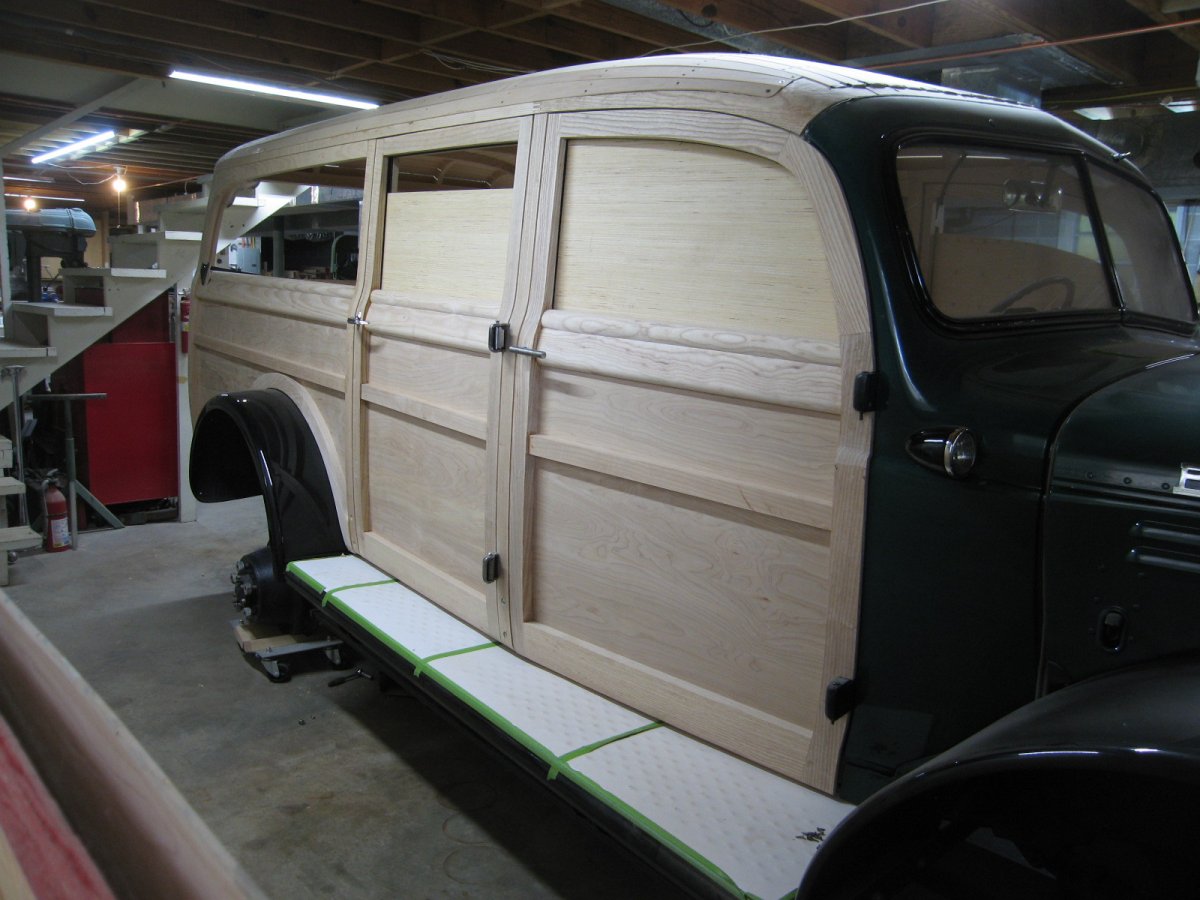

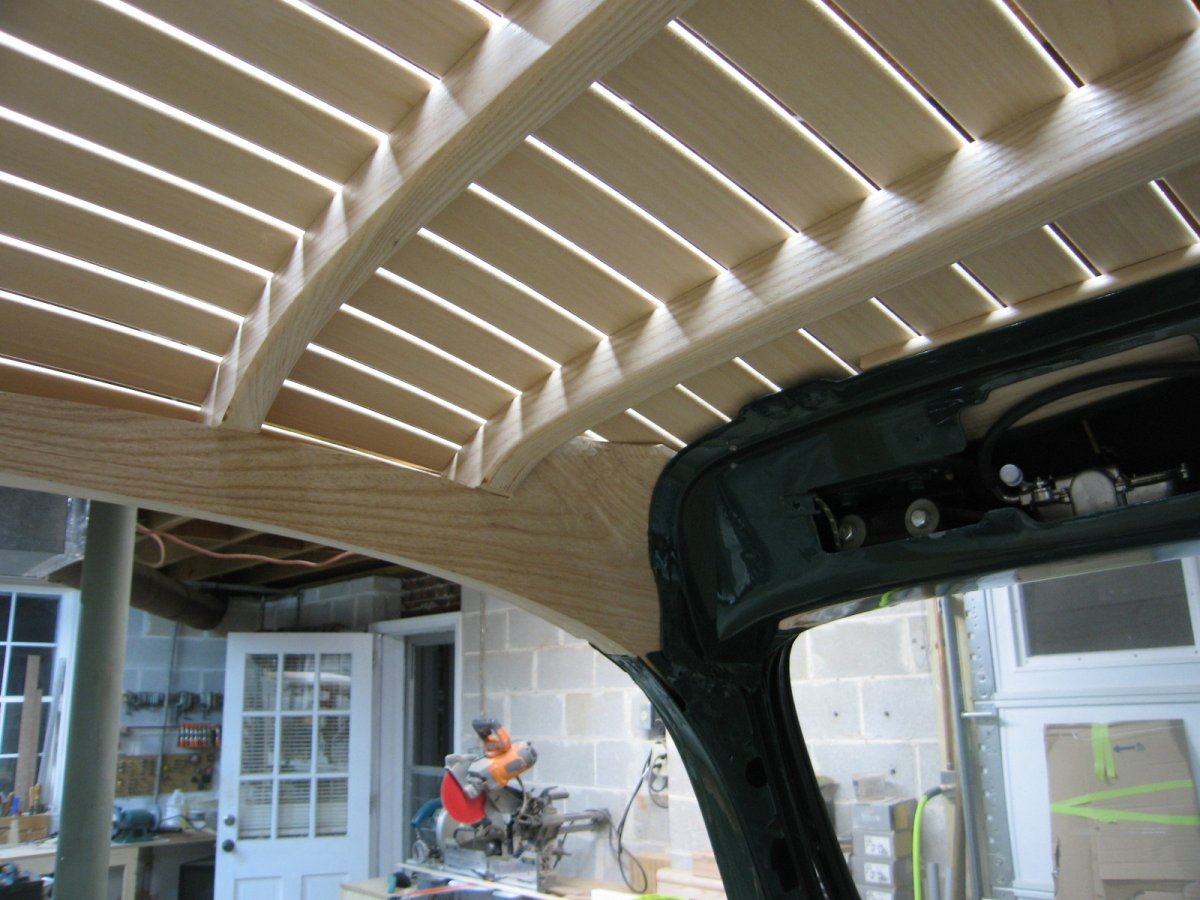

    I started this project about 6 months ago so the first post will show a lot more progress than later ones. The truck is a 1950 Power Wagon, the wood body that was on the truck when I got it was built by someone who either didn't have the original wood to copy or didn't try. The original plan was to build an exact copy of an original, but as the owner intends to use it, some changes were made to improve functionality. Styling will be mostly Campbell. It is a three door style with the spare tire on the running board behind the drivers door. I am working on the spare tire mount and finishing the opposite door now. After that will be the tailgate, trim, veneer for all the panels, a few thousand odd details then blow it all apart and start making it shiny. IMG_4041.JPG IMG_4058.JPG IMG_4081.JPG IMG_4103.JPG IMG_4121.JPG IMG_4129.JPG IMG_4131.JPG IMG_4138.JPG IMG_4142.JPG IMG_4150.JPG IMG_4156.JPG

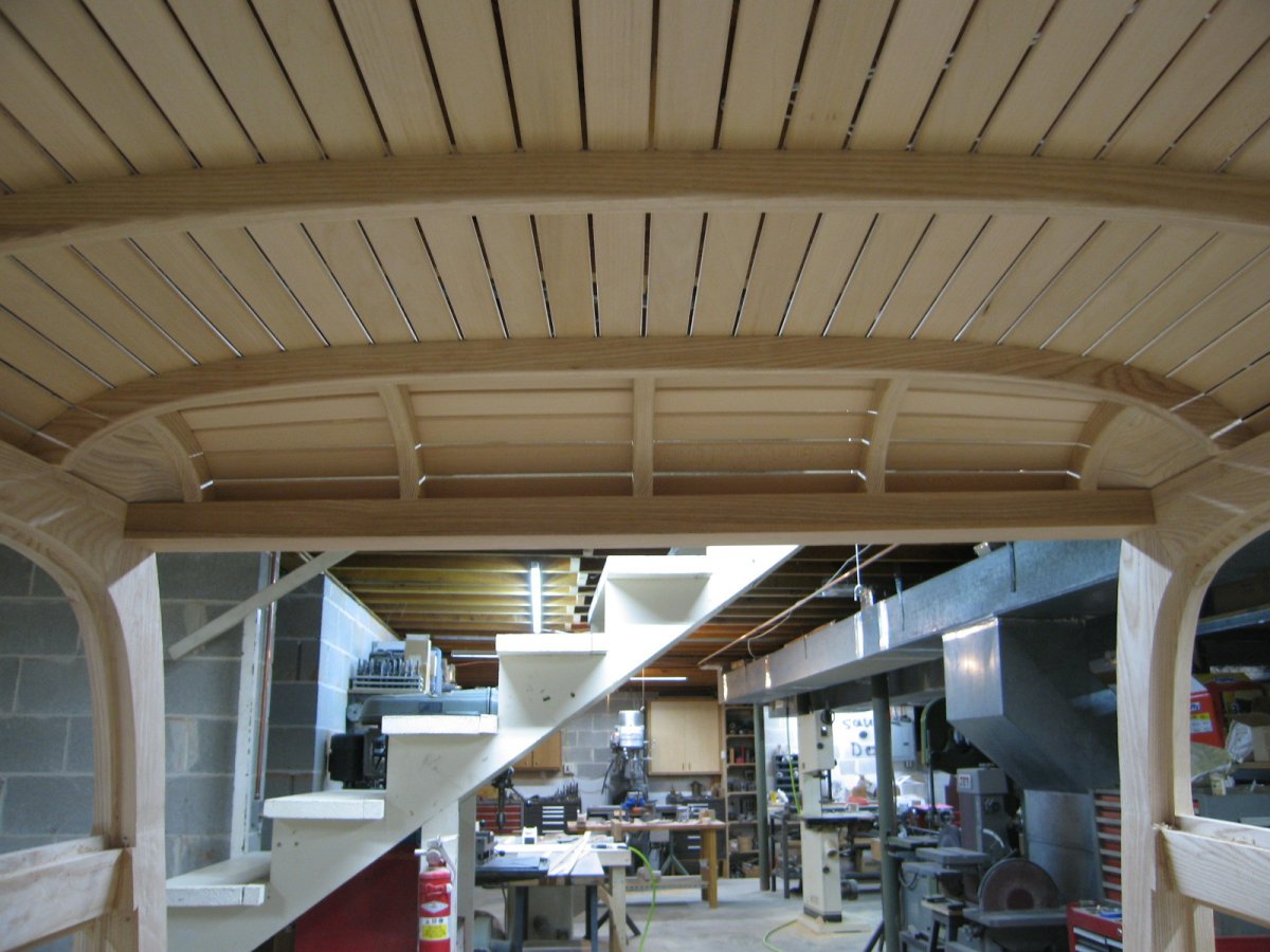

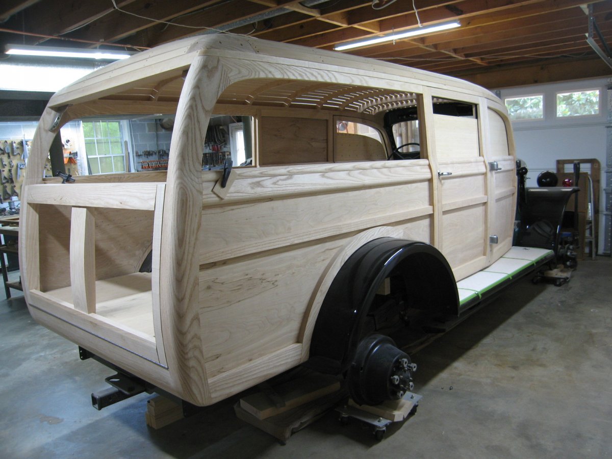

    Not sure how many pictures will fit in one post but a dozen seemed like a nice round number. The roof is mostly original except that I decided to dress the corners up some. The original back corner posts had the same shape on the back as the new ones but the outside was straight instead of having the same profile as the other pillars. I decided to shape the outside of the rear post to match the front pillars. Tall people will be driving it so the front seat will be moved back along with the B pillar to make a bigger door and better access. The back door will be s IMG_4194.JPG IMG_4222.JPG IMG_4223.JPG IMG_4224.JPG IMG_4225.JPG IMG_4226.JPG IMG_4244.JPG IMG_4246.JPG IMG_4257.JPG IMG_4296.JPG IMG_4294.JPG IMG_4298.JPG tretched some too in order to keep things proportional.

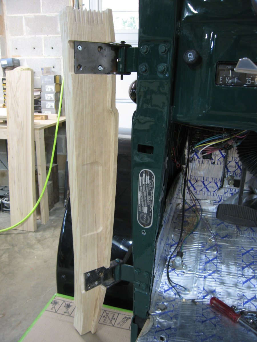

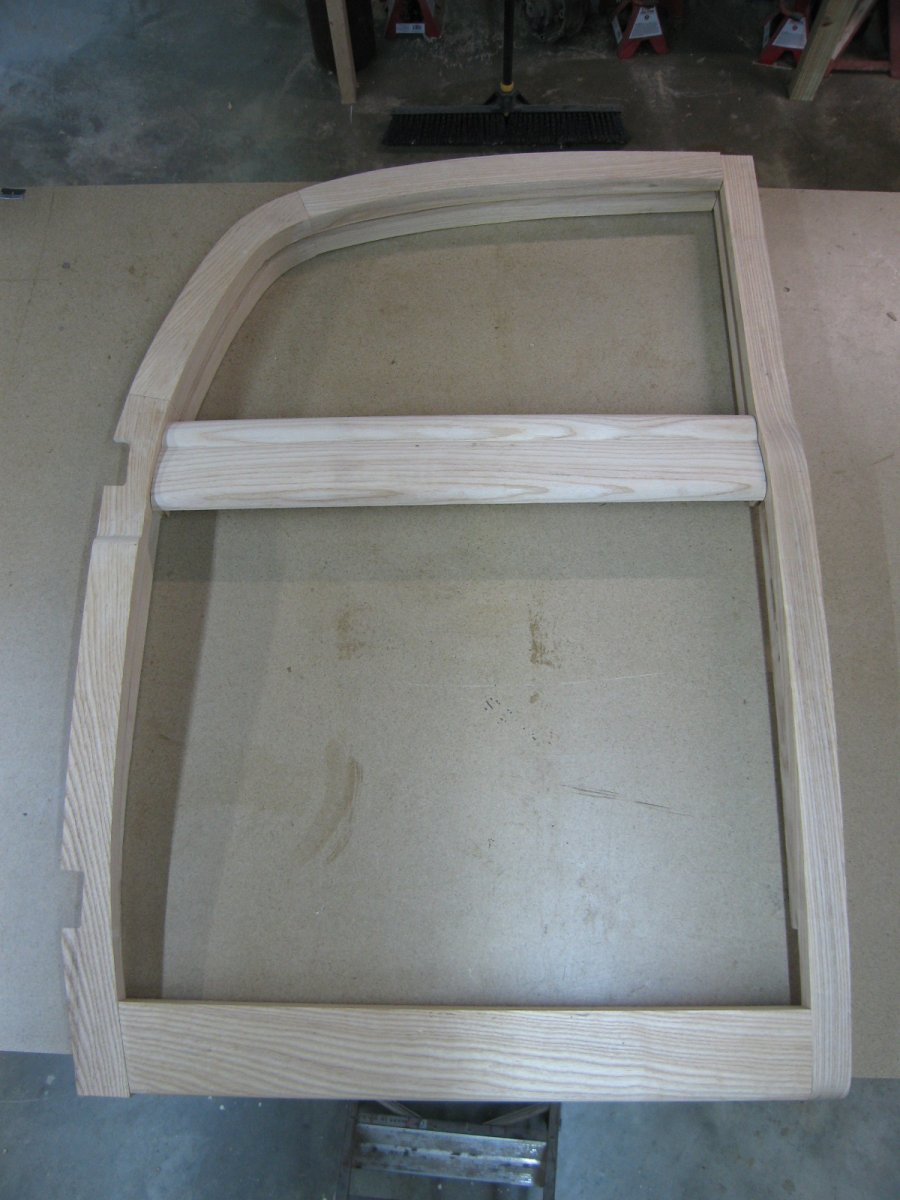

    Using bear claw door latches but staying with roll up windows. One piece glass in the front doors, originals had a fixed wing window. Quarter panels will get solid glass instead of sliders. It has A/C now and the four front windows should provide enough ventilation. IMG_4353.JPG IMG_4354.JPG IMG_4356.JPG IMG_4358.JPG IMG_4384.JPG IMG_4381.JPG

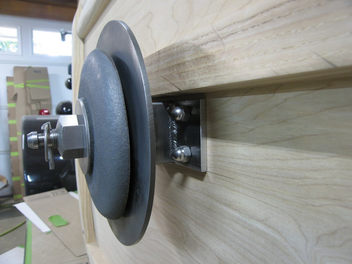

    The doors are all done, got the spart tire mount finished and am on to the tailgate. IMG_4405.JPG IMG_4407.JPG IMG_4408.JPG IMG_4409.JPG IMG_4410.JPG IMG_4411.JPG IMG_4412.JPG IMG_4435.JPG IMG_4434.JPG
