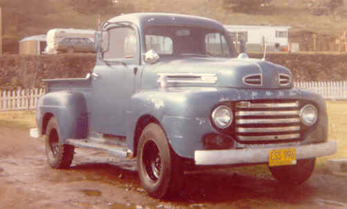

  7. The mercs used a dana 44. I had some 1st person dealings with one under my trusty ol 49 ford pickup with a 4.27 ratio. I broke it twice. Once thought the cast iron cruiso was in reverse but it took so long to go into gear and I was impatient....gassed it just as it went into reverse and broke an axle shaft.....did the same thing later and something in the punkin broke...all my fault. Be sane with it and it'll live.
