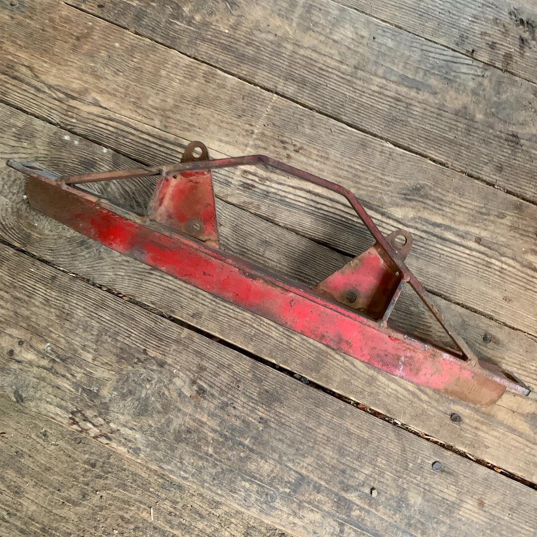

Picked up a Hurst engine mount for the Y-Block, this should make it easy to drop the engine in, I hope. Sent from my iPad using Bacon

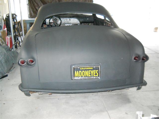

'51 that had years back - some one chopped it before I got it - pic is just something to stare/compare as to what you are trying to do
Jalopy Joker, Thanks for the pics, and I definitely need to get some skirts! Sent from my iPad using H.A.M.B.
This is going to be a pretty exciting update! Not really, but I did get one more piece that I needed to put the Y-Block in. Sent from my rotary phone using SPAM
