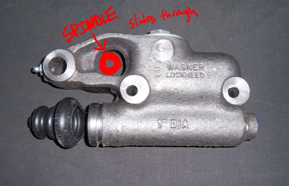

    Seeking helpful advice so I don't spend the entire weekend doing a 2-3 hour job.
    1) Removing the master cylinder from the spindle that holds it in place between the frame and clutch assembly.
    It looks as though I have to disassemble the clutch linkages and slide everything off that stupid spindle that holds the brake/clutch pedals in position. Any tips???
    2) I have a rebuild kit and hope the M/C is not too pitted. Any advice on honing the cylinder and the rest of the rebuild?
    Looking to spend a cold day on my back this saturday, many thanks.

  4. When I did my 50 I had to take all the clutch linkage out like you said, it was not fun at all and required two people to put it back together. One to hold the pedals in place inside the car while the other layed underneith and tryed to get it all back together. I rebuilt my old M/C, works fine.

    I was able to remove the M/C for the car, BUT, the rebuild might not be worth the time. I cannot get the "adapter" piece to unscrew in order to remove the guts and hone the inside (see photo). I have the m/c soaking in some solvant and will give it one last try.

    Rather than a step by step, I will give some tips to those who google this in the future:
    First, buy some liquid wrench for those "fun" nuts and bolts, apply and wait for awhile, I have become a believer.
    MASTER CYLINDER:
    1) Yes, you do have to remove (slide out) the whole friggen clutch spindle assembly, accept it. Don't forget to remove the outer bolt next to the door that holds the assembly in place.
    2) Don't be too afraid to lightly move or bend the metal brake lines to replace the stoplight switch on the m/c and the same goes for the rear wheel cylinders.
    3) If the rubber replacement boot is not the accordion style. It won't seal as nice. If you get the cup style, simply remove the largest accordion ring and slide inside the cup to provide a better seal around the plunger.
    4) Make sure the brake pedal stop is on the bottom of the firewall before installing, and not up in the cabin.

    I'm currently replacing my master cylinder (49 Ford), everything loosened up easy enough, but the clutch shaft that runs through the top of the master cylinder won't come out. The shaft is to long and stops when it hits the trans. It's very close, but i've got it as far as it goes. Anyone have any ideas?
  25. mrkling
    Joined: Oct 30, 2009
    Posts: 142
    mrkling
    Gave up for today, losely re-assembled in hopes someone has a good tip. I believe the correct name is the clutch release equalizer shaft. I'm sure anyone who has changed the M/C knows exactly what I'm talking about.
  26. olosipu
    Joined: Apr 2, 2009
    Posts: 25
    olosipu
    It MUST come down and out on an angle. Make sure the sleeve that the rod goes through is angled down as well. It is close, but it will come out. Good luck.
