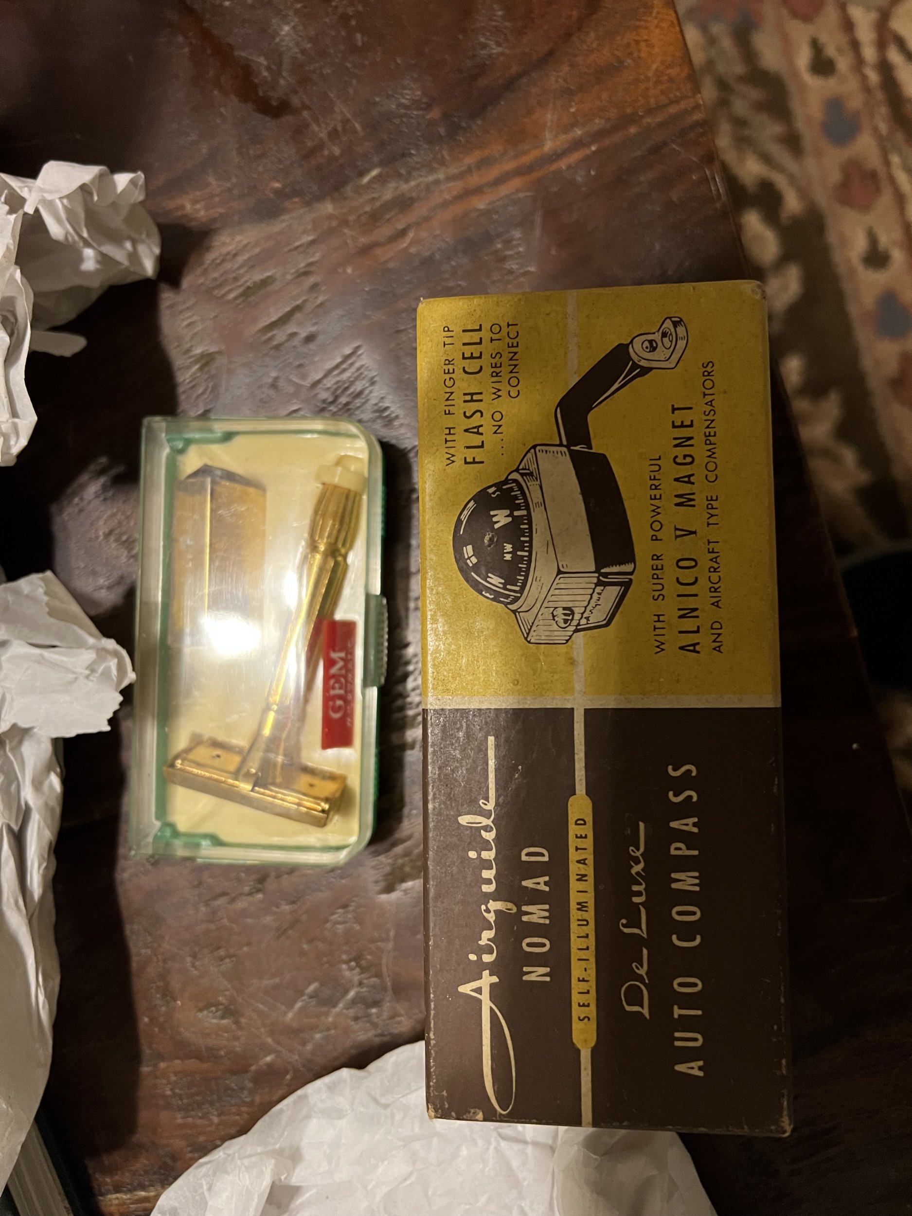

  1. So while on vacation I ran across this 1950’s dash compass. I took a chance on it as it looks like some of the water leaked out. Does anyone know if there is a way to top it off or refill it?

  9. This one still has fluid in it but enough has leaked out so the compass sticks in one position until you jar it loose to float again.
    I will check out Aircraft Spruce or a marine supply store.
    thanks.
  10. Here is a pic of the compass finally.
