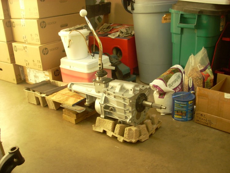

    I've got a T5 hybrid for my coupe. It has a V8 Camaro/Firebird gearbox and an S10 tailshaft, housing, top, and rails.
    The t5 transmission from the V8 Camaro/Firebird is exactly 3.5" longer than a Muncie or a Saginaw, and uses the same yoke on the driveshaft. It will fit any GM bellhousing from 1955 up, use the the same clutch fork and throw-out bearing, just change to a 26 spline clutch disc.
    The speedometer gear must be relocated on the Camaro tailshaft to line up with the speedometer connnection on the s10 tailshaft housing. If I remember correctly, the Camaro tailshaft is available with either a .073:1 or a 0.063:1 overdrive ratio in 5th gear. My t5 has both an s10 tailshaft and s10 tailshaft housing so no jury rigging of the speedometer gear was required and I ended up with a 0.68:1 overdrive ratio for 5th gear.
    Here's a good tech: T5 tailshaft swap for dummies, with pictures<!-- / message --><!-- sig -->
