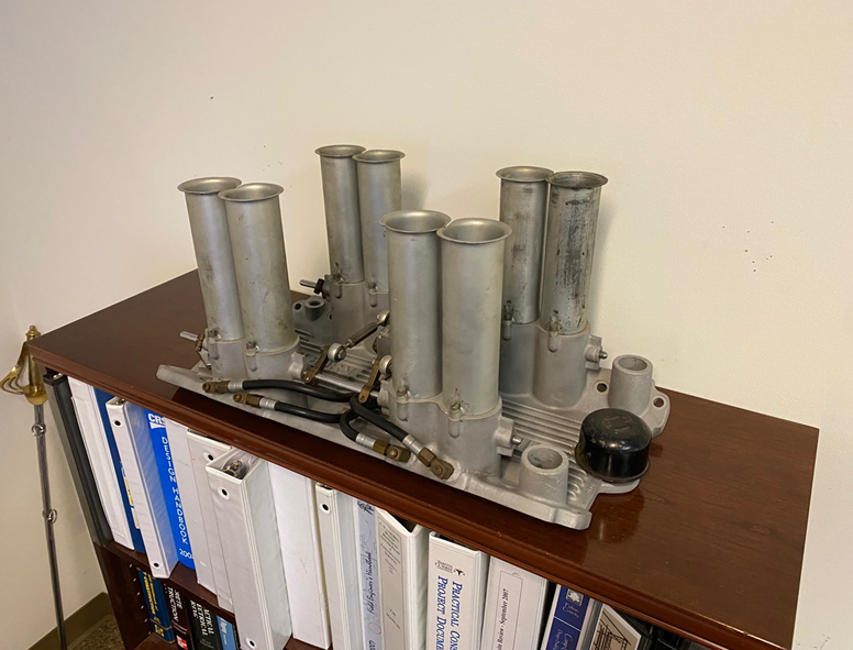

  26. This thread is a blast from the past - Just so happens I've recently brought my Weiand 4x2 with some nice Stromberg 97 carbs into my office to enjoy. My Dad found this set up down in Savannah and I was able to buy it. May have never been run. The linkage needs to be sorted, but shouldn't be a big deal. I've still got an offy 4x2 intake hanging on the wall if anyone needs one. I'll probably never try to run it. That Set up Hrm2k had was sano looking for sure.
    I also brought in my old Hilborn Injection Unit - this thing has been in the basement for years - Might as well get to look at it everyday! This one I would like to run.
  27. Long time no-see, man- hope all is well with you!!!

  28. hrm2k
    Joined: Oct 2, 2007
    Posts: 4,877
    hrm2k
    Thanks for the compliment !! I have been looking for a Weiand like that but I am usually a day short on my timing
    lothiandon1940 and Tudor like this.
