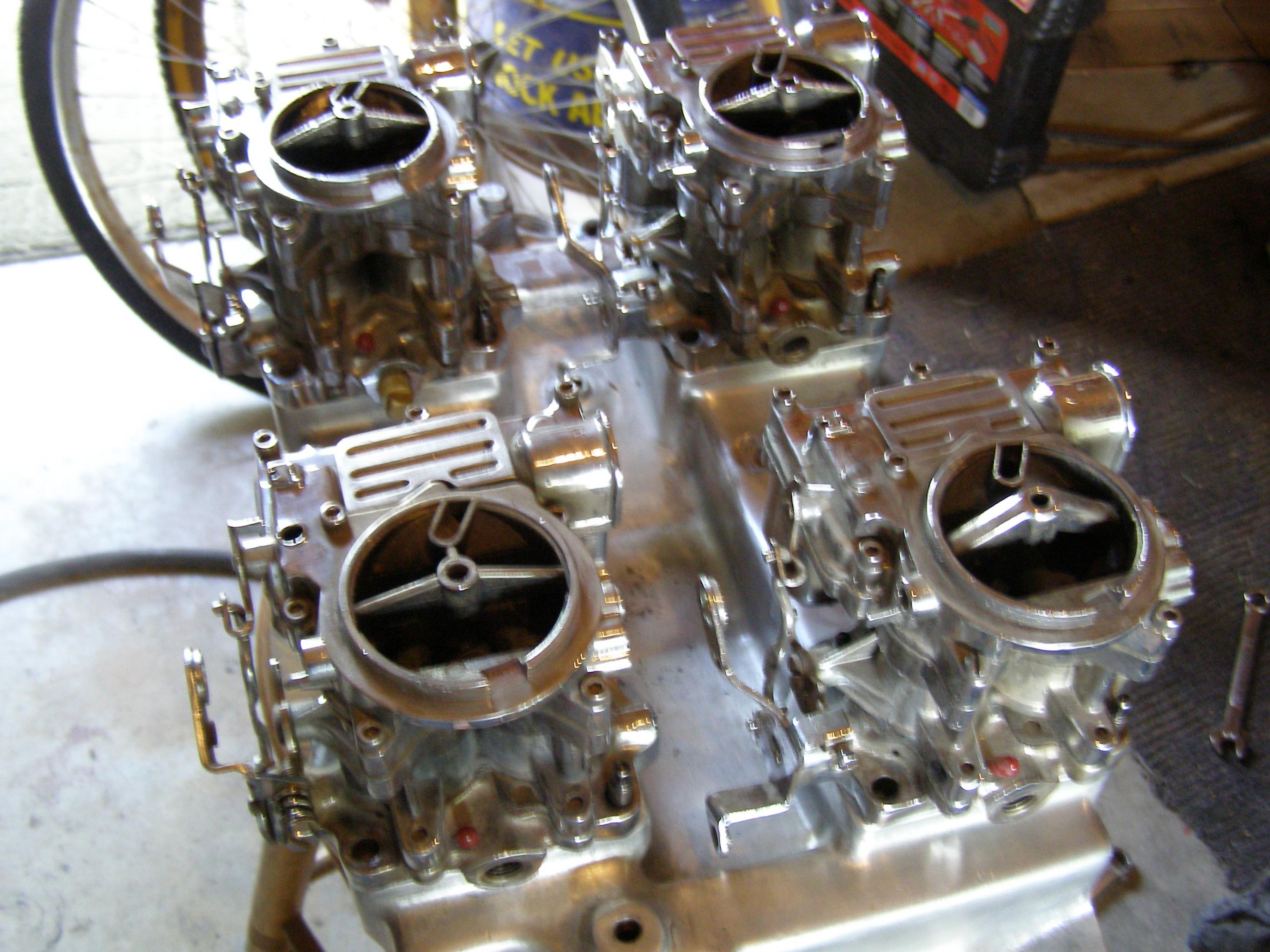

    What can I expect using 4 rochester small base 2g's on an offy 4x2 manifold? My engine is a 383 stroker, 9.7 compression, ported 291 camel humps with 2.02 valves and a comp xe268 cam. It is going into a T roadster with a 2200 stall and 3.50 gears. From your experience is the manifold/carb combo going to have any street manors at all? I love the way it looks with the polished manifold and the chromed carbs, but I don't want to fight it all the time.:) Let me know what you think. Thanks in Advance!

    That setup is being run, as we speak, on small, more docial engines with great results. Just be sure they are synched to run all together because with that Offy you can't run progressive or you will take a chance of leaning out a cylinder or 2.

    It is possible you will have more problems with the chrome on the carbs than the 4x2 set-up.
    If the chromer did not understand chroming zinc alloy, there may be metal slumpage. Have had LOTS of chromed carbs sent to us to rebuild because they didn't perform correctly. Open them up and metal slumpage turned them into junk. All you can do is take pictures and send the pictures and the carbs back to the owner.
    Not saying don't chrome them, but discuss it with the chromer to make certain he/she understands chroming zinc alloy. It CAN be done.
    Eventually, chrome will start to flake. Flakes will get in the small passageways.
    There are other ways to make the carbs look nice.
