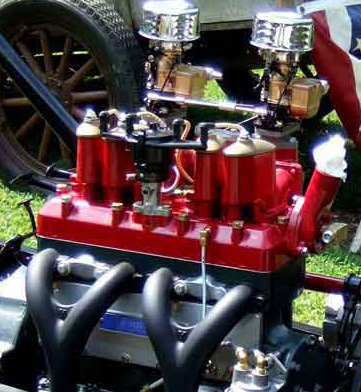

    Stole these from the secretsofspeed website

    The Roof may (?) be better as it is a 4-port, but has a funky combustion chamber. A 4-port Riley would be best if you could find one.
