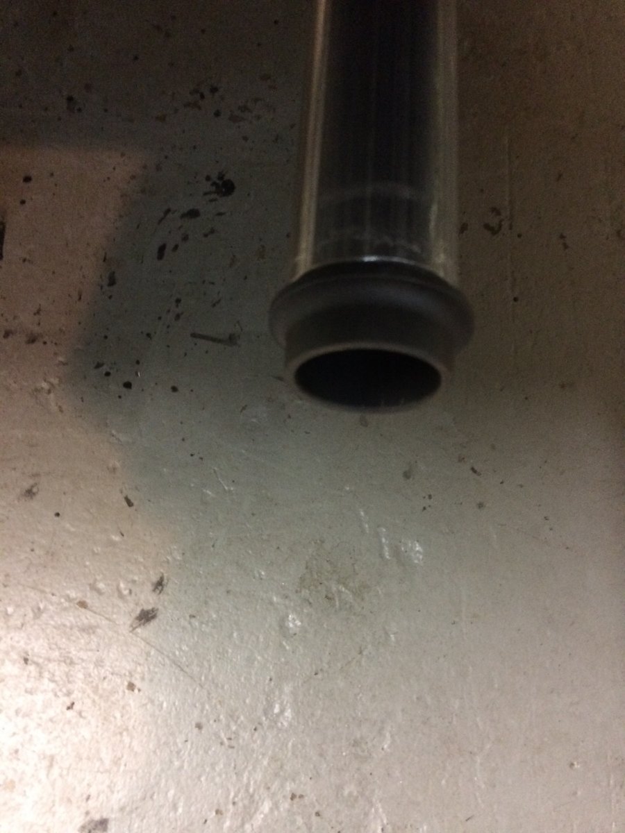

    Fired up the Car and the Exhaust sounds great! Not the typical "rappin' the pipes" sound you associate with a Straight 6, but a deep, throaty bark.
    I did end up installing the Mufflers with the exhaust flowing over the rounded end of the dimples inside instead of at the open end. There was a significant difference in sound depending upon which direction we had them oriented.
    New Billet Tips installed too!

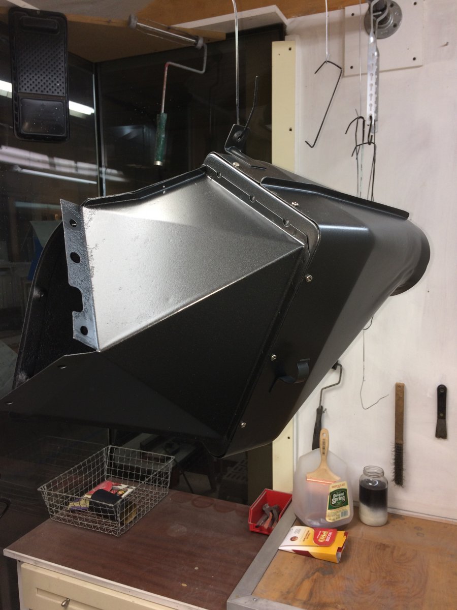

    Heater is in!
    The Deluxe Model came with a Harrison Fresh Air Heater. Which is basically a Box connected to the Fresh Air Duct in the engine bay, with the heater Core inside. Well this one leaked and there are no replacements. So I used a modern GM Truck Core and modified the Box.
    The original Core had the Supply and Return on opposite sides and ends. They are side by side on the new Core, so I drilled 2-new holes in the lower back of the Box. Laying a blanket of 1/4" Closed Cell Foam inside the Box for the Core to sit on, with X cuts in line with the Drilled Holes, the Supply and Return pushes through and creates a self seal and covers the remainder of the original offset Hole shown in the picture.
    The Core is thinner than the original, so I used foam bucks to keep it secure. A plug will go in the original lower front Hole. Sandblasted and painted with Satin Hammered Black rattle can, the assembly was reinstalled

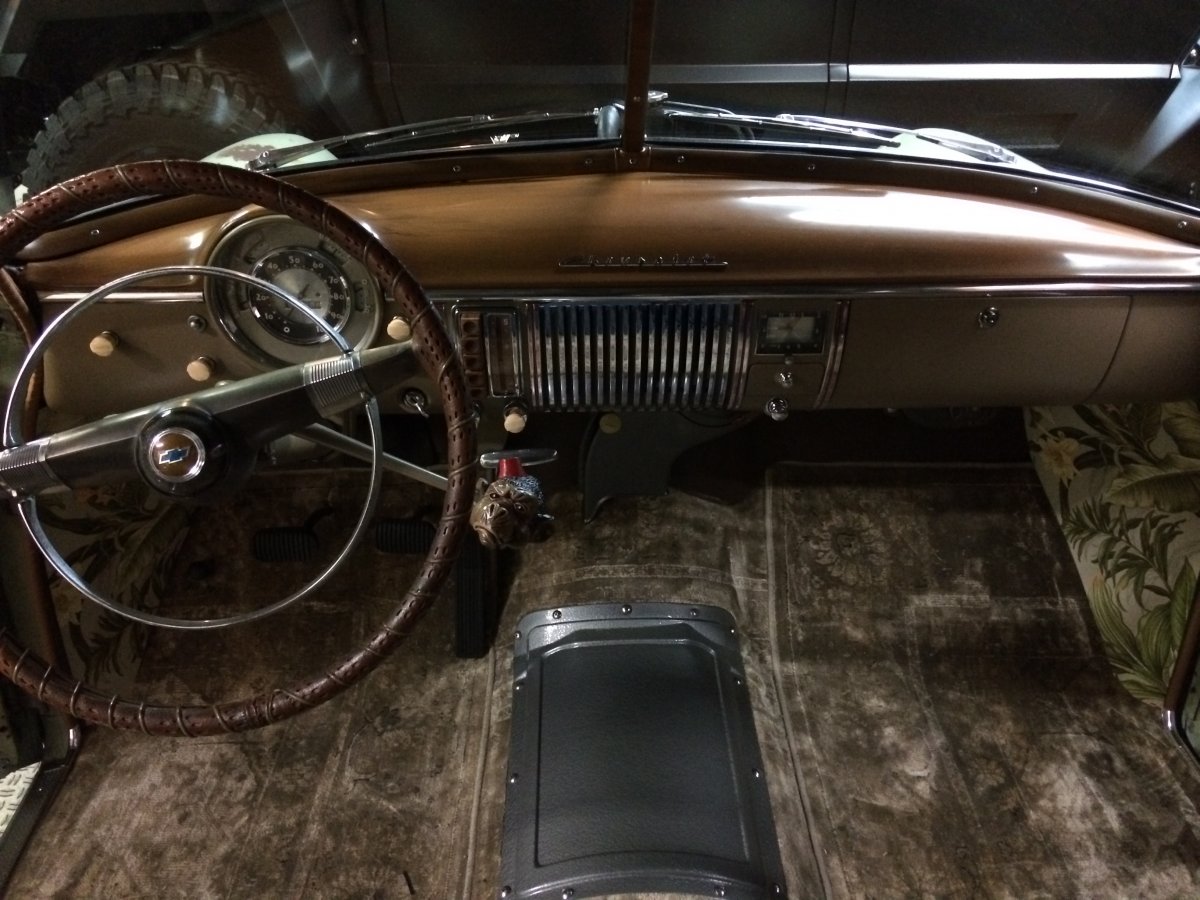

    The Transmission Access Cover was sandblasted and painted with grey Hammered Finish rattle can, and reinstalled on top of the carpet for easier access in the future. Besides, I think the Interior needed some of the Industrial look that the Engine Bay has developed.

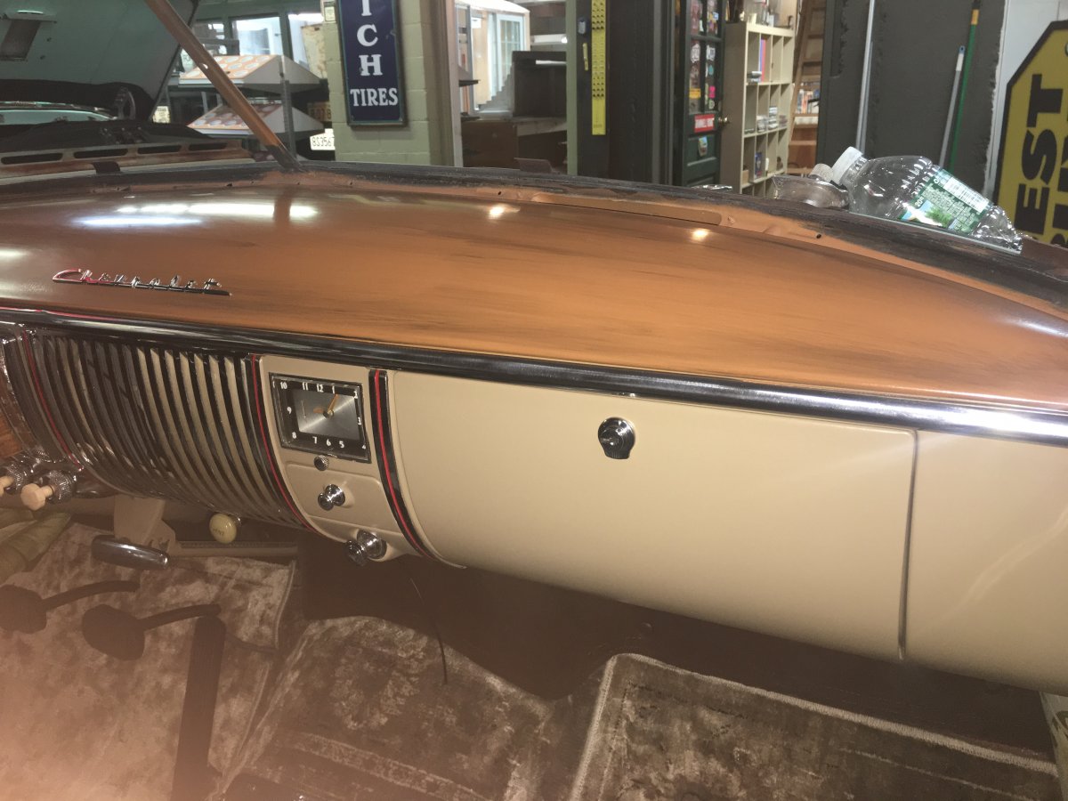

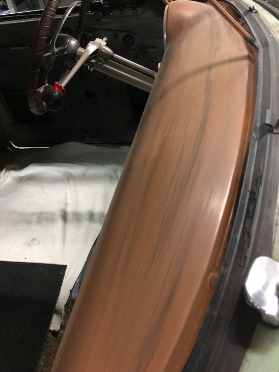

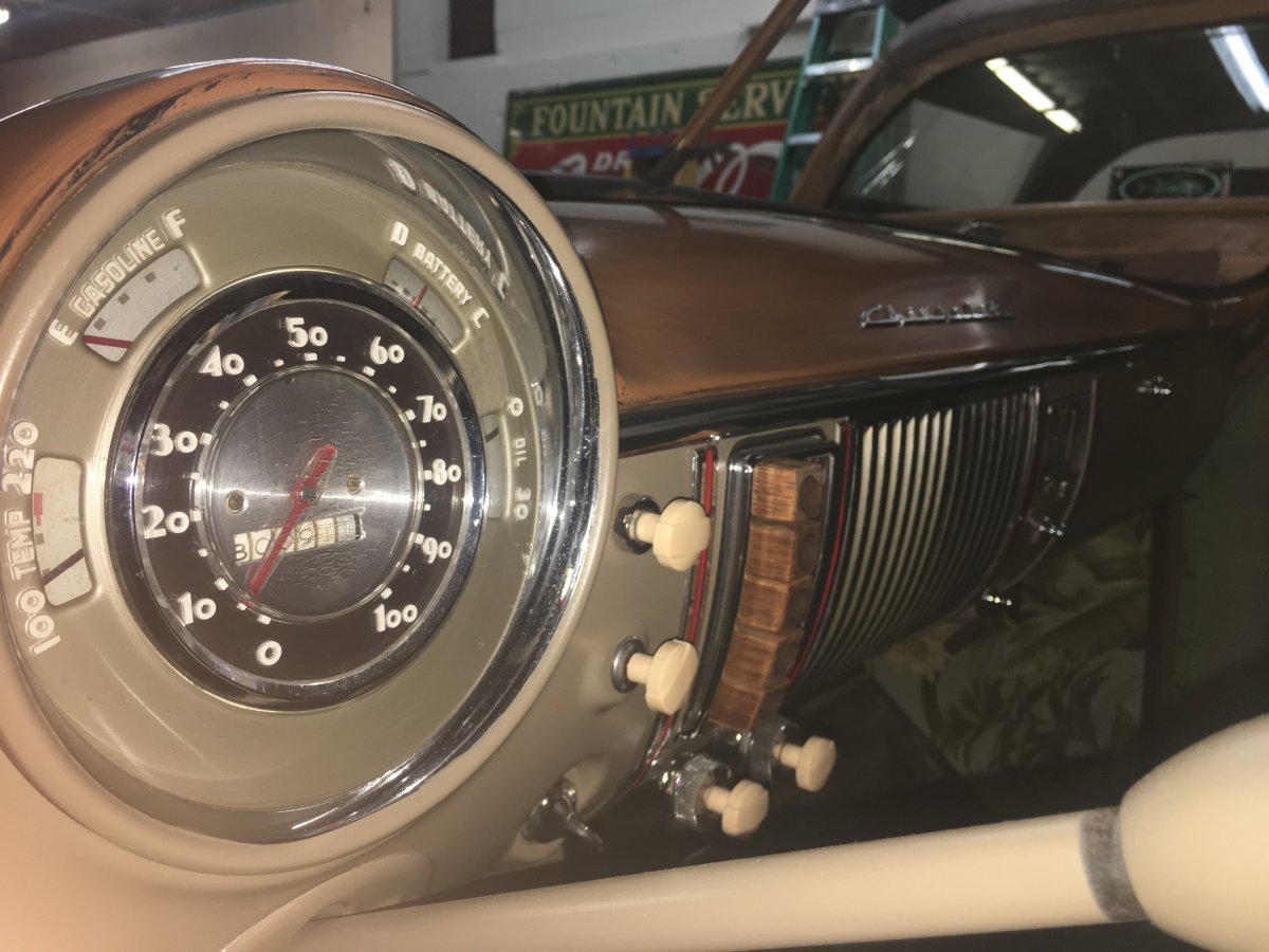

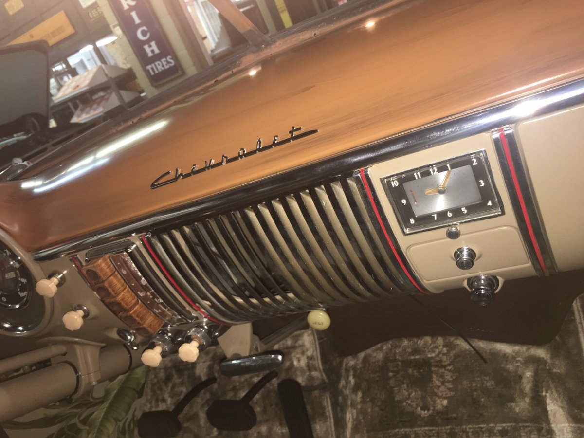

    Wood Grain Dash.
    Same technique as the other Trim pieces - base coat of rattle can Warm Caramel, with a Black wiped topcoat.
    Definitely easier with the windshield out of the car!

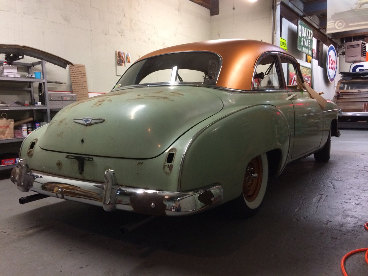

    A91856DD-2595-45F1-8DE4-1FE346C6682E.jpeg 297C72EF-FCB6-406C-8BC8-781142269549.jpeg 8EFB65CE-1233-4BA3-A36D-DE4F3104E514.jpeg While I’m down in Florida for Turkey Run, my Brother finished the Dash!
    Good Job! Merry Christmas to me!
    We’ll install the Windshield and Visor next week when I return. Then wrap up the faux patina paint blending I had to do where I rust protected under the roof moldings, and it encroached into the body color.

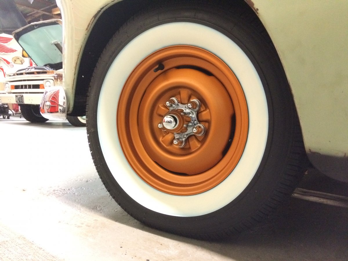

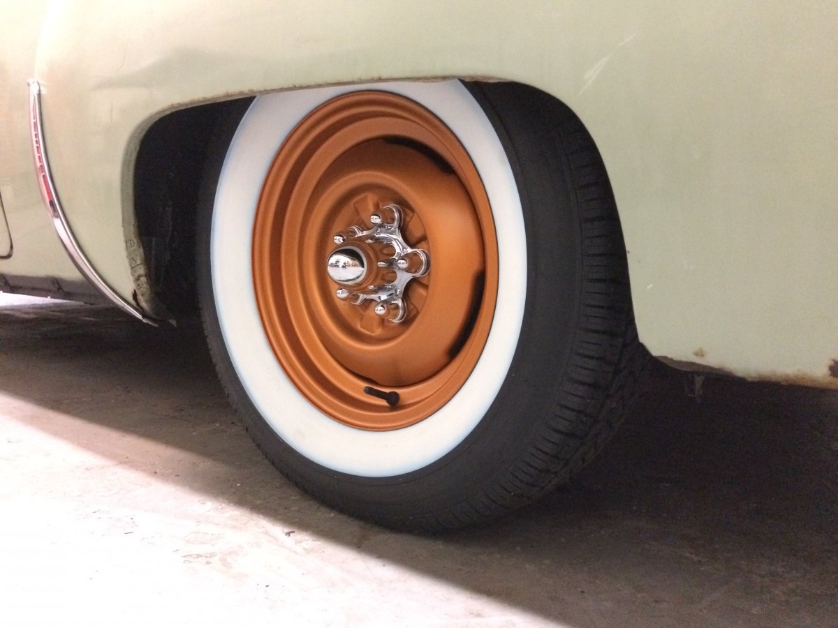

    For those who have asked, 215/75/15 Cokers on the Stock Rims.

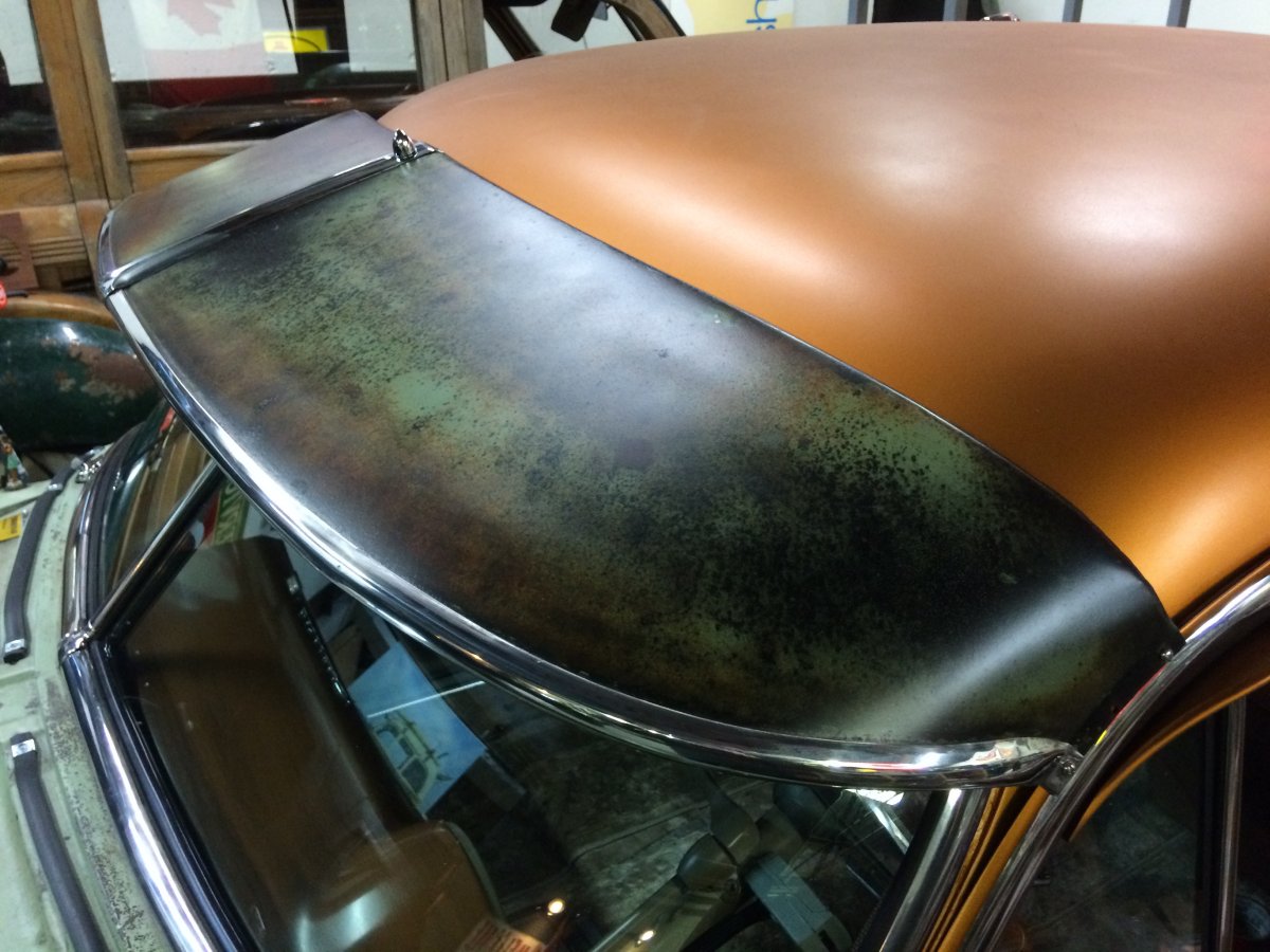

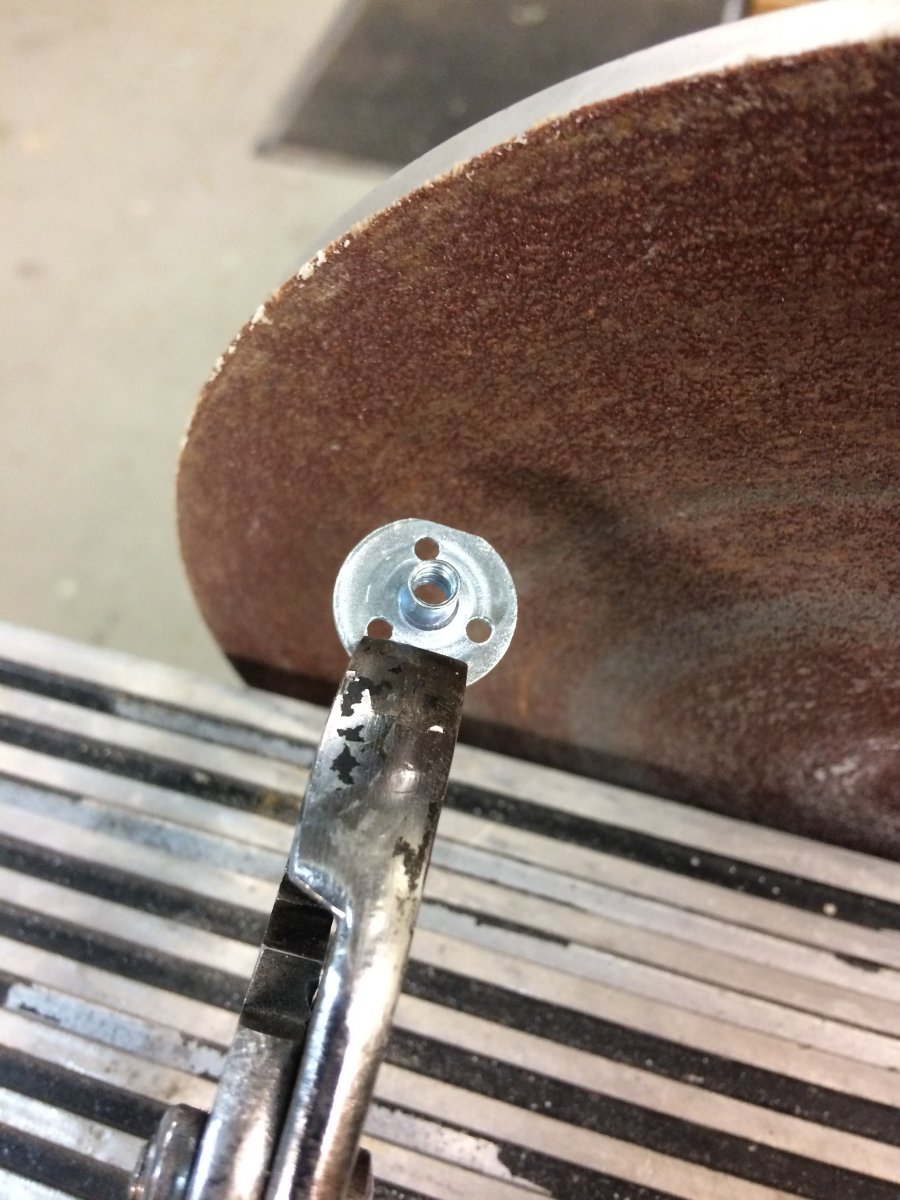

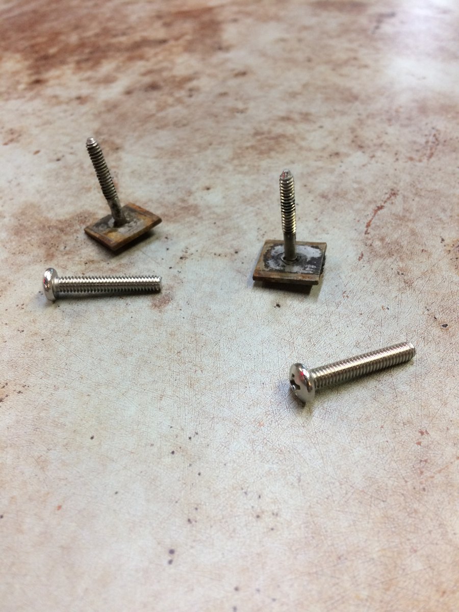

    The Windshield is in, and the Visor is back on.
    The repop Glass fit great but the Center Bar Screws were an inch short, with the new Windshield Weatherstrip. Typically not a problem with newer models that had threaded studs on the exterior trim - simply use a longer screw to attach it.
    However, I couldn’t find long enough sex bolts, so I used these round threaded Tabs, flattened opposite sides so they wouldn’t spin in the channel of the trim, and used traditional screws from the inside.

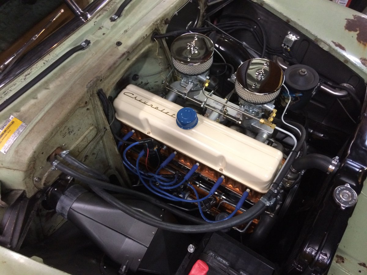

    Engine Bay Pics. Thought I'd get a few Shots before the Hood goes back on.

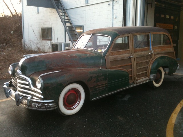

    Is the next build that woody I believe I see in one of the photos. I think you would kill it with your style of building.
    Bowtie Coupe likes this.
  22. FrankenRodz
    Joined: Dec 20, 2007
    Posts: 892
    FrankenRodz
    Thanks. That's a '47 Pontiac Woody which was in pristine condition when put in a garage some years ago. The story goes, the garage roof failed and the weather took a toll on the wood. It's all there, but having done another Woody, it will entail disassembly of most of the wood. We actually had mocked-up 1-side with blue painter's tape to turn it in to a 2-door! But, nobody has the $ to fund the Build, so it's FOR SALE. 100% Rot-Free Sheetmetal, but still a lot of work.

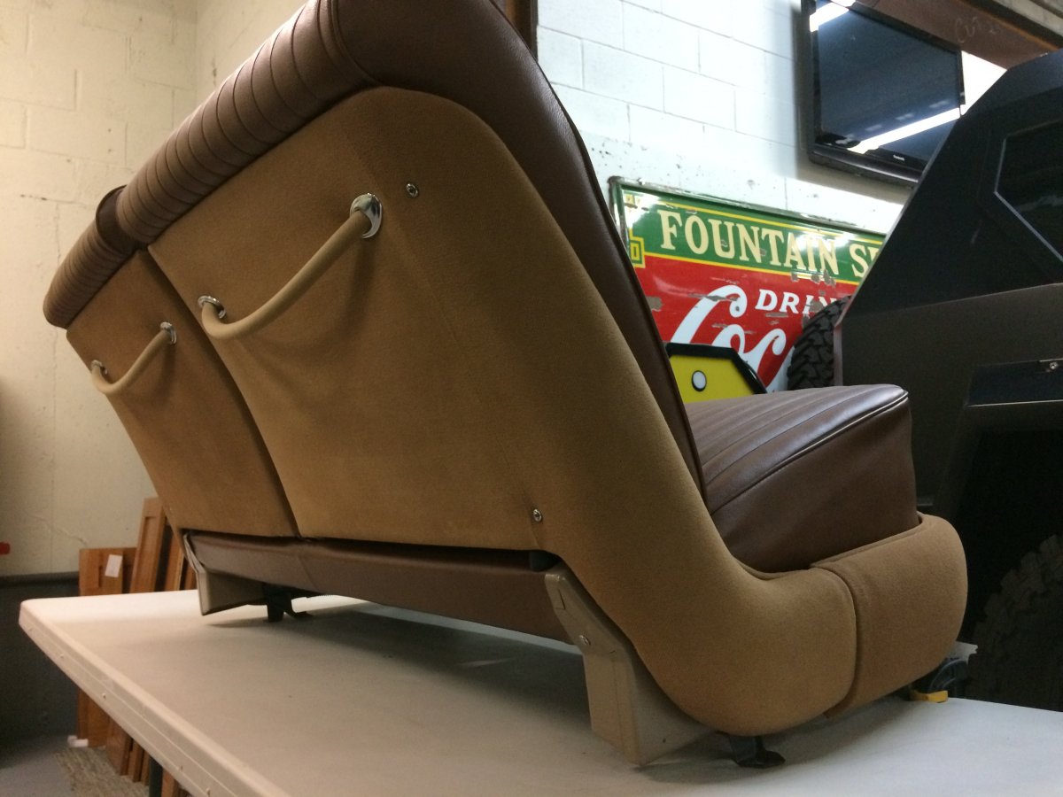

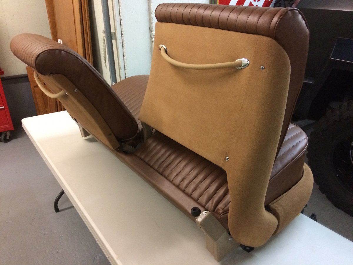

    8987C562-6DEF-4673-B25F-C0DDE9C710FE.jpeg D5FFEFCB-36C8-4A58-8D77-D0A3DA98F9D0.jpeg 7DCA11FB-276E-4993-8619-A08E94E8D752.jpeg 546562BF-05EF-451E-ADB9-4B4828CB1F50.jpeg E46C1541-FBC2-4A1D-B8C2-9F5B88D43454.jpeg 094F5C58-DEB9-4D0E-9906-F4615CF990CD.jpeg Front Seat is ready to go in, but the Car is so crambed-in with vehicles for Winter storage I may not be able to get the door open wide enough... so here are some Pics in case it has to wait until Spring.

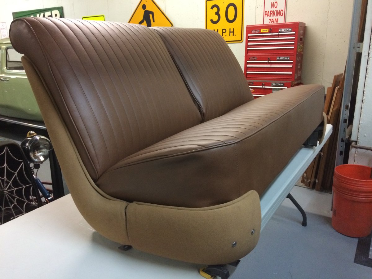

    Speaking of Spring. One Spring was broken so I cut/bent a length of copper line, slid it over each side of the break, and crimped it so it wouldn’t slide out.
    As for the Upholstery, I was able to save the brushed cotton Backs and Aprons. After a light cleaning, I sprayed them with Fabric Dye to even-out the faded color.

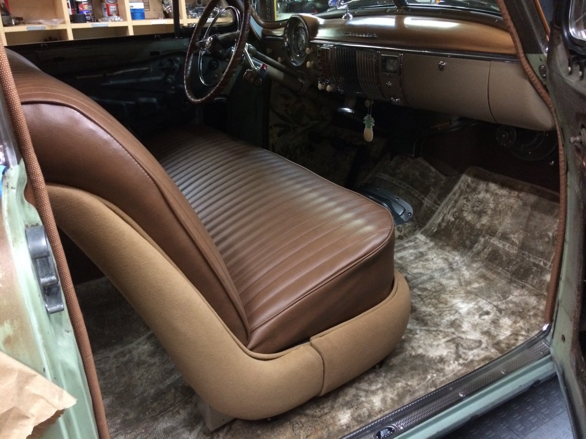

    We did get the Front Seat installed yesterday, which was quite a chore, given that we couldn't open the car doors fully.
    All that's left for the Interior are the Door Panels, Window Trims, and Arm Rests, but those will have to wait for the body to be sanded and clear-coated. (I want to pull the Exterior Trim to do the body, and that bolts from inside).
