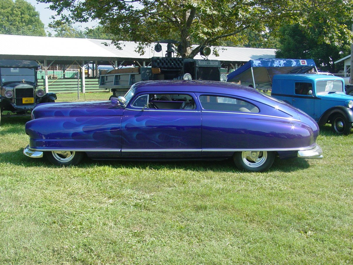

    Very nice, top shelf workmanship, thats a fact! You'd like Rubadub, its a Nash, same DSC00330.JPG but different. I can tell you for a fact Rubadub is a whore to change a tire, watch yourself. They're built about the same.

  3. Believe it or not @oj I knew the previous owner of Rubadub.
