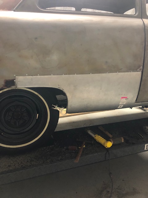

    IMG_1394.jpg IMG_1417.jpg IMG_1342.jpg IMG_1406.jpg IMG_1344.jpg As promised.
    Progress has been very slow. Floors were mostly fiberglass repaired. Also learned that bondo over spray foam is a option for some people. I think I have gone way past my skill level on this project, but here we go. Here are a few pics and I was just playing around and had the flathead purring like a kitten.

    The pop rivets are just temporary, right?

    Screws, weld a little, remove a screw, weld a little more. I'm sure there is a better way but it worked.

    Screws not too far removed from Clecos if you think about it. Best thing about rivets is zipping one off and plug welding the hole, move to another one, repeat. There's more than one or even a dozen ways to get it done! I'm amazed at the welding done by the factory on these cars. Sloppy but they work.

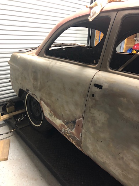

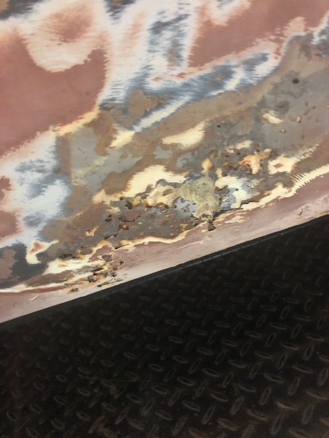

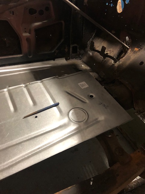

    CB7DA847-2FC6-42C6-B781-B7AE0DA681ED.jpeg 6F67B387-F9D8-47FD-A1FC-32F66B80E4B7.jpeg 69C5B28F-1756-4196-95DB-A25EC6D4DB8B.jpeg 6CF6A262-2198-4290-A315-865653B8DE93.jpeg
    The repairs on drivers side went well—- I think I’m getting this shit. Now I have a few questions. Started cutting out the trunk and removing all the factory tar. I have new metal from EMS, but wondering what to weld to. I’m sure you weld to the fender wells and the metal above the rear end. What about the rear quarter panels on each side? Do you just use seam sealer ? Almost on the clean side of this project—-NOT

    Don't quote me but it seems like my 51 had trunk floor extensions that were not welded to the quarters except for the very front and rear. They had a seal of some kind to let water and dirt drain away, but to be honest the car was 60 years old and God knows what previous owners had done to it.
