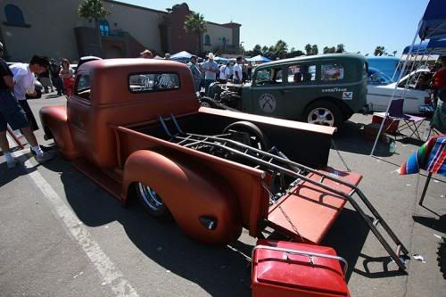

    I know I don't know any of you fuggers, but I found this thread trying to find a thread of guys competing with their welds. I love welding, and I didnt read the whole thread, and don't hate me for my constructive criticism, but for a first build, cool! But here's my 2cents on rear suspension, being that the front is pretty cut and dry, but rear is an art form. I think way too much was cut out of trunk for nothing. Could have been some trick sheetmetal work, and only enough to clear the tubes and stuff. I don't see pulse welding as an art form. Don't listen to anyone tell you that you need to tig weld a step notch. Waste of way too many hours. Maybe if body was off frame, and you had nothing better to do with your time. Mig weld with enough practice can come out perfect! I can make welds look pretty good with a mig! As for 4 link bars themselves, if making link setup from scratch, is worth tig welding, especially if using some good metal like chromoly or even DOM. The important thing here is function. If pinion angle stays true throughout suspesnion cycle, and bags don't bind up funny, youre in good shape. 1 thing I would have done different is, I would have used a tapered sleeve firestone bag in rear. about 1000 less pounds of capacity per bag = super smooth ride!!!! Like cantilever link setup when installed properly!!! Good luck! I like shoe boxes! I just finished linking one. I'm not tooooo fond of 2 links, but I just finished 2 linking one, barely touching trunk floor or notching, using a tapered sleeve bag cantileverd on lower link bar, and it lays low on 15's! barely any cutting, no under back seat alterations, perfect pinion angle! All about the trade secrets!!!! (Might not be the lowest shoebox in the world, but I didnt destroy the OG sheetmetal!!!) worth its weight in gold not cutting too much! = Satisfied customer!!!
    sorry bout all the pics. been dying to show off my work! lol

    These are all mig welds as well on a step notch and a lower link mount I made today for a 57 chevy pickup

    that bike rack looks cool as does the gold shoebox. nice work.
