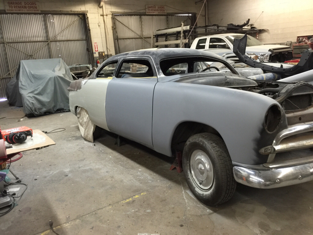

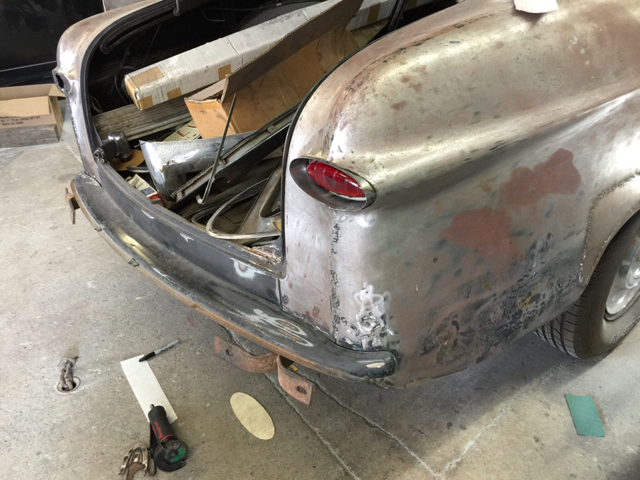

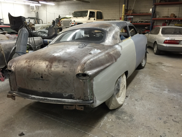

    Got some help today. I cut and welded in the frenched tail lights while my buddy Jeff spread the filler. We got most of the passenger side done with at least one coat of filler. Filled the door handle, antenna, and door lock holes. Have to do some repair work on the rockers and build a French antenna tube. Working on getting bearclaw latches in and have to buy poppers. I'll probably just run a mechanical release until I have the funds. Now I have a dilemma. The flatly is running a little rough. I am planning on having this as my daily. The cool factor with the flathead is through the roof but the reliability without a full rebuild is not really there. Neither are the funds to do it. So what do I do. I have always said I didn't want to swap in a sbc but the availability of parts and price is drawing me in. Is the 289 or 302 as reliable or cheap. Thanks for the help. Here are the pictures of the progress. ImageUploadedByH.A.M.B.1438473561.540991.jpg ImageUploadedByH.A.M.B.1438473575.606448.jpg ImageUploadedByH.A.M.B.1438473600.177224.jpg ImageUploadedByH.A.M.B.1438473622.946627.jpg ImageUploadedByH.A.M.B.1438473640.382556.jpg ImageUploadedByH.A.M.B.1438473652.717149.jpg

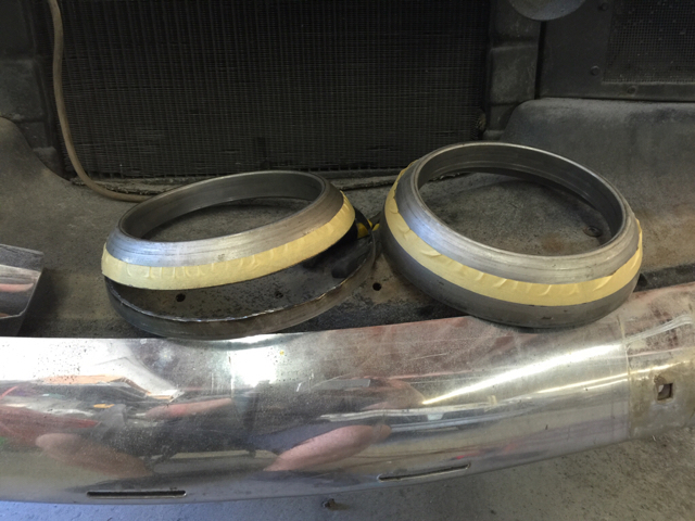

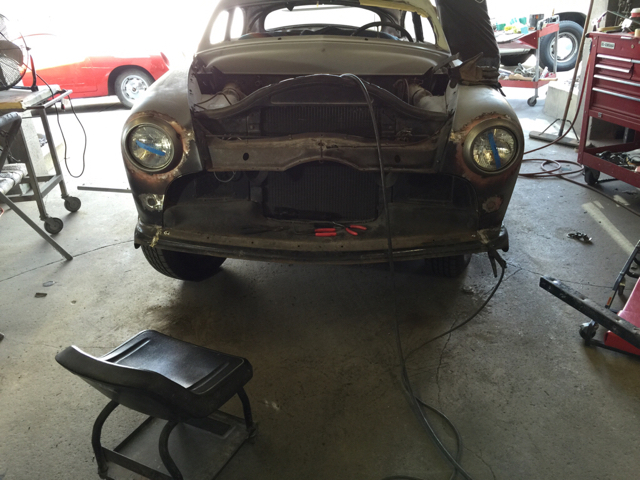

    Got some work done on the front end. Prepped the French headlights. Welded seams and filled in the parking light holes. It's looking good. ImageUploadedByH.A.M.B.1439670697.680283.jpg ImageUploadedByH.A.M.B.1439670731.897531.jpg ImageUploadedByH.A.M.B.1439670744.549862.jpg ImageUploadedByH.A.M.B.1439670767.688558.jpg ImageUploadedByH.A.M.B.1439670793.089006.jpg

    They're the ones from shoebox central. They leave you a lot of material to figure out what you want. I mounted my head light bucket from the back then measured the width of original stainless rings. I liked how they flowed better but I wanted the 1 1/2" lip that these have. They look great. I'll post more pictures when I get the welded in.

    More progress today. Finished the headlights and welded up most of the front. My buddy Jeff got some putty on the door top. And roof of the drivers side. Waiting on some engine parts and I'll be getting greasy too. ImageUploadedByH.A.M.B.1440282491.544929.jpg ImageUploadedByH.A.M.B.1440282504.462068.jpg ImageUploadedByH.A.M.B.1440282521.397012.jpg ImageUploadedByH.A.M.B.1440282534.266083.jpg ImageUploadedByH.A.M.B.1440282548.465576.jpg ImageUploadedByH.A.M.B.1440282562.401035.jpg ImageUploadedByH.A.M.B.1440282574.835648.jpg ImageUploadedByH.A.M.B.1440282584.719655.jpg

    I used to work at a "restoration"/collision shop and I traded a 28ft trailer to my boss to help me finish the bodywork and get it in to a base coat of paint. Well I got sick and had to take off work and during that time he laid me off. Since then it had been a fight to get him to do anything on my car. Finally after 6 months of the car sitting in the weather and surface rust coming through the bodywork that we just did I just pulled my car. I can't believe there are people still in business that act like this. I'm probably going to have to start over on much of the car.
