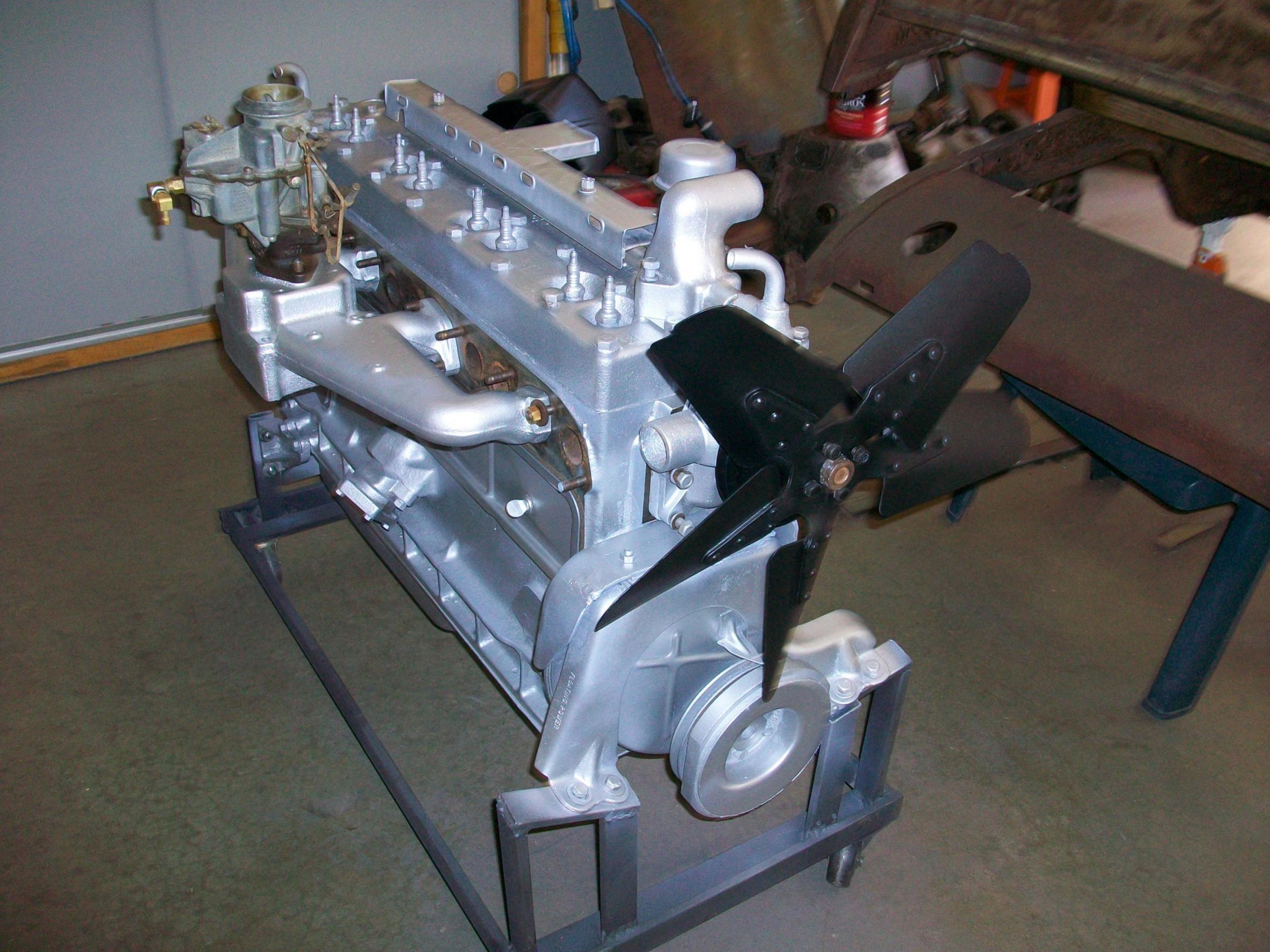

    I have all the stock specs for this engine, I also have a 1950 chrysler straight eight with original auto trans, I am putting my engine in a 1929 dodge coupe, will scan specs and send over tommorow.
    I did find an original dual carb/exhaust manifold from a dodge truck 413 straight six, will be using the carb setup and making a header for the engine.

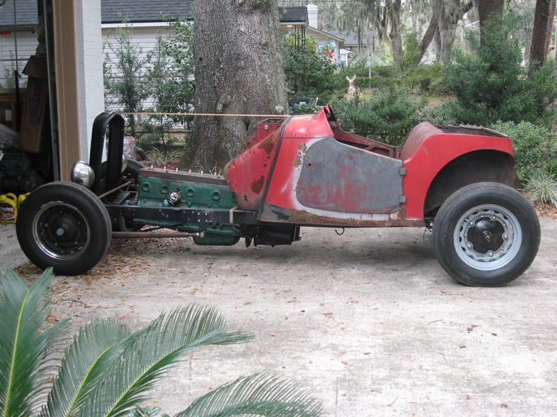

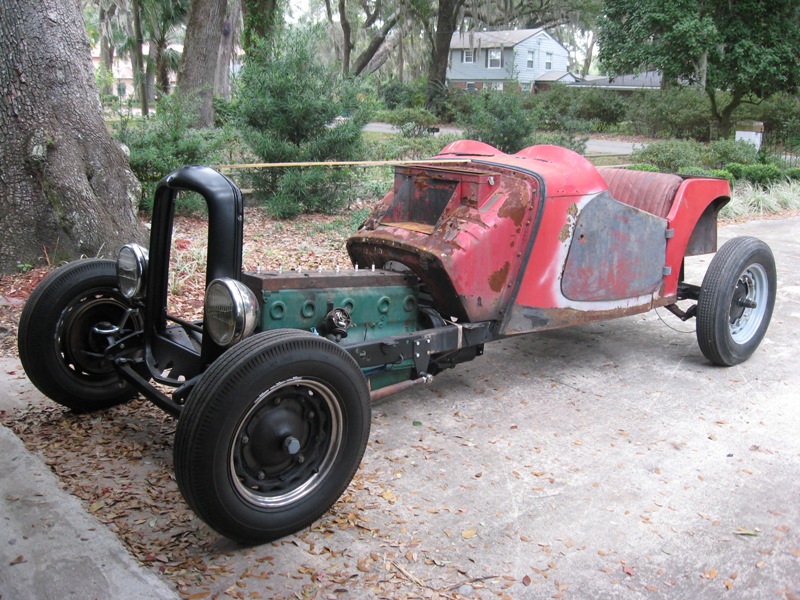

    I'm with you. The heck with bent engines, everyone has one. I had a '39 Olds two door with a straight eight more than forty years ago and it was great. My latest build is a straight eight, too, but this time a Pontiac. Mockup photos attached. Good luck with your project!

    323.5 1950 Chrysler straight eight, with the M6 auto trans. installing in my 1929 dodge coupe, lots of work ahead., Will be putting on a dual carter B & B' carbs and making a dual exhaust.

  22. Choff, I like the look of the engine in place. How much did you add to the frame or is that just a patch? Rob.

    The little roadster with the Straight 8 is fantastic.
