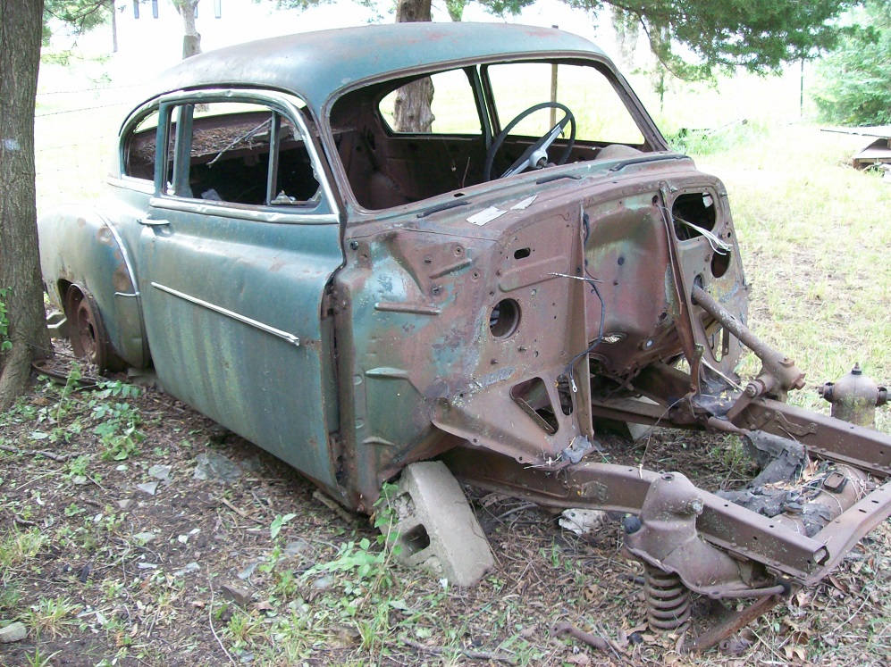

    [FONT= ]Part 1
    My 22 year old son Austin had a co-worker tell him about a 1949 Chevy that his retired uncle had learned to drive in and that the uncles brother had started taking apart back in the 1960’s. Over time, parts were either sold or lost and the concrete blocks it sat on had sunken into the ground. To add insult to injury, some neighbor kids busted all the glass out of it and broke the glass tail lights. They offered the car to Austin FREE for the hauling but it was going to be a challenge due to its condition and location.
    The first thing we had to deal with was the location. The property had two driveways both with narrow gates with pillars and with the narrow street out front there was no way to get a car trailer through them. Then the car was way in the back of the deep yard and blocked by a burn pile, a old camper and a lot of other misc piles of stuff. We went and pre-looked at the setup a week ago but this weekend it was time to go fetch. Attached are pictures of the driveway and the car as we found it. Note there was no front suspension to mount wheels to and there was a tree next to the right rear wheel opening which was setting on a bare rim. This was going to be a little bit of work but I will come up with something. To be continued...........................

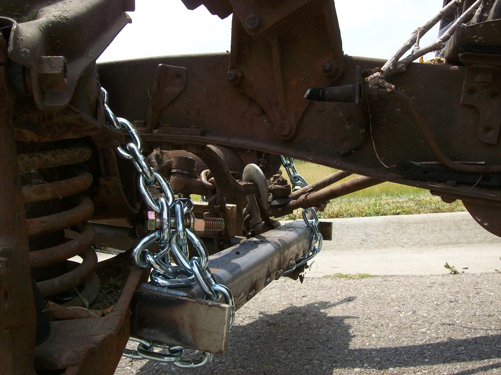

    Part 2
    So the question was “how do you move a car that you can’t put front wheels on?” My answer was to turn the car into a trailer. Being the pack rat that I am, I needed some real heavy tubing to make a trailer tongue out of but all I had was some thick wall angle iron that had been given to me previously. The first step was to cut and weld two pieces of angle iron together so it becomes square tubing then I make a “T” shaped trailer tongue. Add a couple little plates on the ends to keep my chains from sliding off and weld on a hitch and Ta Da! I have what I need.
    At the resting ground for the old car we used two sizes of floor jacks and cinder blocks to get the car up off the ground so we could mount the rear tires that I brought along with us. (Note, the wheels came off a 1950 Chevy that we parted out a couple years ago and the tires were given to me. Remember me the pack rat : ) With the rear on tires again we install the trailer tongue I made that by the way had never been tested or checked for fitment before now. With some heavy duty chains and some large grade 8 bolts, a block of wood and a extra safety chain we now have a 1949 trailer that used to be a car.
    So we pull the car out of its resting place and find that the right rear wheel is not turning. We drag the car anyway to get it onto the gravel driveway and we jack it up again and remove the tire. With a little inspection we discover that the reason the right tire was off the car in the first place. The rear brake was locked up and someone before me, more than likely the uncles brother many years ago, had been hacking away at the brake backing plate and must have given up. This finding very well could have been what parked the car in the first place and what started its downhill travel of becoming neglected and used for parts. Anyone that has ever tried to remove a stuck brake drum knows its no fun but this was worse than that. Since that drum had sat in the dirt for many years the brakes and brake drum had rusted together. Had I been at home I would have gotten out my cutting torch but I did not have it with me. What resulted next was about a 1 1/2 hour can opener method of getting the drum off. We hit it with hammers to dislodge the rust, squirted mass amounts of Liquid Wrench and WD40 in where we could and used pry bars hammered under any edge we could get into. Luckily the drum was rusted enough at he bottom that we were able to start tearing in with the pry bar and with each heave and ho we were gaining. The sun was out and the Kansas humidity was cranked up so we were sweating like crazy. Finally we got it off.
    With the tire back on the axle we drove out of the driveway and onto the street. A real Pack Rat (not me) came out from under the truck area right where we had been working all day (Geez, that would have been exciting had he popped out earlier) and hung upside down on the rear bumper. My son Austin kicked it and stunned it a bit but it jumped down and into the ditch beside the road. I threw a cinder block on top of it and that ended that. We took a few pictures of the car and down the road we went. We did have to stop once right away as there was a fender skirt bracket that had got caught on the RR tire and was rubbing it. Other than that we drove home at about 30 MPH and received many a look and wave as we drove by people out doing their Saturday chores in rural Kansas.
    The floors are gone in the car and the door latches are missing (note duct tape holding them shut) and its certainly not worth restoring so why did we do this? Well for anyone that doesn’t understand the love for old cars it will be hard to explain but for us its an adventure to dig out this old stuff and try to give it a purpose again. In the case of this car, the Fleetline long sloped roof is popular for customizers and actually the best part on the car. Believe it or not. someone could make a custom car out of this with a newer chassis. In my case, I have a 1952 Pontiac setting on my lift that someone cut the roof off with a Sawzall. I was planning on selling the Pontiac later this year but just in case someone was afraid of buying a car with no roof, I can now offer an option for them :)

    Its a 1949 Fleetline 2 door sedan. The owners brother started working on it in the 1960's and was going to turn it into a dirt oval racer but he was better at taking apart stuff than putting it back together. As I mentioned in part 2, I think the right rear brake was stuck even back then and he couldn't get the drum off but hacked away at the backing plate trying. The beginning to the end most likely.

    Very inspirational labor of love story and great innovation for the tow. What car nut could leave that thing sitting once you knew of it's exsistence. I'd love to have it myself.

    I had working tail and brake lights on the car via the Harbor Freight magnetic trailer light kit so it would be no different than I had it on a two wheeled tow dolly. I don't think I would have even been pulled over if I ran into the law unless they wanted to talk about the car. Another good reason why I live in Kansas :)

    The exterior body looks to be in pretty good shape; the floors are typical, especially after sitting for so long. Glass is expensive, and it would probably be a little cheaper to convert to a one piece windshield, like we did with my nephews 51 Bus Coupe. OR, since you're already headed in that direction, make it into a trailer! Just kidding about that. There are loads of information on these 49-54 Chevrolet cars here on the HAMB, and on ChevyTalk.Org in the 49-54 forums. Good luck with the project. Butch/56sedandelivery.

  21. If I were closer I would be after the trailer in the second picture.
