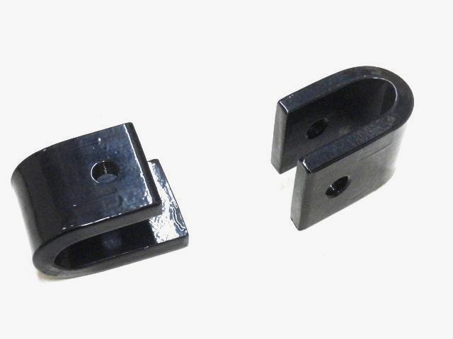

  22. I actually found and bought the factory ford mount adapters here on the HAMB when I was gonna put a 59-AB in my 34....sold them since..but they're still around. It'd be easy to replilcate them with 3/8ths strap bent into a "U" and drill and tap the mount holes.
    Sets the engine up about 1.5" or 2" and gets the spacing correct for a AB motor.

  28. Early ford store has the little u shaped offsets 50 bucks 41A-6023 1933-1934-FORD ENGINE MOUNT RISERS ADAPTERS.jpg

    Joined: May 16, 2007
    Posts: 6,684
    tubman
    Since this has come back again (it got "Liked" today), I realize I should disclose the alternative. When I needed motor mount spacers, I cut a couple of pieces of 2" square tube (3/16" wall) into a couple of trapezoidal shapped pieces a couple of inches long. After measuring the distince between the motor mount holes on the frame and engine, I drilled two holes in each on placed appropriately and welded in a couple of 7/16" bolts that went through the top holes.
