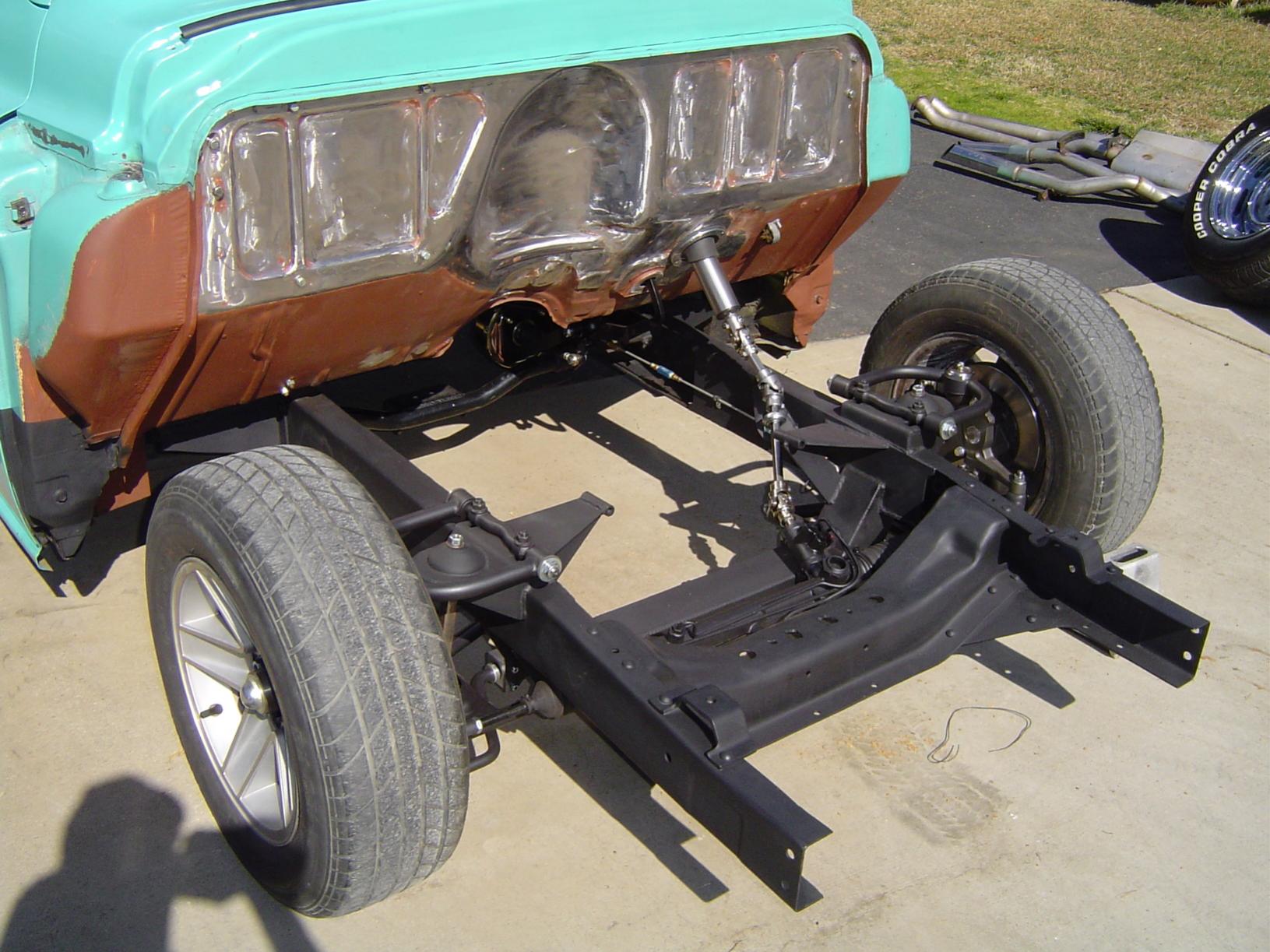

    Here's a setup that might work for you. 93-2003 camaro/trans am front end. I've got one in my 1966 ford f100 p/u. I don't know how wide your frame is ,the ford frame is right at 34 inches. With mid 80s stock camaro mags. outside to outside is about 71 inches w/p195/60/15" tires.I had to fab. up strut towers w/ plate steel and change springs using 1990's ford f150 springs . These cars are in most salvage yards ,and I paid $200 for complete assy. I've got about 10,000 miles and 2 years on mine,and its my daily driver. good luck!
