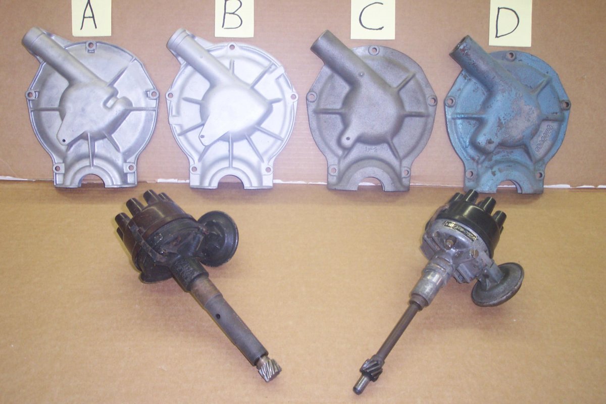

    I have included 2 pictures of distributors both commonly referred as "49-53 Ford 8BA flathead V-8" Can someone please educate me... The one with the smaller diameter shaft fits my 1952 F-1 Pick up.. I received a replacement, but its different, fatter shaft with the gear at the bottom. Is it just the front cover that is different? And does my style have a name, so I can get the appropriate fitment?

    I think...the one with the longer shaft at the bottom was a later design.
    They will both work.
    But the longer shaft will not fit in the timing cover unless it has the hole for that extension.
  3. fordf1trucknut
    Joined: Feb 13, 2007
    Posts: 1,174
    fordf1trucknut
    One if for an aluminum timing cover and one is for a cast iron timing cover.

    The cast iron (shorter) version came with both cast iron and alloy front covers, while the alloy distributor with the extended shaft came only with the alloy cover and lower shaft support. The pictures below may help.
    Above is the front view of the most common front covers I've seen and come across. "A" and "B" are alloy, "C" and "D" are iron.

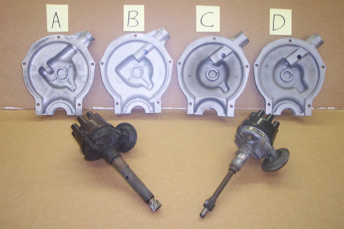

    Above is the back side of the 4 covers. Note the short upper support in cover "A" and the reason for the lower support when using the alloy distributor housing on the right. Covers "B", "C" and "D" all have the longer upper support designed for use with the cast iron distributor housing on the left.

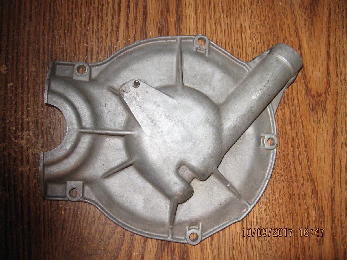

    Thanks for posting this; it clears up a lot of questions I had. Even with that, I think I have a fifth version of the timing cover. It's a minor variation from what I can see on your pictures, but it is different. The one I have is aluminum and while it does have the timing pointer in the passenger car position (like covers "A", "C", and "D") it also has a cast in mark where the truck pointer should go (cover "B"). I think it says "OBA" next to the pointer and "8RT" cast into the cover, along with a circle where the truck pointer should go. The different pointer locations are required because of the larger diameter of the crankshaft pulley on a truck. I mention this mainly because most people don't know there is a difference between the pointer locations for cars and trucks. I'll take a picture of my cover when I go to my shop today and post it later.

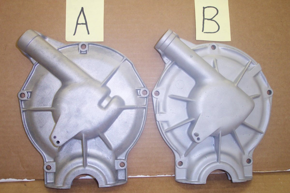

    Here's a close up picture showing the two pointer locations.
    The higher location was used on trucks and '49 Ford and Mercury cars, because of the larger diameter wide belt crank pulleys.

  14. tubman
    Joined: May 16, 2007
    Posts: 6,913
    tubman
    Here is a picture of the cover I am referring to : the numbers cast into the cover should be easily visible in this photo. If I had to guess, I would think that this cover was issued as service replacements late in the flathead era and would accommodate any of the distributors from the "8BA" era. I my opinion, this is a fifth version of flathead timing covers, like I originally said.

  18. V8 Bob
    Joined: Feb 6, 2007
    Posts: 2,966
    V8 Bob
    If the upper support is short (about 2.5") like my cover "A", an extended shaft distributor should only be used, imo.

  20. Simplicity
    Joined: Jul 12, 2009
    Posts: 16
    Simplicity
    from Toronto
    Here is the cast timing marks on a cover I had as well.
