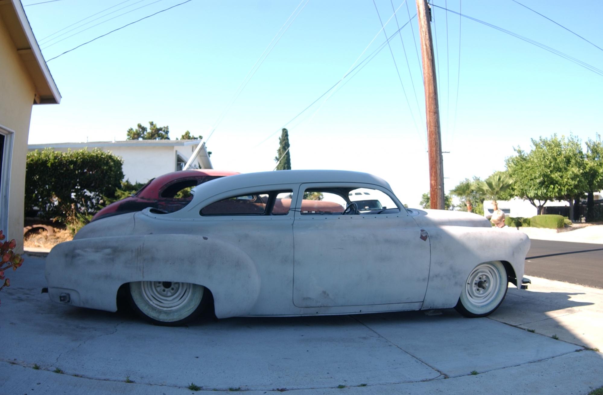

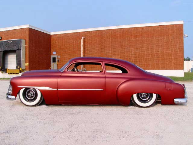

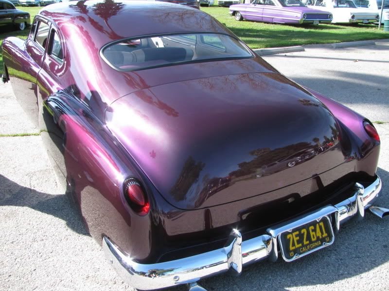

    Here are a couple two doors I stole from the HAMB and my junky old four door. Not only does it take some of the bulkiness out of the C pillar, it keeps you from having to lean the back window down so far. On both of the 2 doors, they eliminated the belt line trim under the rear window. I am going to rework the stainless on my four door and run the stock trim.

    This is a coupe with I believe the rear of the roof moved foreward,extending the catwalk. Nicely proportioned chop.
  7. that is called the dutchman panel the purple and red car droplord posted are cool

    Hey buddy do you have any more pics of the red car?

    Here is Ian Berkys....Im not sure how far its pulled forward but it is and has great flow, one of the nicest around! Check out his album in his profile for more.

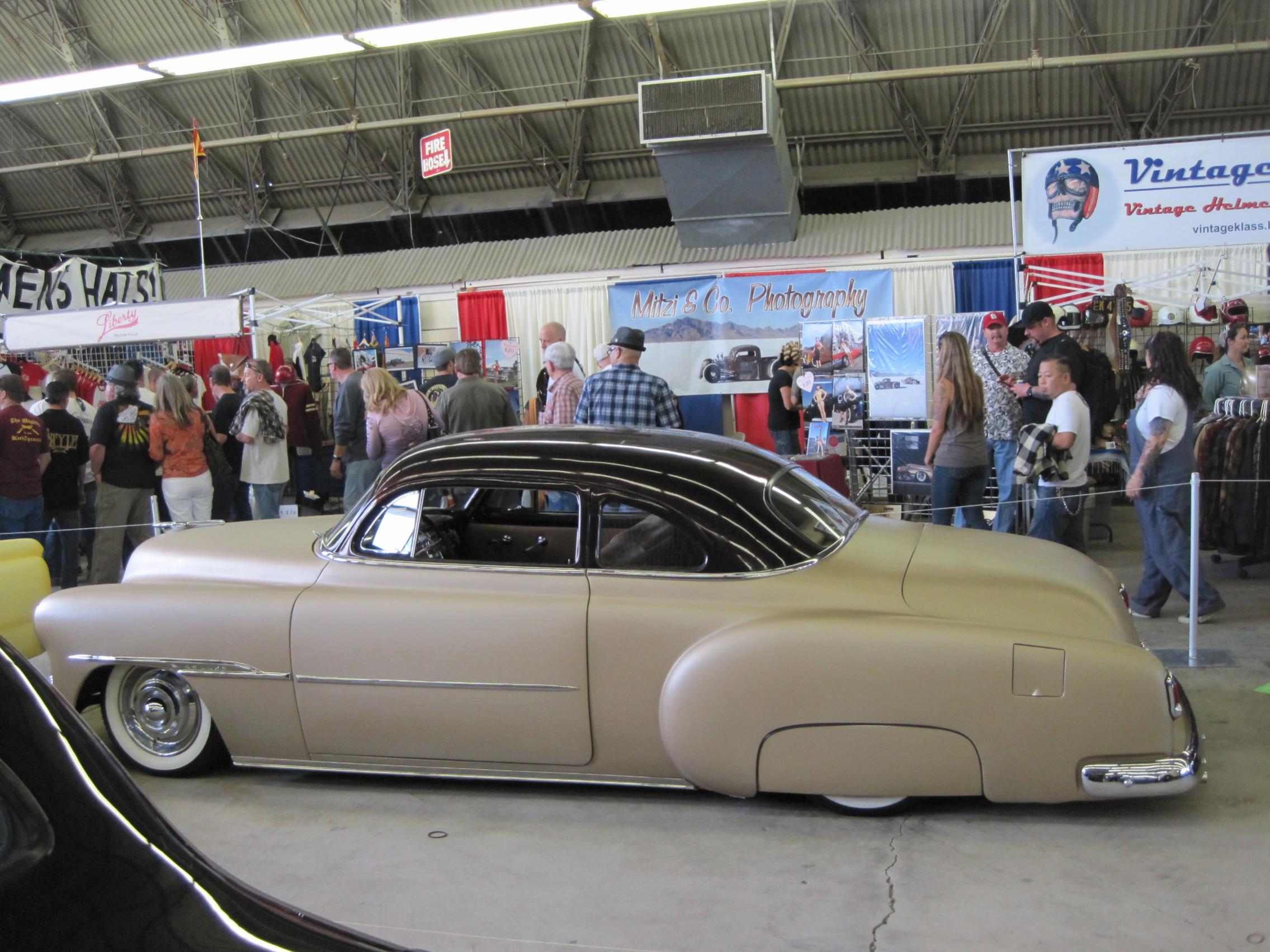

    here is 51 coupe without extended catwalk vs the other tan one from the suede palace!!
