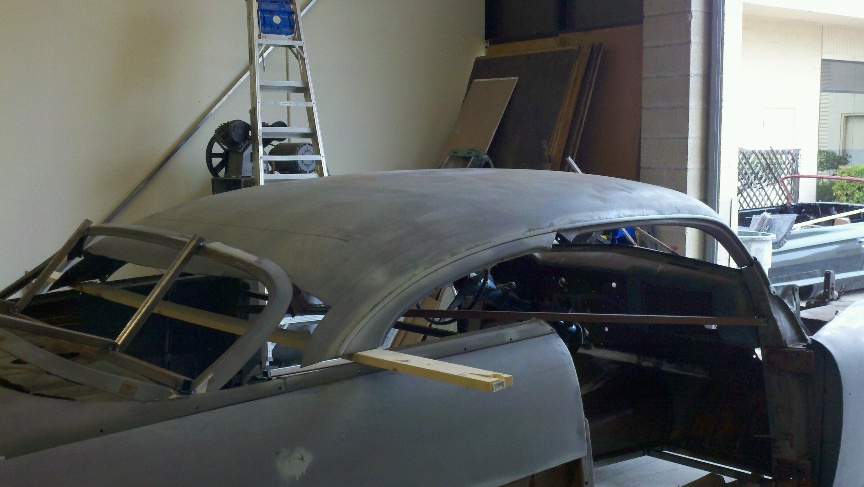

  13. It all dependes on your taste. On a 49/50 i personally like 3.5" to 4" out of the A-pillar with 3/4" to 1" more out of the back and move the back glass forward about 3". This 50 is cut 3 3/4" front and 4 1/2" rear with rear window moves forward 3"

    i whacked mine @ 4.25" in front a-pillar... im dropping a 49 rear window in it... i didnt care for anything less and anything more is just too much... so im pretty biased on what i chose... the rear however is unknown, i did cut too much and thats why i threw the 1x under the c-pillar to space it up... i think im around 5" in back

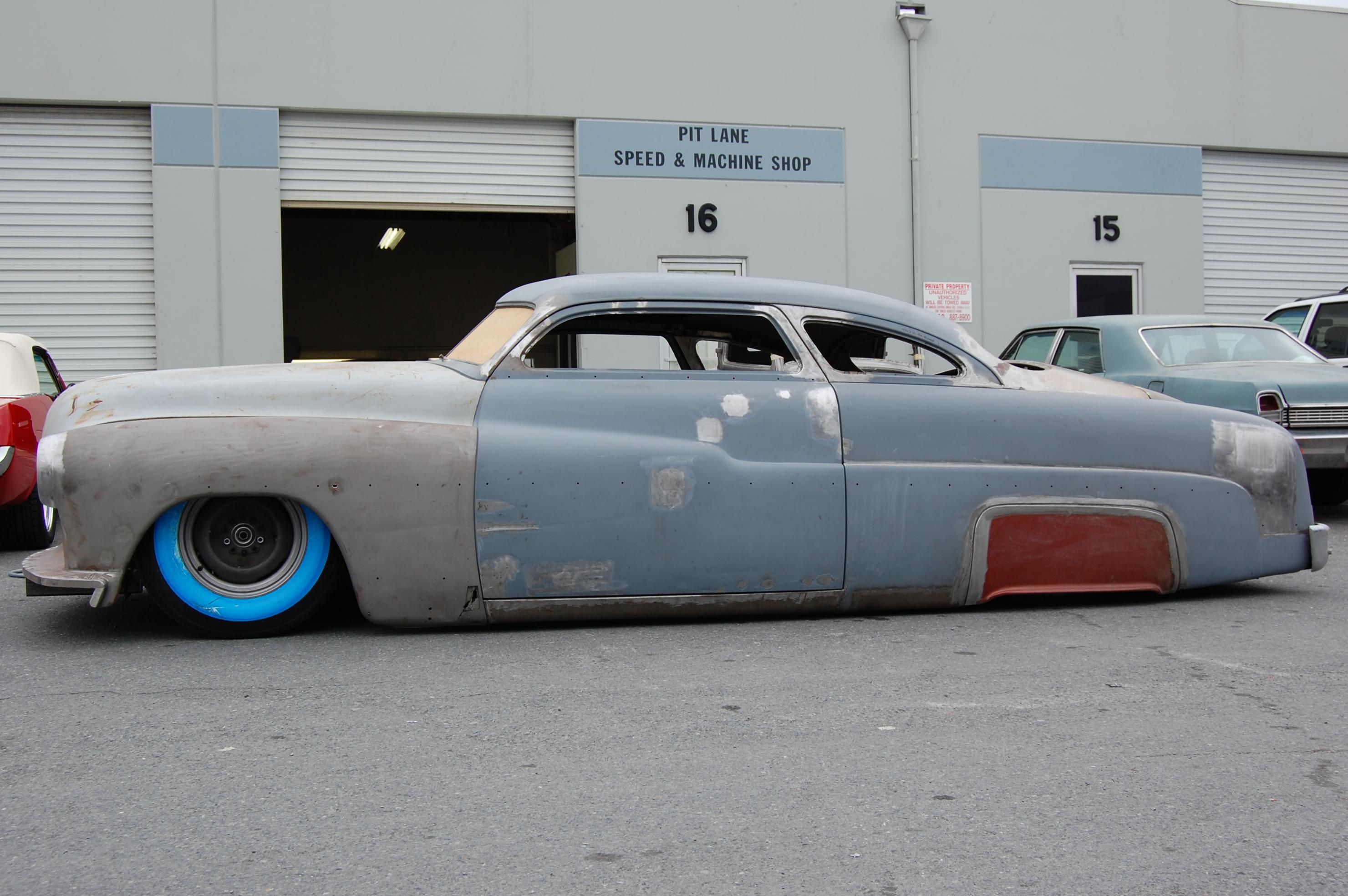

  17. banditomerc
    Joined: Dec 18, 2005
    Posts: 2,482
    banditomerc
    How about a side shot Ace.

    Ace
    Great chop. And that is the funniest answer I have seen on the HAMB in a long time. Great reply! I may have to get the kids-size soda at the drive thru! So tired of the serious "traditional-police" answers on here by people of late. Gotta get back to making this site light-hearted and fun again. By the way mine is 4" front 4 1/2" back by slddnmatt; the Mercologist.

    Mine is 4 1/2 in front and about 5 in back.

    I found one article on the hamb where it looks like he cut the front but didn't really take any out the back. looks like he just cut above rear glass and pulled roof forward and let it land where it lands. looked simple to me . Am I missing something?
  21. slddnmatt
    Joined: Mar 30, 2006
    Posts: 3,685
    slddnmatt
    A whole bunch. Bunch of different ways of doing a chop.
