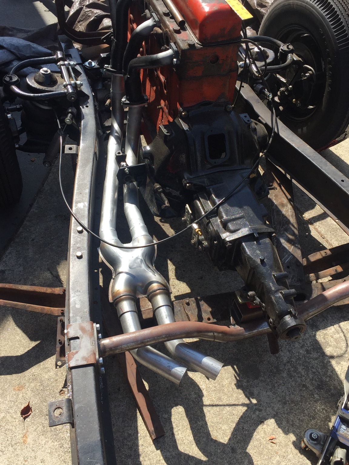

    I just started building the exhaust for mine. I wanted to keep the pedals under the floor but there's no frickin room left! Walton Fabrications has a super nice engineered pedal kit that can be configured with a clutch MC and pedal as well. [​IMG]
    Hnstray likes this.
