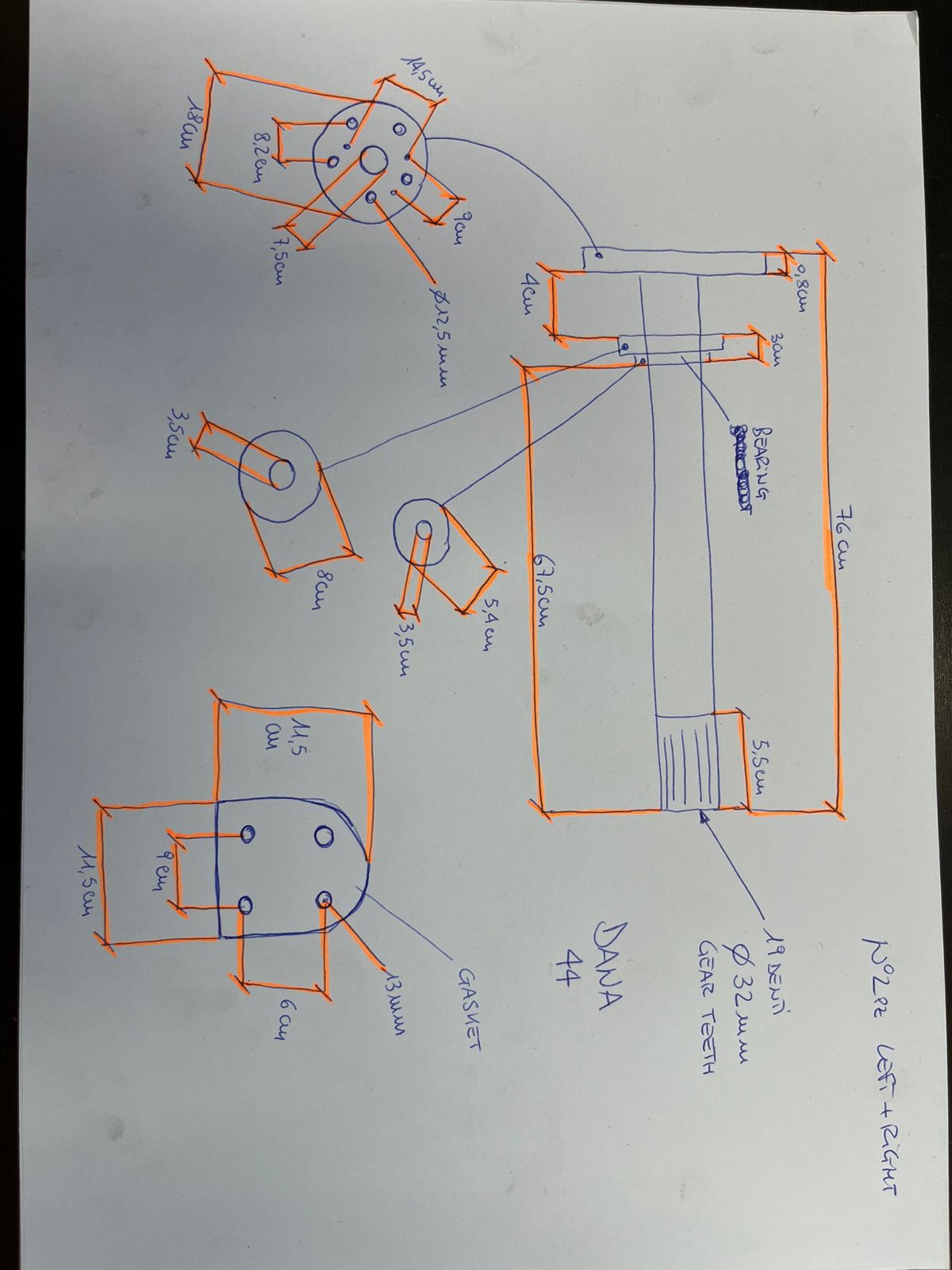

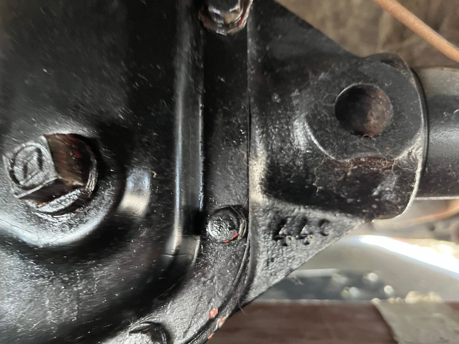

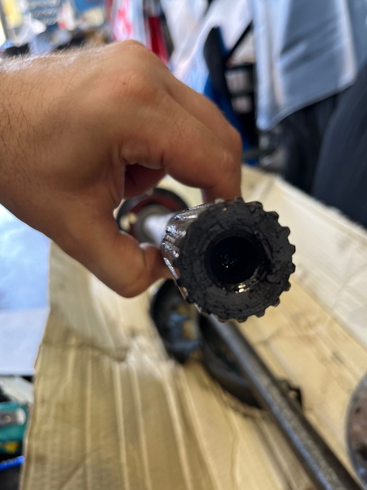

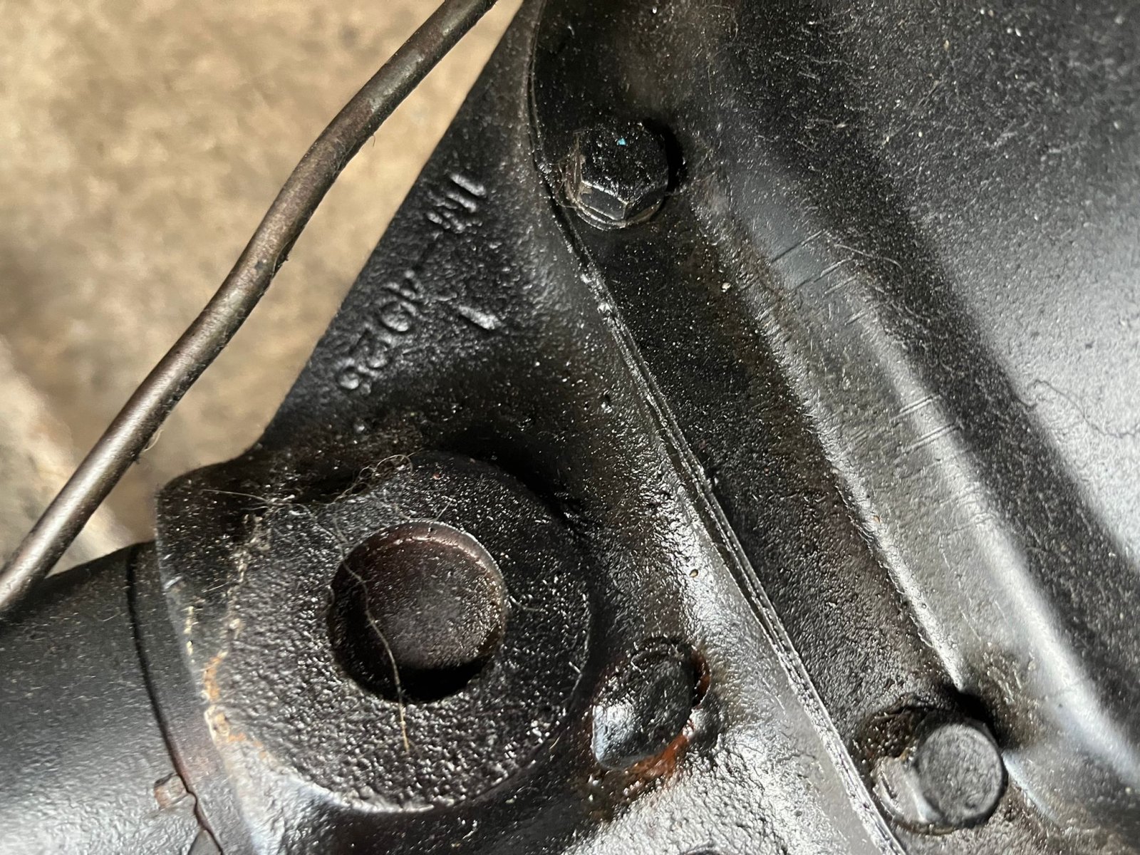

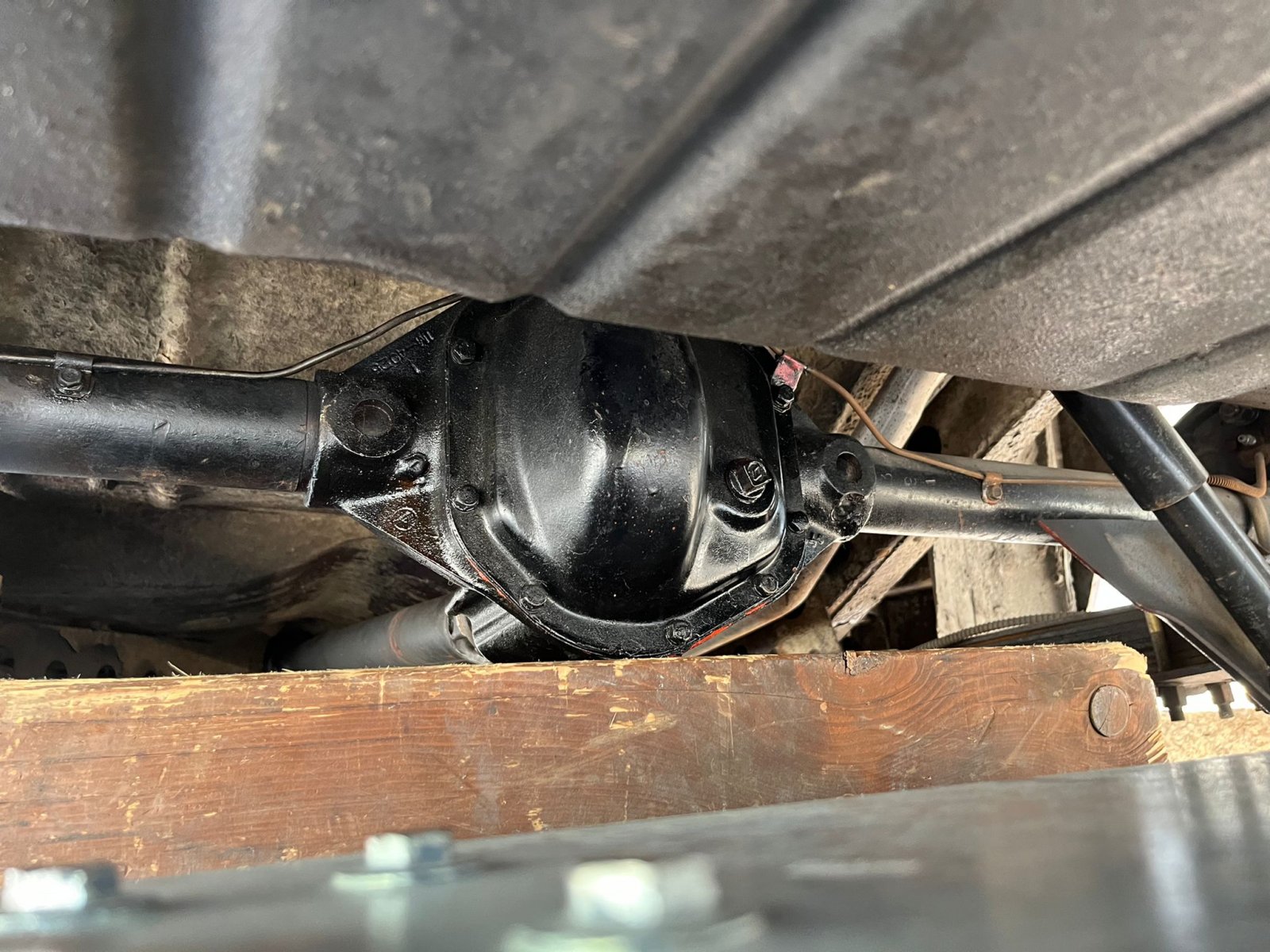

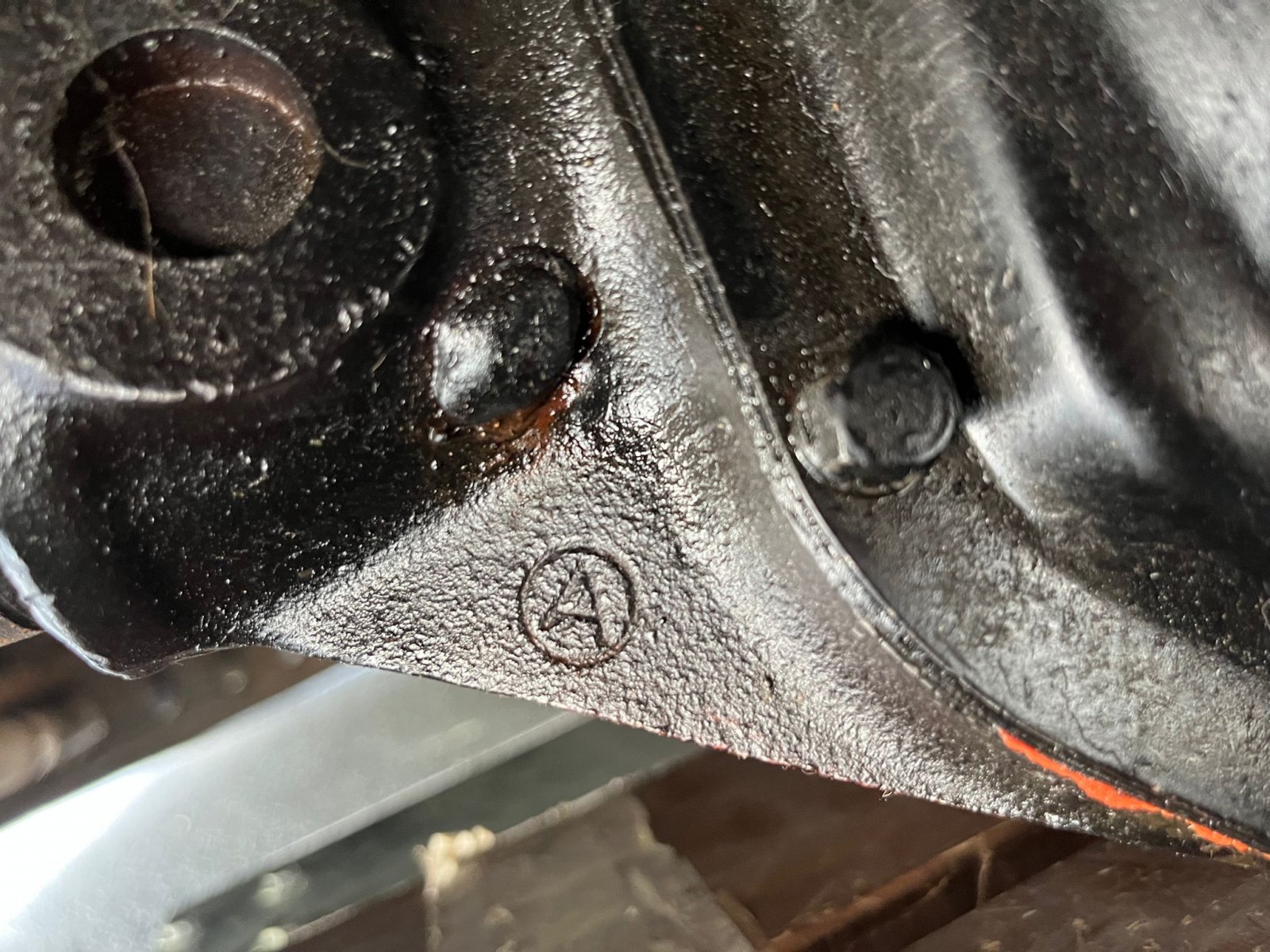

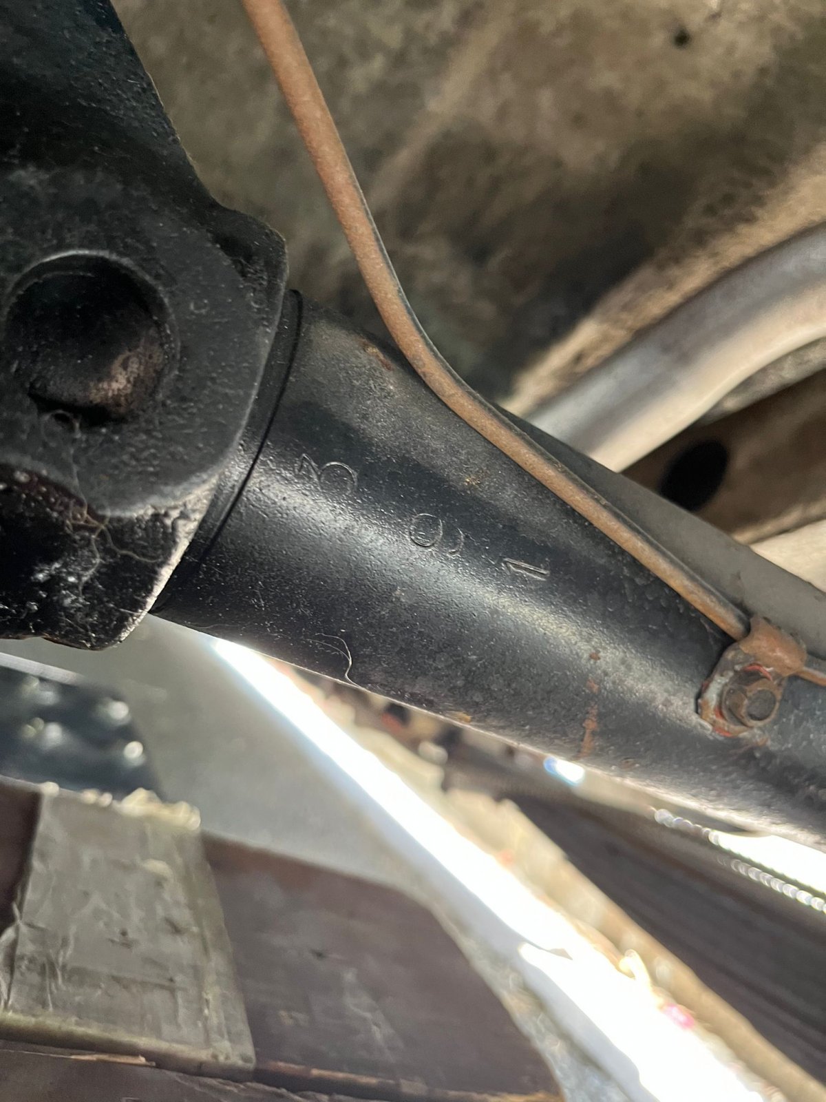

  12. MarcoITA
    Joined: Aug 2, 2022
    Posts: 2
    MarcoITA

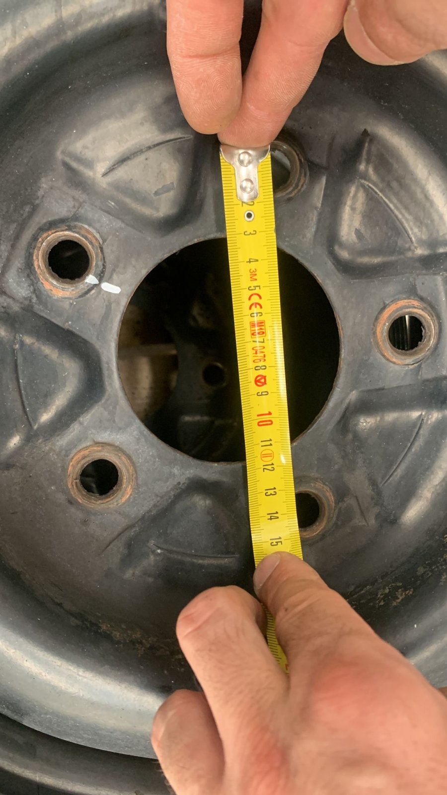

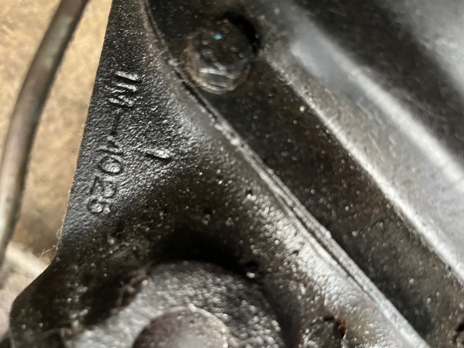

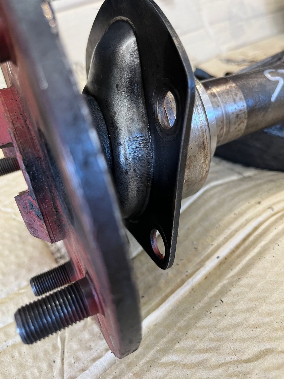

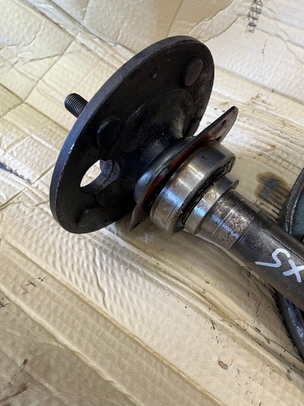

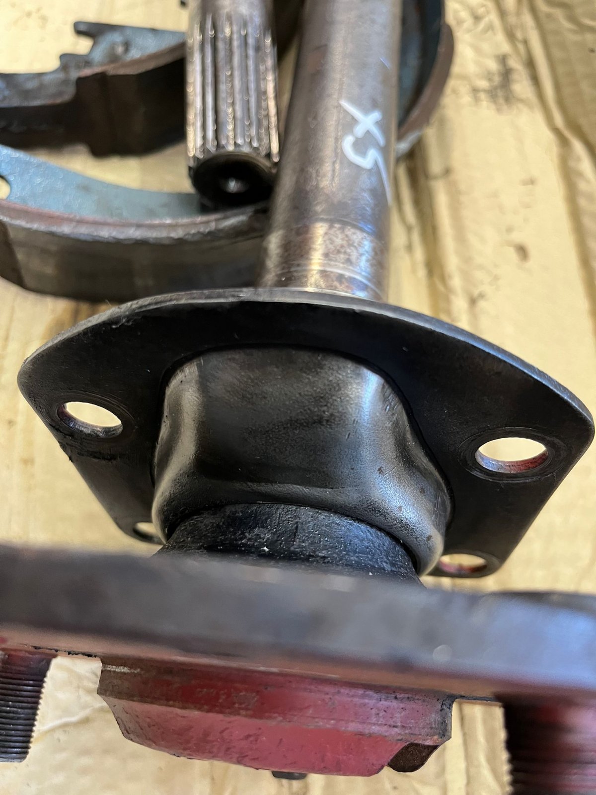

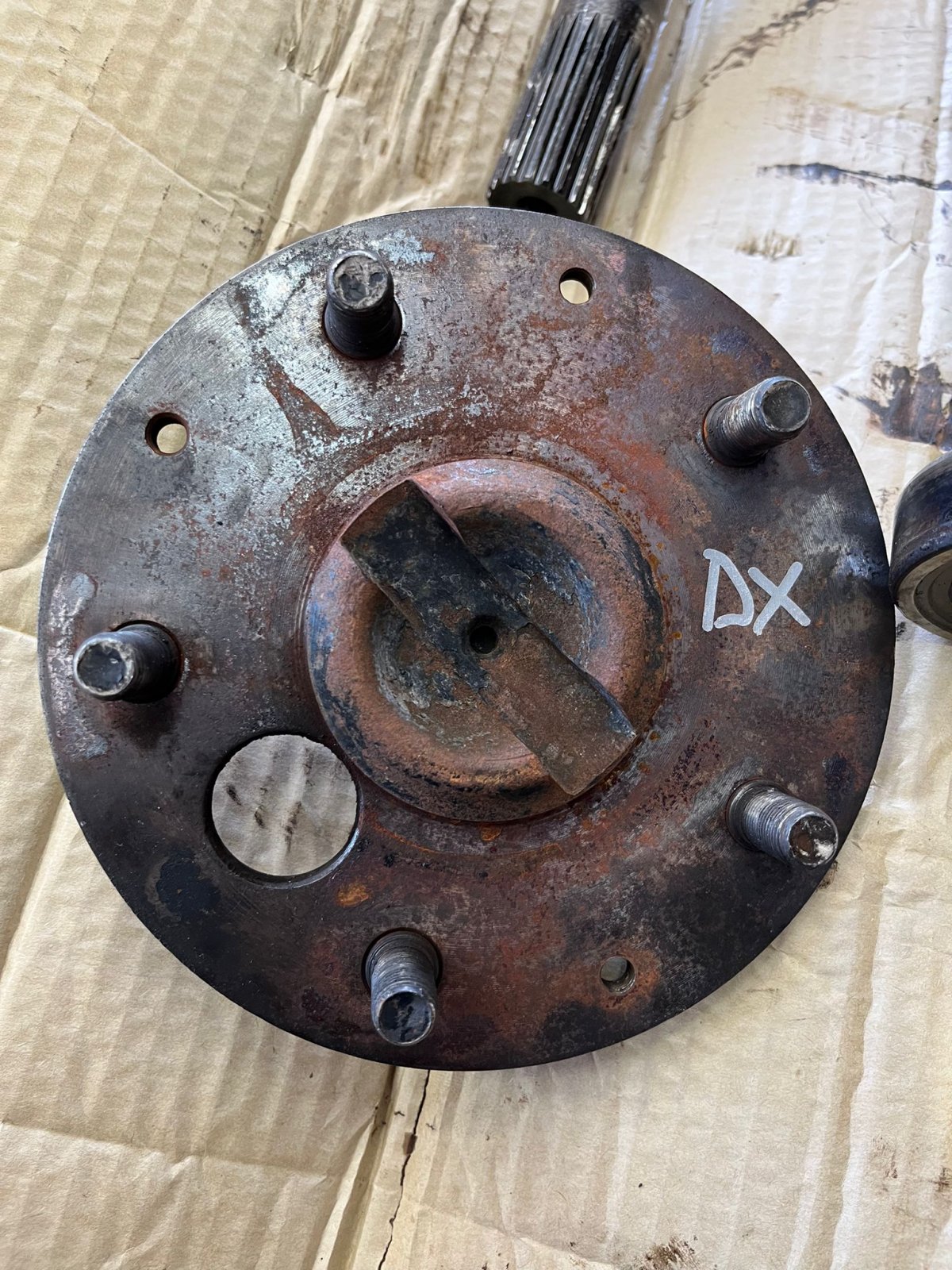

    Hi guys,
    can anyone help me figure out what kind of axis is installed on my Mercury?

  14. gimpyshotrods
    Joined: May 20, 2009
    Posts: 23,333
    gimpyshotrods
    You provided your own answer!
    Dana 44. Huge support in the aftermarket. Plenty strong.
