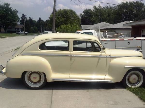

    Just picked up a 1948 plymouth from my buddy.
    It has an older restoration done to it and its in pretty good shape. Runs and drives good.
    Now to give it a better stance i want to lower it as much as possible without doing too many mods and without going to airbags. i was thinking just cut the front springs and get lowering blocks for the back.
    is that the best way to slam it??
    also looking for a visor and some cool full hub caps thatll fit these wheels. any suggestions.
    maybe some yellow fog lights? any other cool ideas?
    thanks

  4. Looks good! Are those hubcaps painted to match?

    I like them better than the Fords and at least as much as the Chevys. Put duals on it and lower it. Some pin striping or tasteful scallops and you're in the money.

    ye they are the stock caps painted

    My 41 Coupe had 1 coil cut from the front and 2" blocks on the rear, road well and with 195/75 and 235/75 Coker whitewalls on 6 & 7" chrome smoothies everything cleared fine......lower but not scraping is how I like them........tho' the 40 Dodge is just with a tyre & engine weight rake..........nice Plymouth you have btw............andyd
  9. You can relocate the front spring lower "retaining plate" to the bottom of the control arm

    I would absolutely second that! I have never understood why visors are on hot rods and customs. As far as lowering, as someone above mentioned, drill out the rivets that hold the spring pocket to the bottom of the lower arm and make a 1" spacer, put it back together. If it's still not low enough trim a bit of spring and try again.

    i like the look of it just need to add the skirts, visor and lower it as much as possible while being practical.
