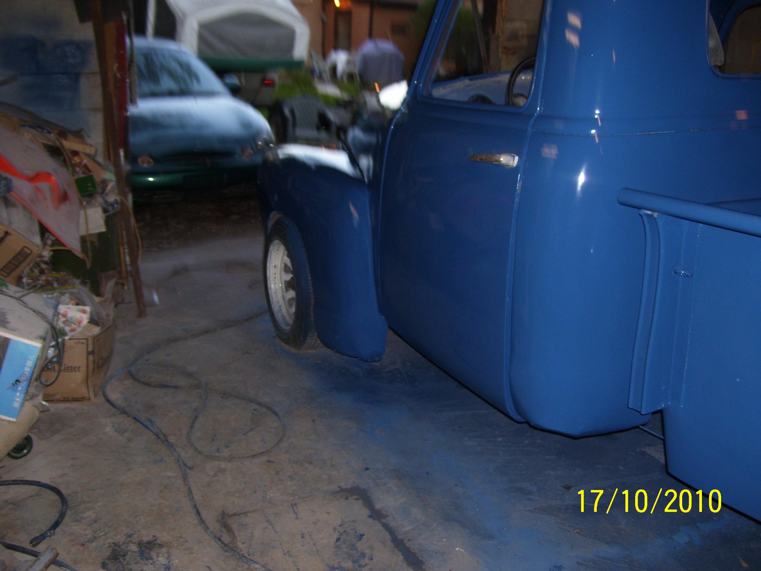

  2. are those the size wheels/tires you are going to use? no offense , it's a bit wide and high up front
  3. DrJ
    Posts: 9,418
    DrJ
    Put some "front wheel drive" wheels on it with a set of any fifties car hubcaps that will stay on the wheels and WWW's and you got it.

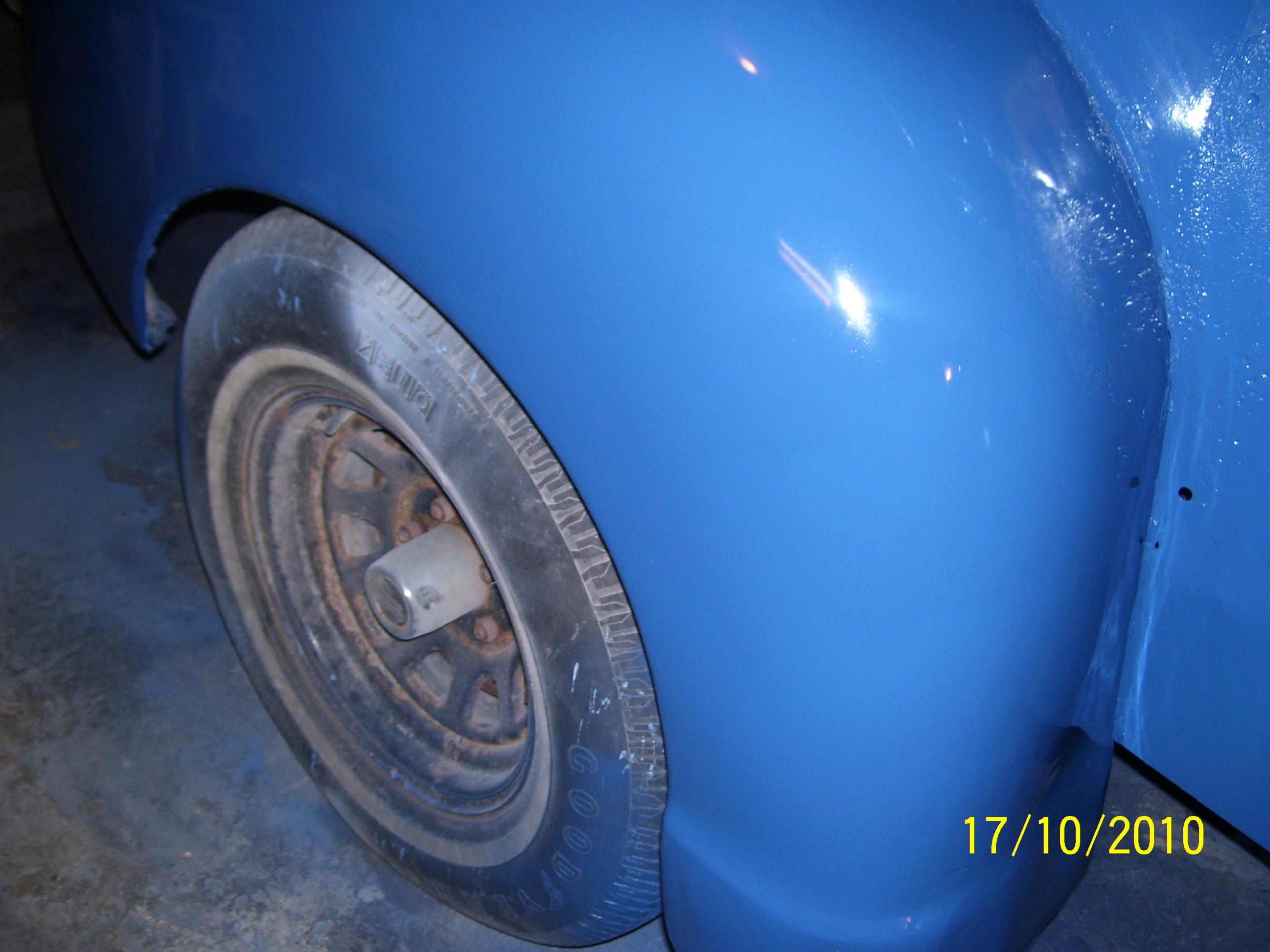

    Why put pics up of shoddy work?

    Wow the track isn't as wide as I thought it would be. I'm sure some custom offset wheels would correct it. I wonder how much you could shorten the control arms without screwing up the geometry?

    what is shoddy about it THIS truck was in a field since 1983 i thought i gave it a second chance

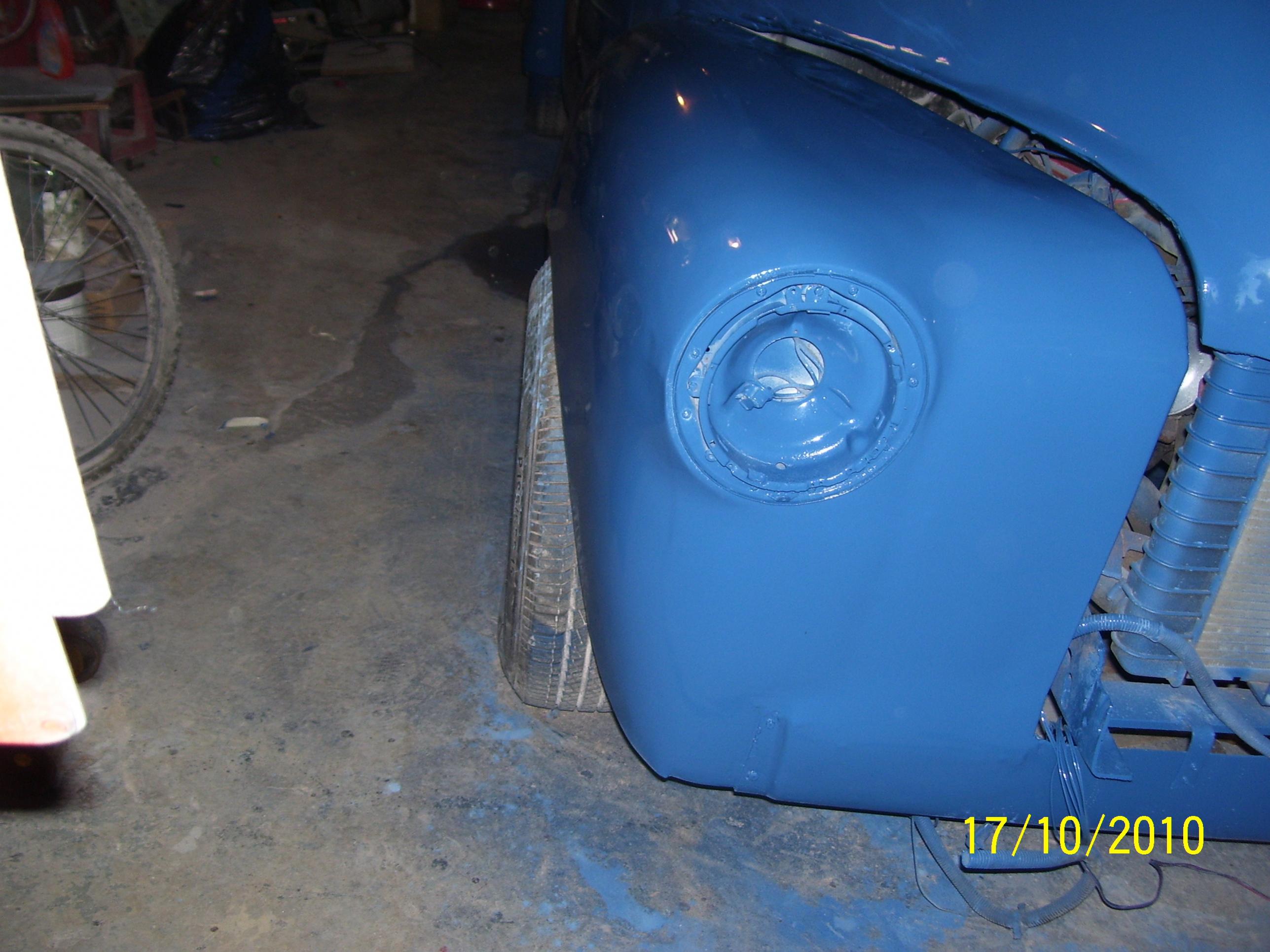

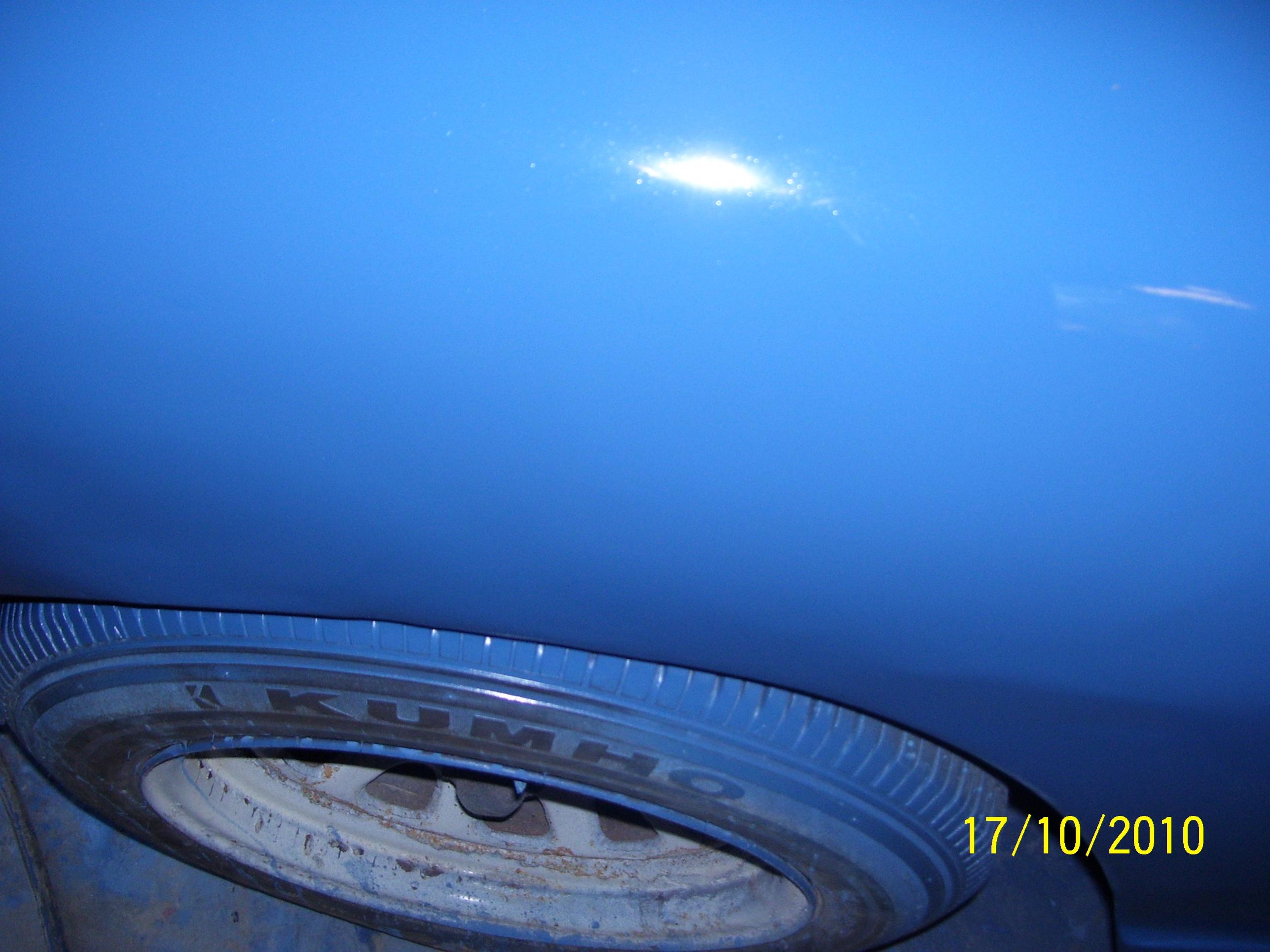

    Im just asking why 6 detail shots of painted over rustholes?

    box sides are not done im going with woody look on the box This was a father & son project we know its not perfect BUT we like it

    Shinysideup... Clearly you have little knowledge of AD trucks. The point of the post is that its commonly thought that a newer GM fullsize 1/2 ton chassis are way to wide for a donor chassis. But Jtbloye did it and proved that the swap is workable. Hey he will have a real truck that can haul and tow and probobly for dirt cheap. So if the tires stick out a bit to bad for you. He and his kid will be driving by you and you will still be sitting at you computer poking holes at everything you see. PS feel free to correct my gramar to if you like.

    Looks pretty good. When I saw the title of this thread I didn't know what to expect. Back in the 90's I saw a 51 Chevy on a 73-87 chassis and it sat way high and wide. This one, not so much. I like the idea of the negative offset wheels, WWW's and caps. Good work... I like the fact that it's a father/son project. Awesome!!

  15. in my first post , i wasn't knocking the workmanship or the joy you got out of doing a father/son project. if you both like it that's fine , enjoy it all you want. you accomplished something that many just dream of...rebuilding an old car and putting it back on the road. for every project that gets done i'm sure there is a dozen or more that do nothing but collect dust....many here on the Hamb
    but...YOU said you were told it couldn't be done , and posted pictures to prove them wrong. well , in my mind it is still not done. when i look at the pictures i can't help think how much nicer it would be if it was about 4" lower and about 3" narrower. that's how i would like it , you obviously prefer it different
    just take it as constructive criticism , no one bats 1000....me included. i have done some things that later i wonder what i was thinking of. you didn't think everyone was going to jump in and give you an atta boy , did you?
    here is my advice if you are in the mood for it: as for negative offset/front wheel drive wheels , i don't care for the look. i suggest you look into narrowed A-arms and dropped spindles..or leave it the way it is and just tell us to $@#*

    Thank you, I have too much time and money invested and now I know I can proceed. I might try some positive offset wheels and smaller diameter tires. Terry

    Screw what other people say man if your building something Old we should all dig it, with that being said I have a 51 on aa 71 c10 frame. Wheels with the right off set worked great. I ended up lowering mine 5" in the front so I took 3/4" from the control arms and rolled the fenders. Keep on with the father son project it means more to your boy than it does to ass holes on here

    You are not the first to do this swap. I have seen it before and with wheel mods it looked perfect. As for the rear you can get fibberglass fenders that are wider if no other solution comes to mind. All power to you for trying it and I am sure it will be perfect when finished.
  26. I'm thinking what a better project than to widen the stock rear fenders with steel. That will earn you some bones here on the forum!!!!

    I do say congrats for yourself and your son sharing time and learning together. Nothing better than that. And I also don't know who "they" are, but as far as couldn't be done - in 120 miles of bopping around Phoenix yesterday and today I saw three either on a late truck frame or with a late truck front end. It is fairly common. And,you can tell them from a mile away. I do have to side with the too high and too wide crowd as well. Narrowing the arms and such rarely ever works well with basic geometry, so just let it fly and enjoy the fruit of your labors. Don't worry about what is said here.

    You can shorten those arms about 1 1/2 inches before you start running into problem geometry wise.
