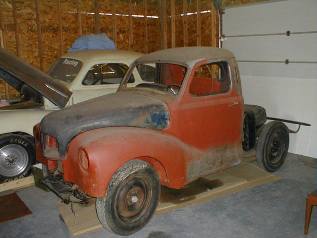

    The Austin has arrived !!
    Craik Saskatchewan is 7.5 hrs from Winnipeg. My brother and I left Friday night and did an over night in Regina, about 5 hrs out. Saturday Morning we rolled into Craik, met a cool guy name Larry and loaded up the Austin and the extra pieces. The Austin was everything it was advertised. I almost feel bad that i'm going to pull the front and rear suspension out of this thing - it's that nice. We loaded, bench raced a bit and then hit the road. 7.5 hrs later we were home... all good.
    A friend has offered me space in a heated garage to store and work on it this winter. I have no desire to spend money on it for a bit - or until I`m done dumping money into the Scout - but there is a ton of stuff I can do to this without spending a dime. (take it apart, clean, reinforce the frame, shorten and narrow the bed...etc etc etc...) That offer might be the jump start I need to get this thing ready for Meltdown 2018
    Look how narrow it is - wow !!
    Looking to narrow the box about 6 inches - to reduce the `massive`look to it
    92 inch wheelbase
    Box will be shortened about 8 inches
    Grill came with it. Top and bottom sections.
    I also have bumpers, bumper mounts and an assortment of spare parts.
    That absolutely perfect front suspension is coming out - and being replaced with a straight axle.
    Going to try and keep the bench seat.
    May need some repair and some mods to clear the roll bar but it`s the correct angle to drive this thing. Especially when I pull the fire wall 6`closer to it. May put the throttle straight up and down or in the passenger side
    My trailer is too big - said no racer ever !!

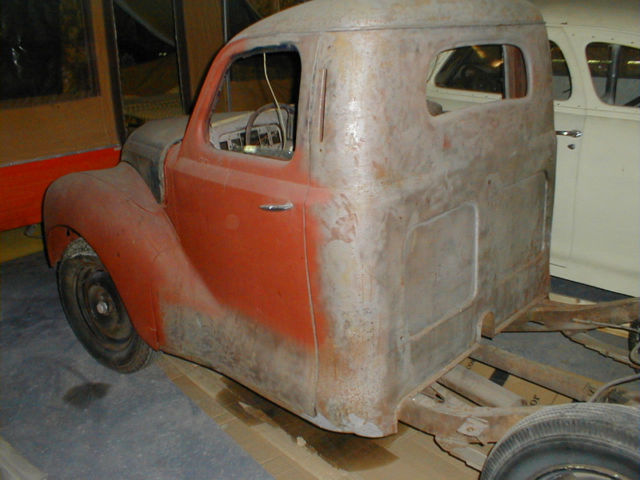

    And so it begins:
    Spent a couple of hours with my friend James tearing into the Austin. We would have had the drive-train out if we hadn't run into some weird size bolts holding the transmission and mount. They aren't 13mm and not 14mm. Not 1/2 in and not 7/16... very odd. Oh well nothing a grinder and cutting discs won't rectify.
    Should have seen the "safe" removal of the coil springs under tension. Included the use of impact guns, 3 ton jacks and some "oh shit" use of tools at an arm's length distance. As if that would have saved us. In the end we survived and no-one lost a limb.
    Next weekend the cab is coming off and that drive-train is coming out... Whether it wants to or not... If I don't have the correct wrenches then a cutting torch and the previously mentioned stack of cutting discs will come into play.
    The more this thing comes apart the more I'm happy with it. When we pulled the fenders off I expected to see some rot in the water puddling areas... there was none, nothing, zip... no rot at all. Just primered metal. Soooo happy with this so far.

    Cab has been separated from the frame, engine and transmission out. A borrowed set of 12 point Whitworth sockets made life a bit easier (Thanks Larry)
    I am at the point where I need to make decisions regarding suspension and drive train so I can make changes to the frame. Shoot - even the frame is a decision. The current frame is in great shape but I can't ignore most of the builds I've seen for these trucks that simply build a new 2x3 frame. As far a decision is concerned I think I'll start with the easy one and make the call on the rear suspension. Ladders bars have always been the plan but I believe I'll stay with the current leaf spring set up that's on the truck. It's a less expensive set up and should work just fine.
    It's also at a point where I need to spend some money on it for materials and maybe even pony up for some parts so I can keep moving forward. Slow - but forward
