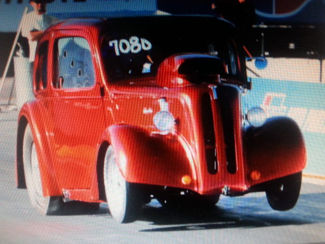

  10. I have owned and built a number of Anglias and Thames panels and having done it both ways & after all is said and done I would recommend leaving the body attached (welded and riveted) to the original frame. This maintains the integrity and alignment of the body, doors and front end sheet metal and saves many hours of excess labor doing it the other way. The stock frames are small and light so I double box the frames (one plate in the center of the frame rail and one on the outside to box it in). The last Anglia (my avatar) I built this way and never had any door alignment &/or door sagging or any other issues for the 15 years I had it on the road.
  11. My old Anglia, was a race car, had a custom built chassis. All bolted to the chassis without any rubber. I build street and or strip cars. All my strip cars are solid and some street, depends on the application. Most full size street cars will use rubber mounts, less vibration. In race cars, even your engine is mounted solid the the chassis.
