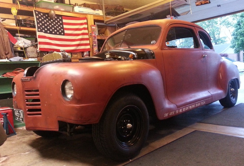

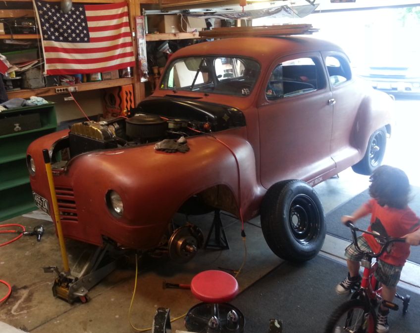

    Well its been many moons since my last post on here. Almost exactly 1 year in fact. I didn't do much last year other than put miles on it. The leather business has really taken off so I spent the whole winter trying to keep up with that! I'm still about a year back ordered, but its crusing season so I have to get something done!

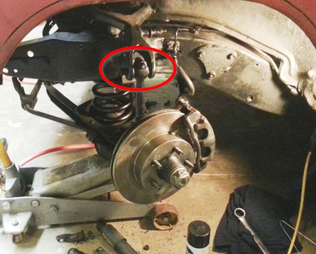

    I finally got around to throwing on the Aerostar front coils last night. My springs were already cut down so I don't expect much ride height change. Infact it may raise it a little. I'm really just looking for a little smoother ride and stop bottoming out the suspension.
    All in all a very simple swap. I haven't buttoned everything up just yet because I need to figure out if there is a proper torque for the upper spindle bolt (I'm sure thats not the technical term) that goes through the upper control arm.
    I was reading on the p15 site this morning and it sounds like its even easier to drop the lower control arm than the upper, so I will probably do the passenger side that way tonight. I've ordered new front and rear shocks even though I plan to relocate the front upper shock mount. I'm going to run to Indiana this weekend for the first cruise in of the season so I want to see how it handles with the new springs and shocks.
