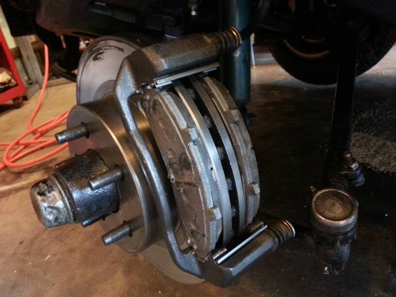

    Well finally got back in the garage after a hectic week of work last week and going out of town for the Mid-Ohio Vintage GranPrix last weekend. I immediately located the grinding noise in the new disc set-up. I installed the drivers side inner pad backward. ..as in pad steel on steel rotor surface! Fortunately I only drove the car to the stop sign and back. I'll have to get the rotor turned but I'm gonna drive it a little around town to make sure it doesn't have any other major issues. I seems to be stopping good but the pedal is so soft it feels like my new cars! At about 30mph if I stab it hard it will lock up the brakes. Not sure if its the front or rears yet.
