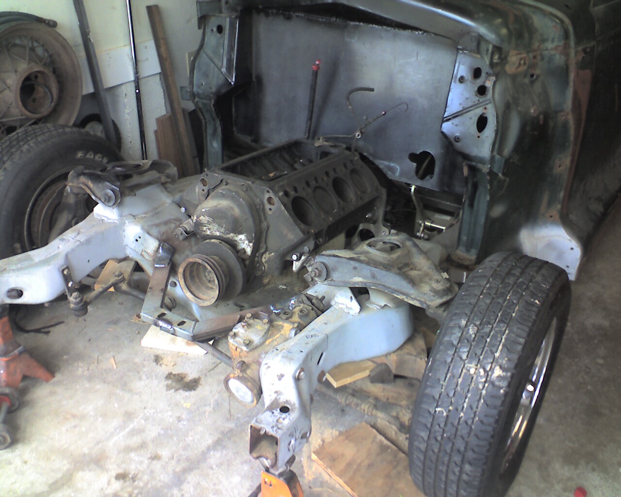

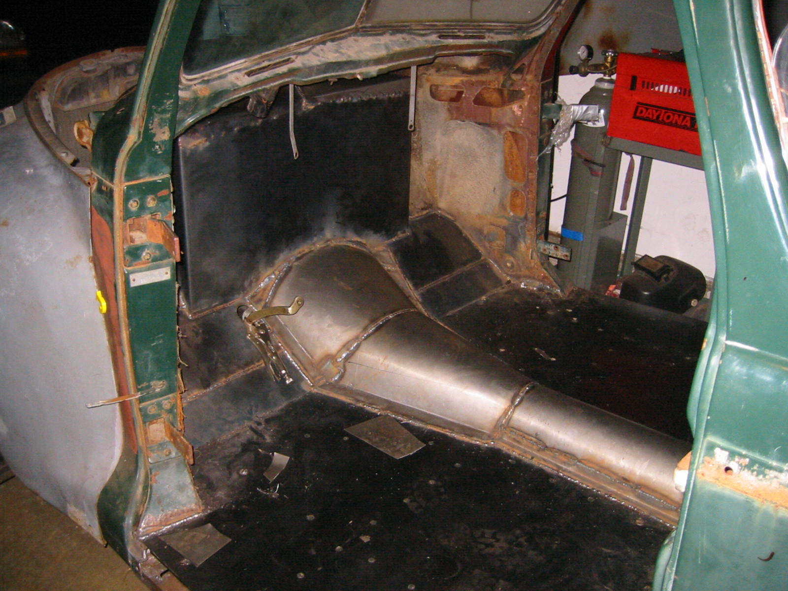

    Hello All, I don't post a lot but I want to share my build. 47 Plym coupe I got as a 1/4 finished project from someone who lost interest. Floors and rockers were gone, Trunk floor gone and missing some odds and ends. I don't have any pictures of when I got it but some mid way through. The subframe is a 71 Firebird done by a friend 20 years ago. Been accumilating parts since I got it back 12 years ago. First picture is when the floors and rockers were cut out..... Second picture is the firewall comming back 4 inches. Next is the completed floors. Decided it needed a little more wheel clearance so I cut out the rear inner fenders and added 6 inches of room :D There is a picture of the set up Hemi but I do have a built one going in there now. More to come later. Thanks for looking.

    Ok, decided I didn't want the 700r4 so I am running a 518 o/d. Man that transmission is looooong. I also didn't like the motor mounts I built or where the engine is placed so I'm moving it foward 2 inches and up 1 inch for steering clearance. Already offset 1 inch to the pass side. I also put the built engine in this time to mock up the motor mounts and for a little inspiration. I need all I can get because I don't want this project sitting any longer. Pictures to follow soon.

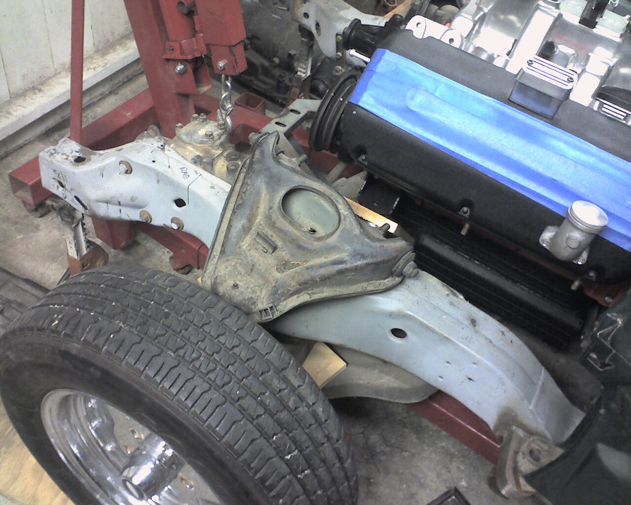

    Ok, here are some pictures of the install as promised. I couldn't have done it without my helper!!! Third generation hotrodder. Although my pop has gone to the billet streetrod dark side.

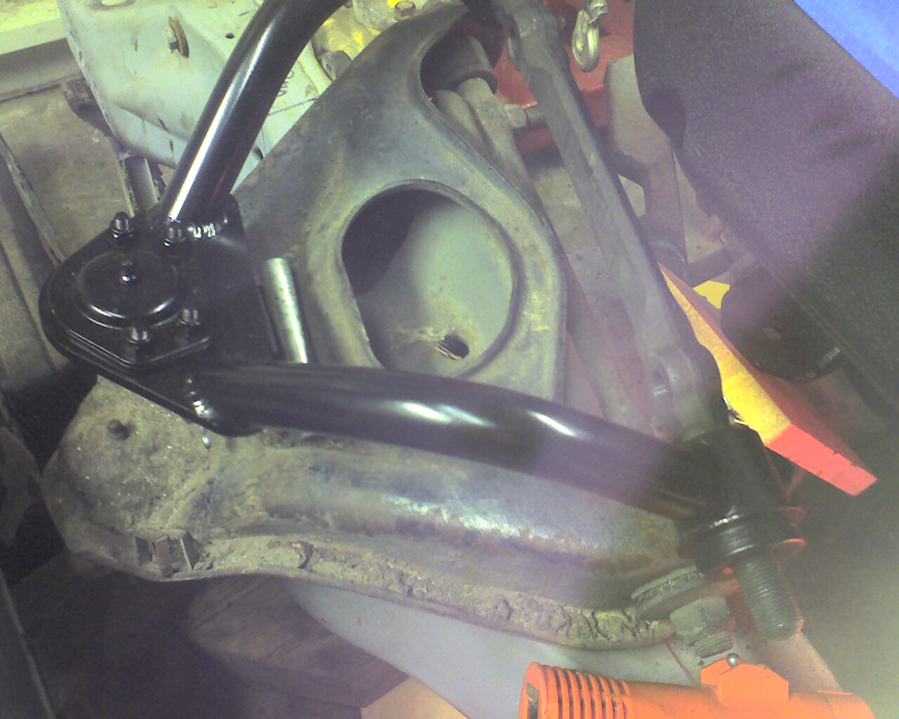

    And some more.......... This really motivated me to get going on this. Just seeing it is there shining like a diamond in a goat's ass. Only 1 blued finger too!:D As you can see from the second to last picture, the wheels are a little out but thats with no alignment shims so the camber is wayyyy out on top making it look worse than it really is. I also shot a picture of the Fatman narrow upper control arms.

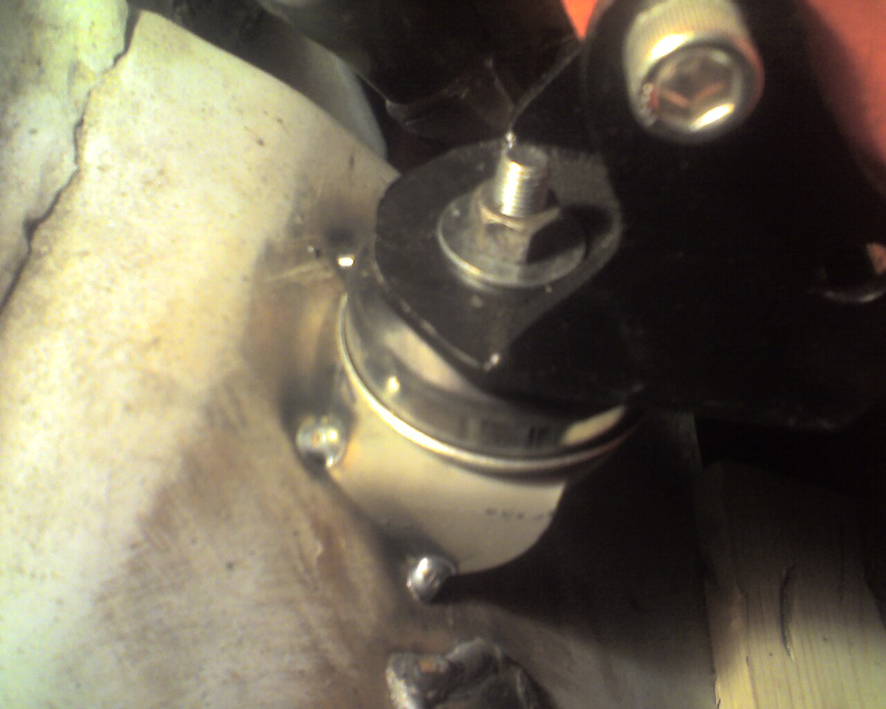

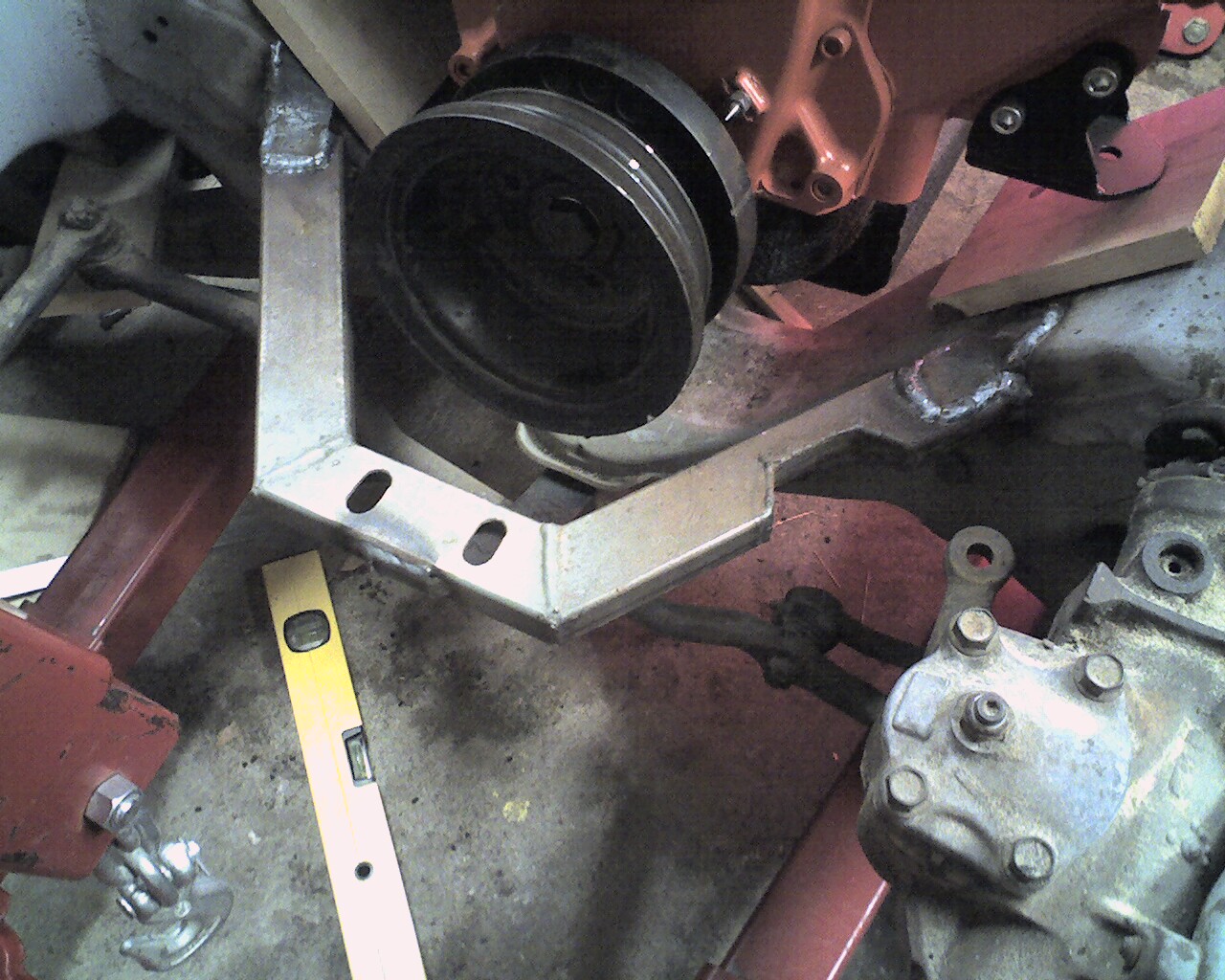

    Ok, got the motor mounts tacked in tonight. Here are a couple of picts.

    Ok, got the transmission mount almost finished. I was able to use the mount I made for the 700r4. Just had to modify it a little. I'm not too sure I like how the Impala trans crossmember looks but the way it kicks up, clears my master cylinder. Exhaust will not be an issue as it is going to run outside the frame rails. Spent a lot of time measuring today to make sure it is in there straight. Good news is I won't have to cut very much of my floors. I will attach pictures soon.

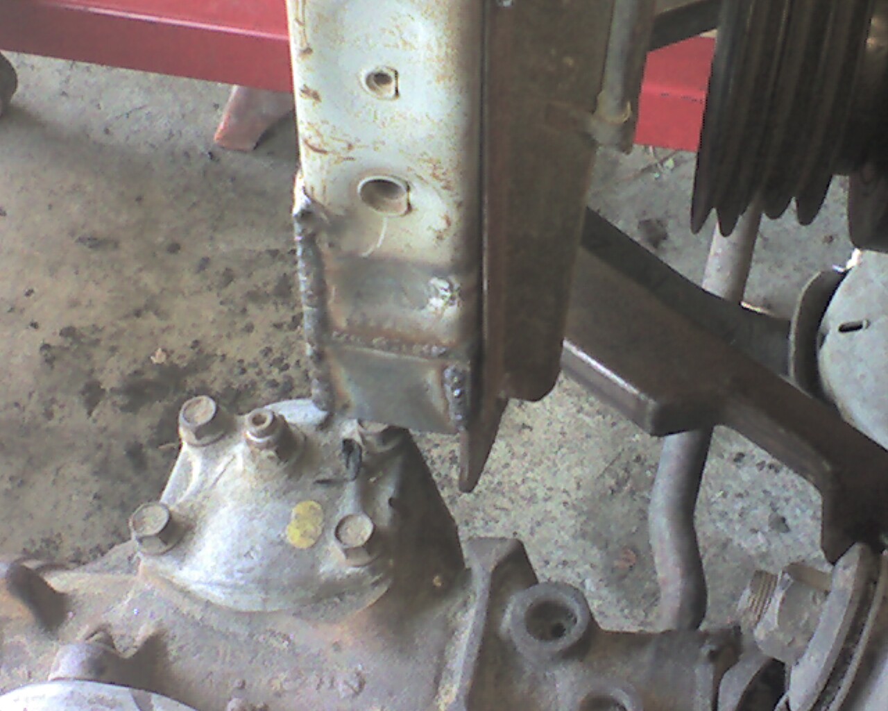

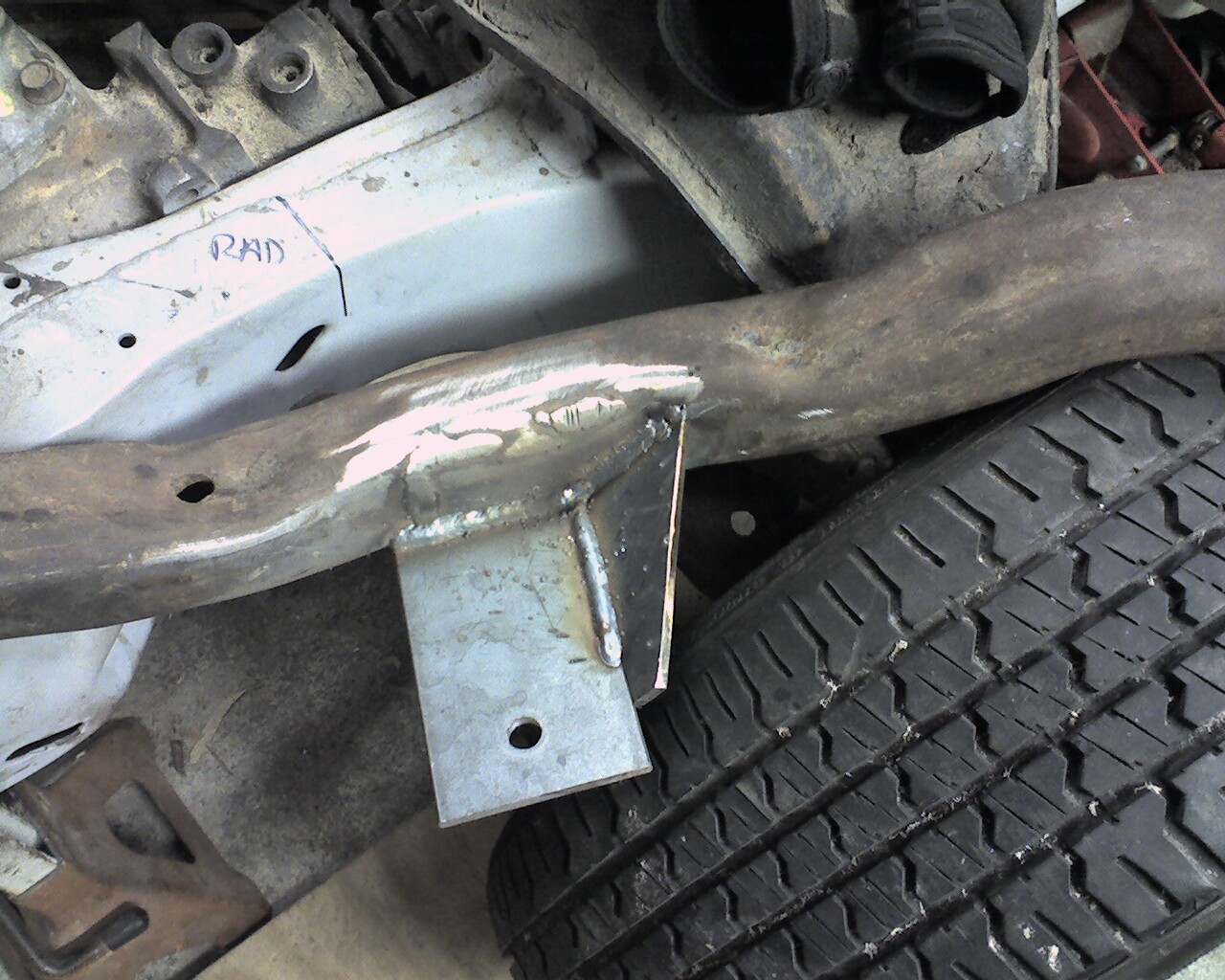

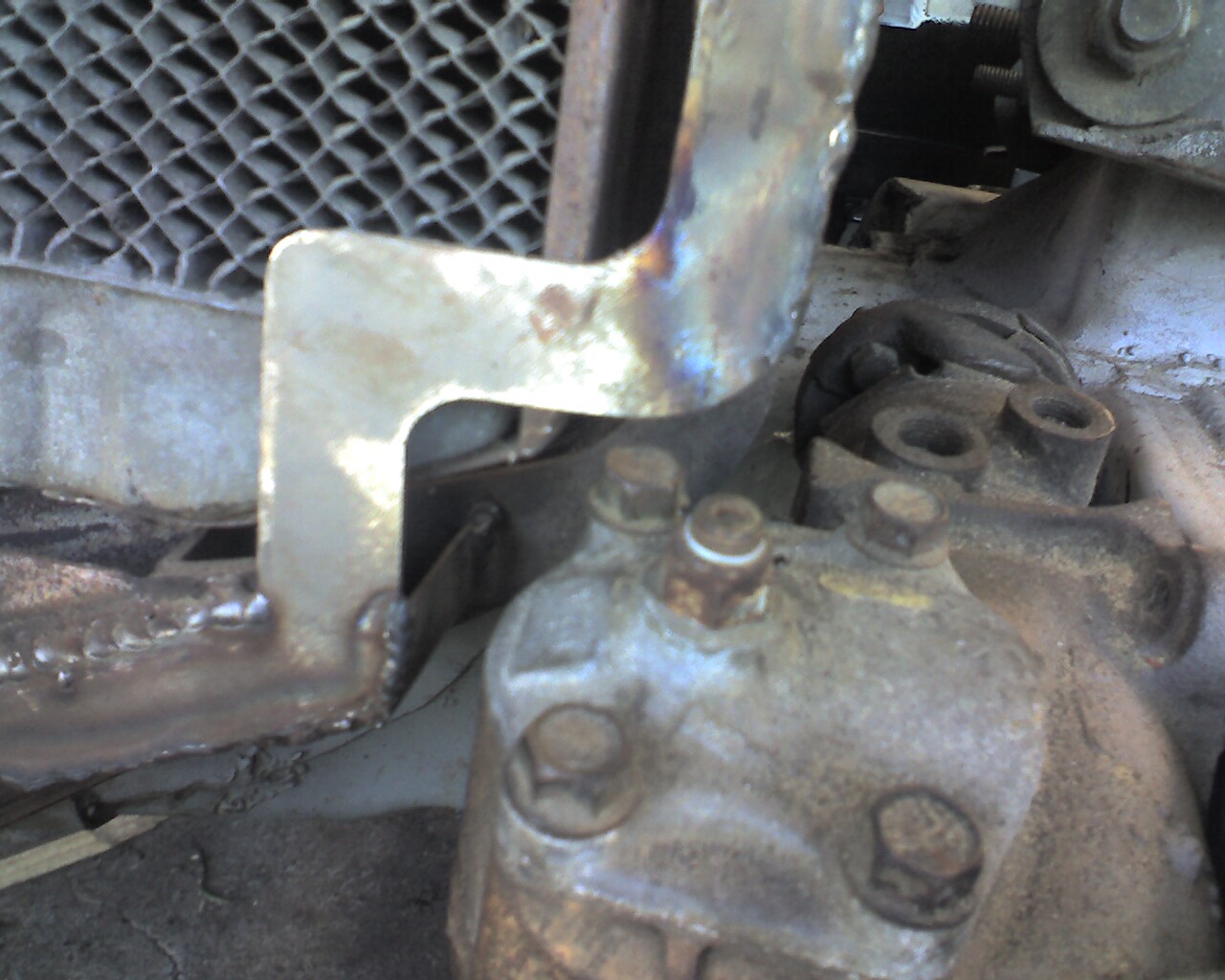

    Here is how I did the radiator support. I wanted to make sure the steering box was serviceable without pulling the front end apart. I took a couple of close-ups.
