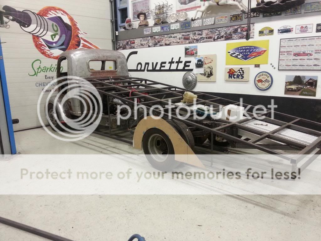

  12. progress of tonight
    made a roller to make a radius in the square tube for the wheel opening
    my cardboard fender :)

  14. thanks :) well its getting shape soon i should have the american oak for the bed. and a little more bracing to do and then i can start covering the side's up with stainless steel sheet metal

    :)Why use oak.?:confused:There is a lot of upkeep with that. :(Deck plate is used on all American Car h[​IMG]aulers. Also wood will prolly be x2 the weight.

  21. Like said oak looks better, i dont like the daimond plate it looks to modern

  24. the truck will be stored inside when its done
    so i am not to afraid of the elements hurting the wood. :)
    well got a little more done tonight made about 60 cuts (agian...... ):eek:
    to make another radius for the lower corners
    and its getting shape

    How did you make the round corners? I think I saw a plasma cutter, but those didn't look like the kind of cuts a plasma cutter makes. Must be a grinder. Then you bend it and weld it together again? Must be very laborious to get such a consistent bend. Each time you weld it will want to twist and straighten out again.
    Sent from my Verizon 4G LTE smartphone
  28. made the cuts with a cold saw and then used a strap to hold it in place
    and weld it
    and it didnt twist during welding :)
