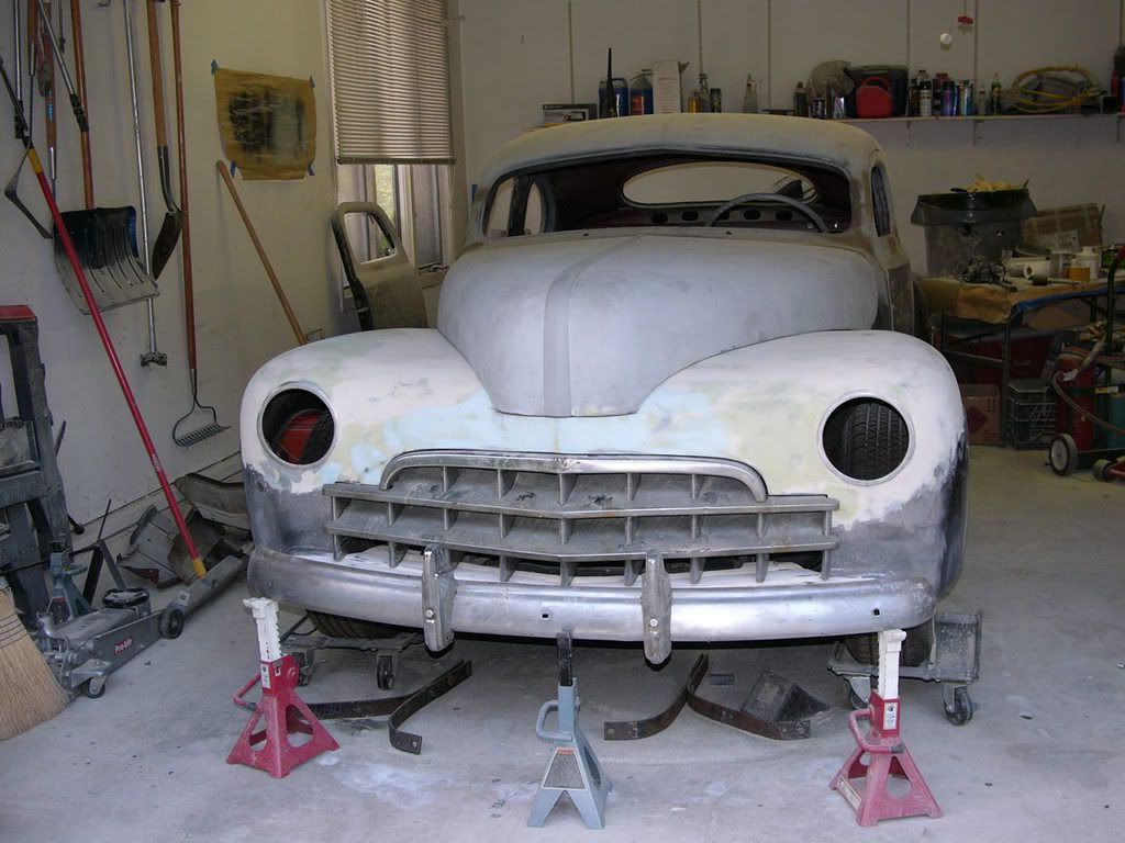

    Been working very hard on the grill area of my car. Im taking this week off of work, so I should have all of the little things worked out, and maybe the entire car primed in one color by the end of the week.

  3. I think that's a 48 Caddy grille.. but you probably meant 47 ford right?

    Yea, the ford is a 47, the grill is a 48.

    at first when i looked at your pics, i thought you had the car on jackstands on the front bumper!!!!,,,hahah,,,upon closer inspection, i can see that its just holding the bumper in "mock-up" position

    You dont like the different colors? It looks like rainbow sherbert! I think I'll prefer when its all grey primer!
    Now everyone can easily see how much of a bondo hack I am! The grill area has a skim coat (some places probably reach 1/4") all over!
    Have you tried the new Evercoat Quantum? I roughed out in rage gold, then skimmed lightly in the quantum filler (red hardener), followed by a little touchup with the Quantum Glaze (blue hardener). This stuff spreads really smooth, and sands SO nice.

    Its pricey stuff, but its really awesome. I like evercoat "easy sand" glaze as well, but this quantum stuff is great.
    The biggest thing going for the quantum glaze is how it spreads, it has a much "creamier" consistency than the other fillers, and it seems to have a longer work period, and it doesnt "pull" when you run the spreader over it several times.
  14. The car looks incredible. That grill looks like it was made for that car.
    The two hardeners for Quantum are for different cure rates. It allows you to retain similar work times over varying tempuratures or give yourself more work time if needed without having to vary the amount of hardener being used. They also have some epoxy in them so they have increased corrosion resistance as well. They will pass the OEM 500 hour salt spray test.

    I have both hardners, and have found that the red leaves somewhat of a sticky top layer. A friend of mine who's a pro bodyman has had the same results. He's gone to just the blue, and used a bit less when needed.
    Regardless, nothing sands like the Quantum products.
  16. Lookin good as usual Chad! That grille was on my list, but I decided to give a nod to Winfield w/ the Olds grille. You can't beat the Cad grille for that heavy, early custom look. Can't wait to see it all one color. I will be in your neck of the woods next month and would love to come by and check it out.
    D.
  17. What is the temp like where you are working? It may not be completely curing. The break point for temp on the hardners is 80 degrees so the red is ideal suited for Temps above that. Also have to make sure you use the right amount of hardener. It is a 10:1 mix ration rather than 50:1 like traditional fillers and putties so you need to use way more hardener. If you are still having problems let me know I can look into it for you. You can mix the hardeners as well if you need more work time from the blue.

    The gap between the rim and fender is very slight. Some do it with a strip of sheetmetal, 50 years ago it would have been done in lead. Mine is filled in with Duraglass after the rim was fully welded to the body. The material reaches a max thickness of about 3/8 maybe in a few spots. As long as you have the metal perfectly clean, and sanded with 36 grit, that duraglass is not going anywhere.
