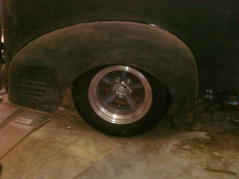

    got some new wheels.
    This ones blurry but the lip is pretty deep. I might have to move my fenders out a little to clear the tires. I wish the offset was a 1/2" more on the backspacing but i think for the price they were pretty good.
    I wish the front layed this low. oh well.
