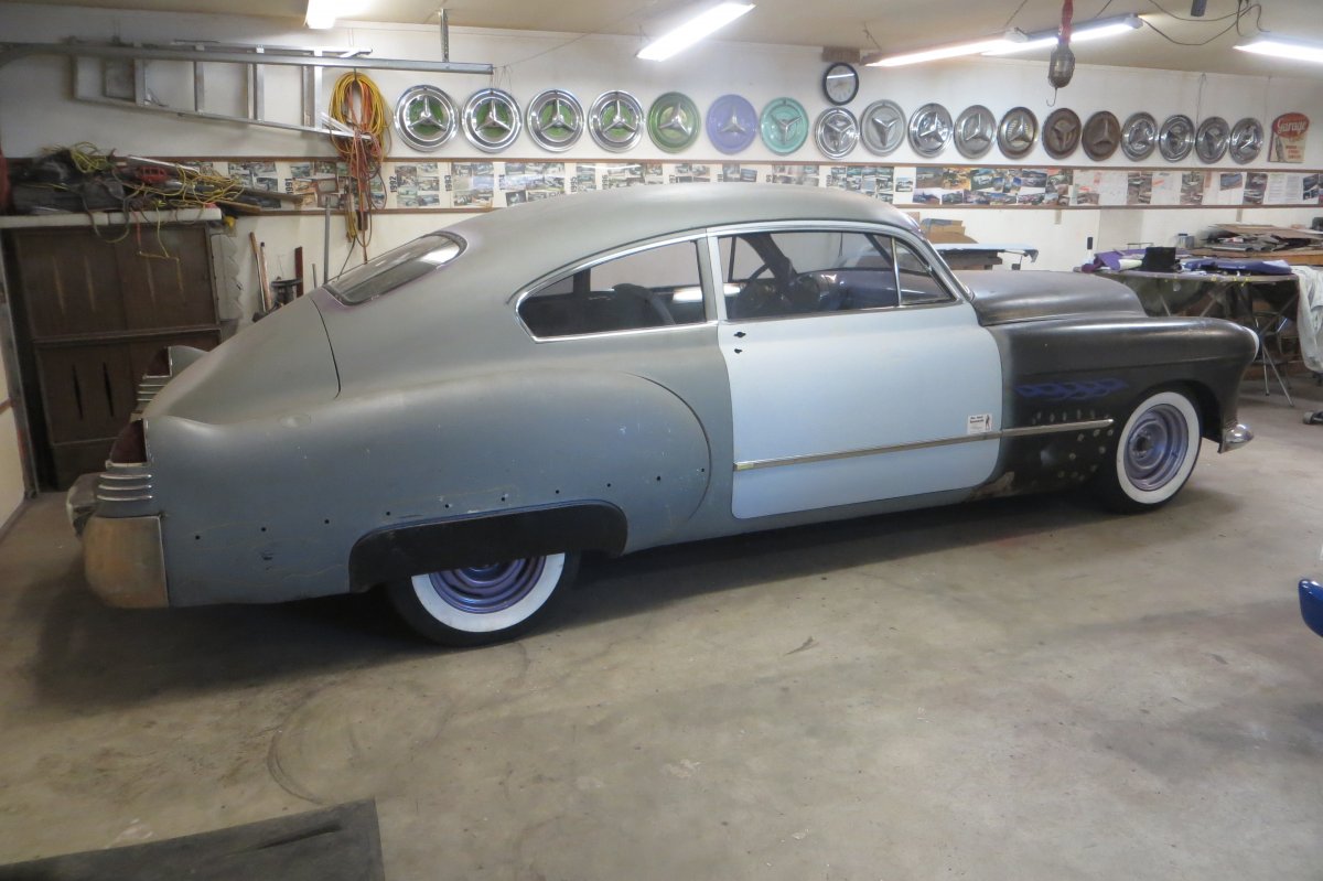

  20. A few Wednesdays have rolled by… moving on with the rocker panels and lake pipes.
    I trimmed out the bottom front section of the rear fender.
    I mocked up a paper sample of the rocker design…. Help the guys see what I was visioning in my head! Also helped me fine tune the measurements for a better fit.
    Basically, I’m frenching the lake pipes into the new rocker panels. The pipes will come out of a larger pipe that will be molded into the bottom of the fender/door pod. It’s an old custom style that I always like on a lot of merc sleds… only difference is I’m setting the pipe back into the rocker panel.
    Transfer the layout onto sheet metal.
    The guys helped cut out some of the pieces…
    Created the center sections first…
    Folded the bottom section of the rocker. Thanks to Rooman for letting me use his longer brake…
    Started welding the sections together…
    Have to modify the rocker design to conform around the front A plier body mount.
    Ron started prepping the metal on the inside of the body so it’s ready to weld the new rocker in place.
