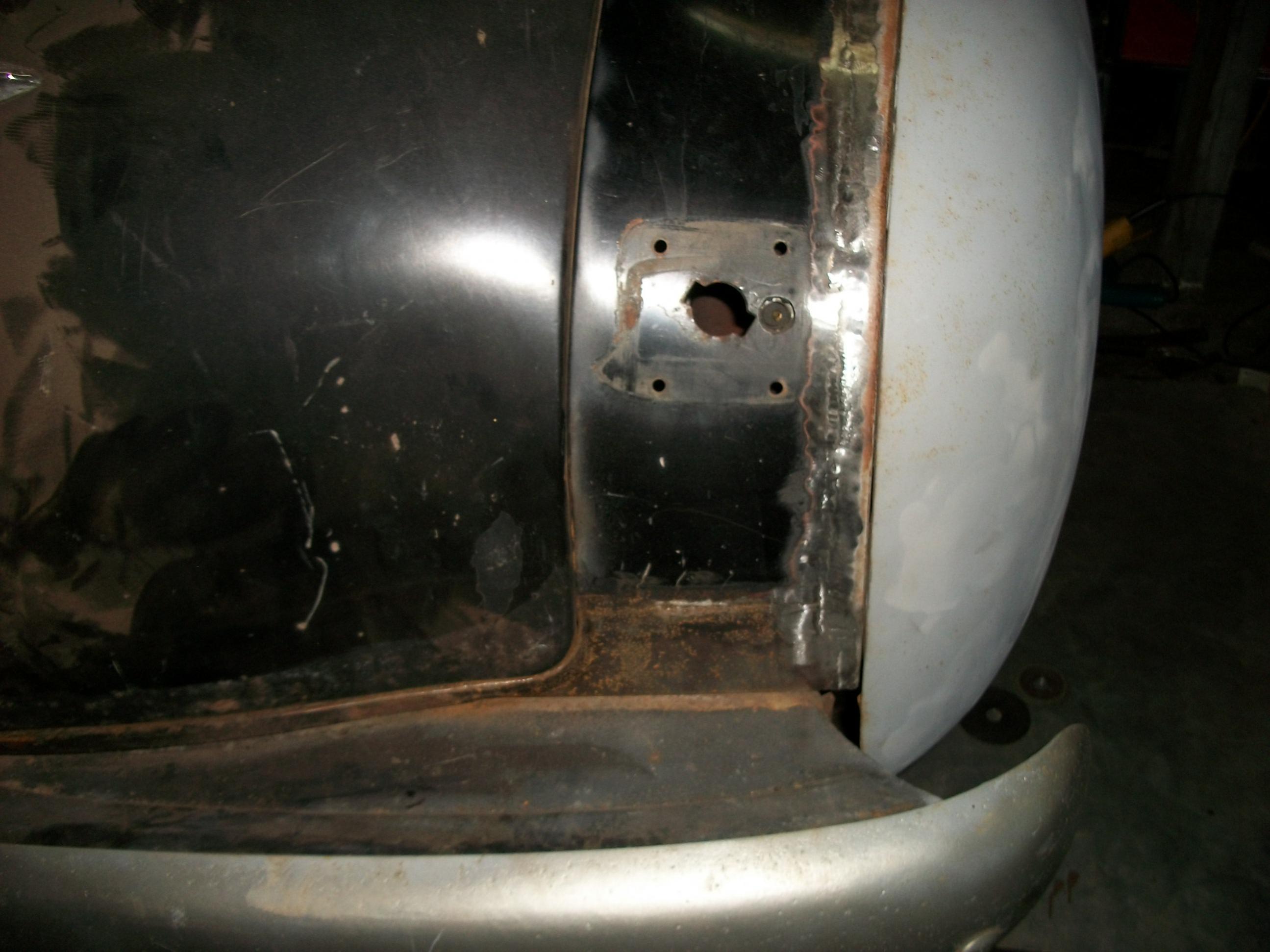

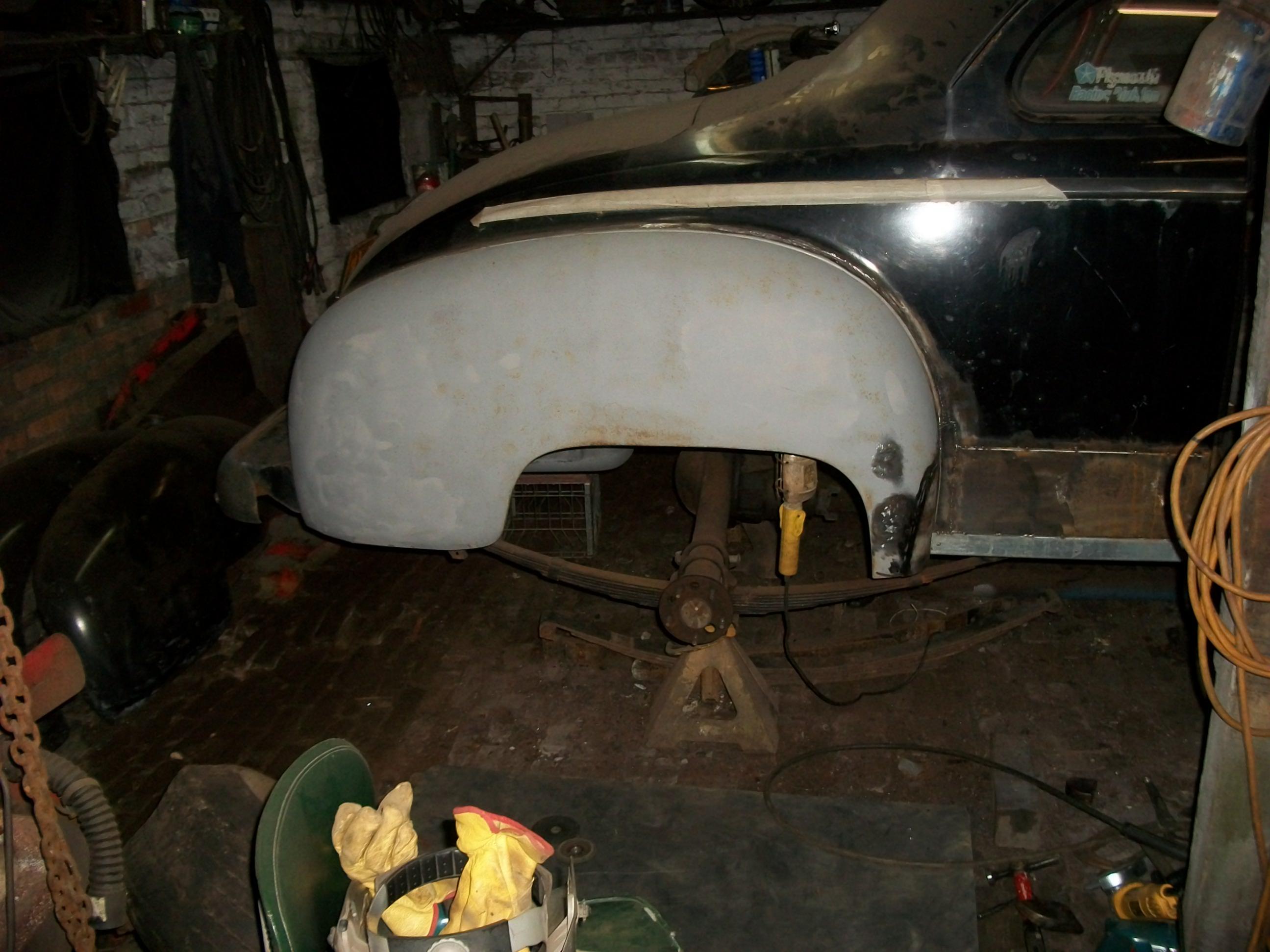

    Little update:
    Corner getting patched up
    Inner quarter panel all prepped to be welded in (sorry it's a little blurry)
    Finally something solid to hang the rear fender on
    Had to modify the bottom of the fender to fit the modified body

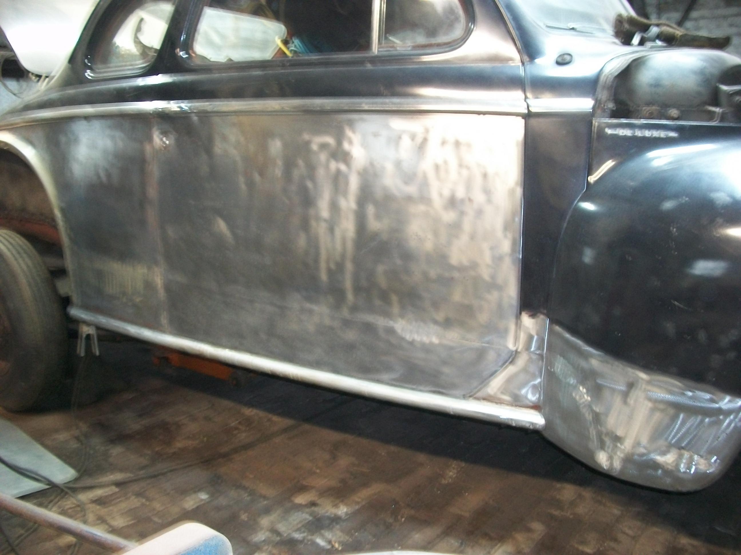

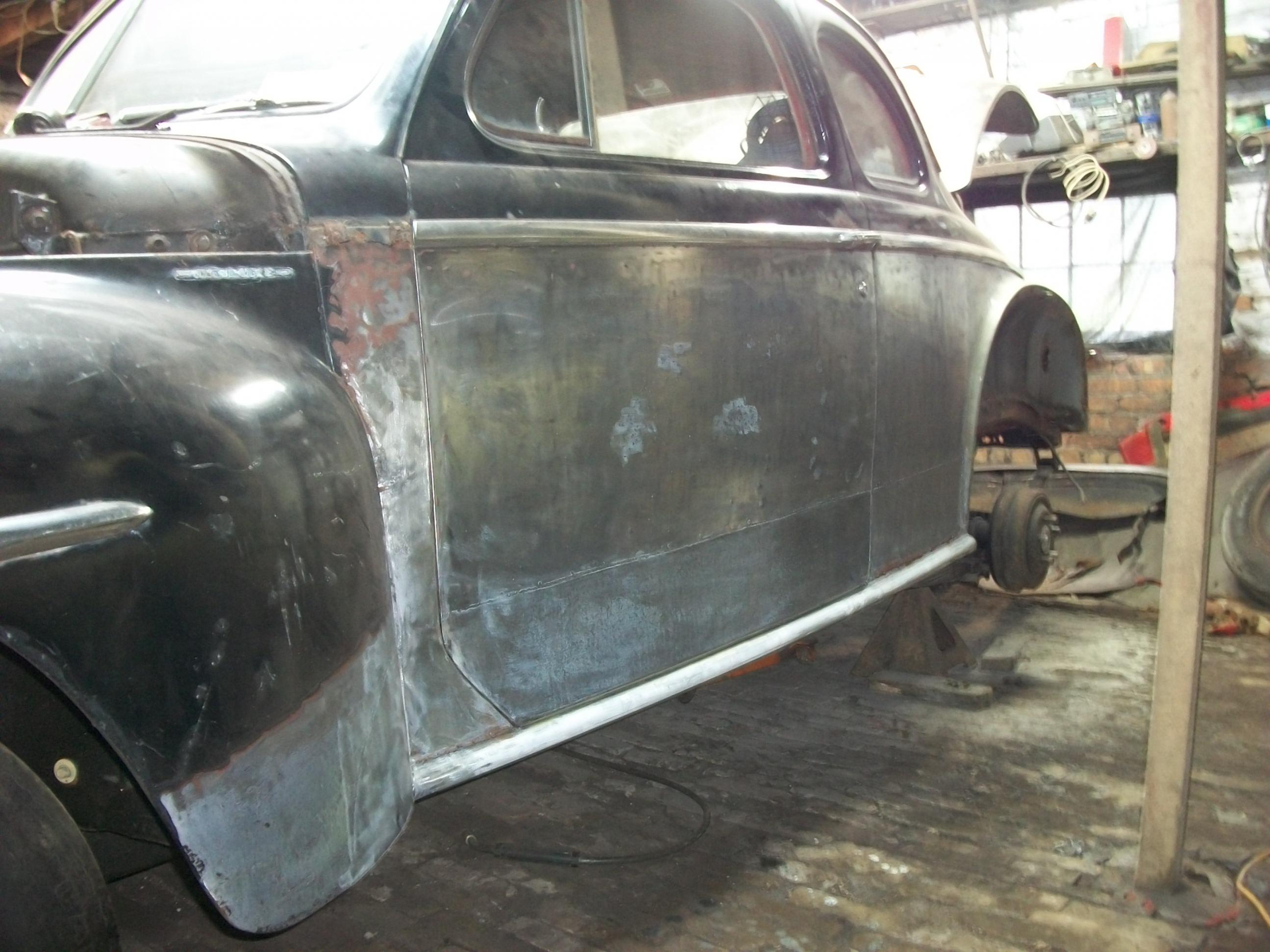

    We all like bare metal pics right?
    Even blurry ones (I'm a car guy not a photographer)
    It doesn't look all that bad with the bottom cut off does it?

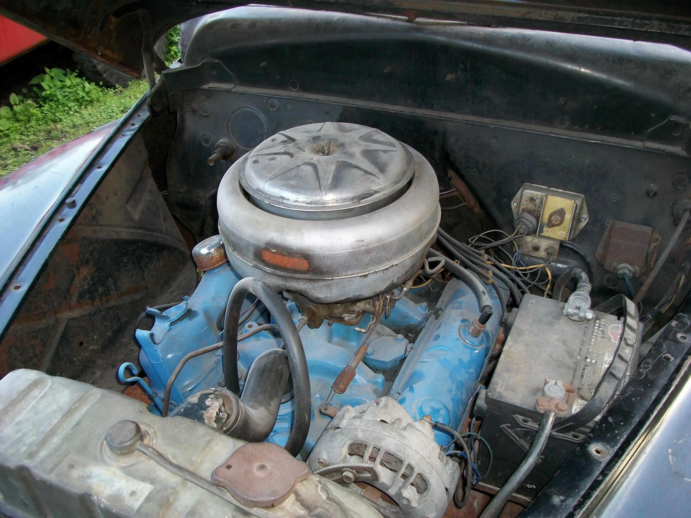

    Gotta tidy up the wiring still and get rid of the silver paint on the air cleaner

    The air cleaner cost me 20 bucks and does a good job at making the 318 look a little less out of place. Need to paint it black though.

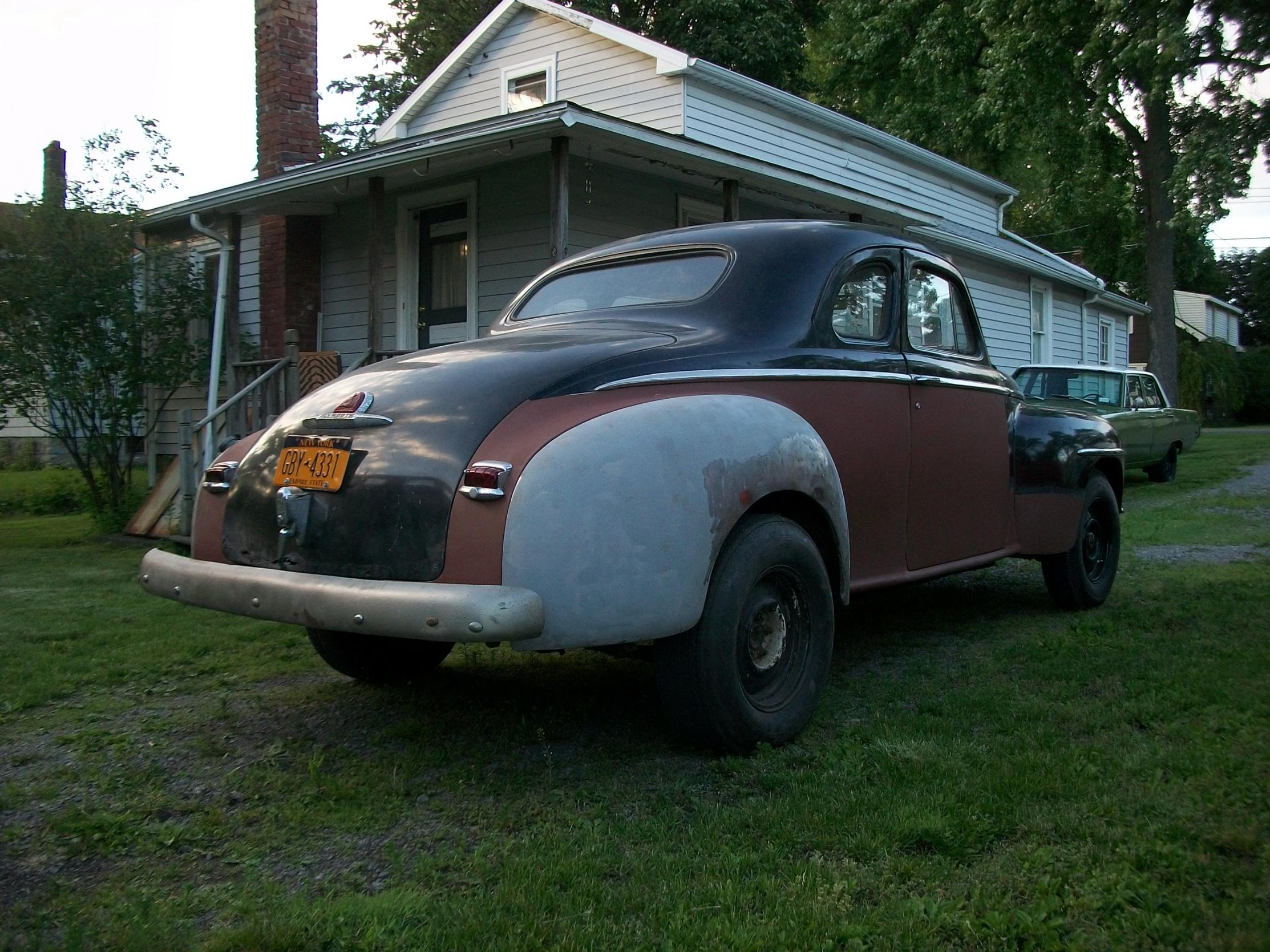

    Here it is with some paint on it, haven't painted the rear fenders yet planning on some bigger tires (pie crust slicks) in the back so I might have to open the fenders up a bit more.
    Got rid of that nasty silver paint on the air cleaner and wrapped up the wiring harness.
    If all goes well this winter I'll be dropping a nice 360 into it and building a set of fenderwell headers for it. stay tuned.....

    Most of these late 40's/early 50's Mopars I've seen with the smallblock in them have moved the motor off to one side for steering box clearance, but I see you've recessed the box in the frame an inch? Have you got any new pics of how that looks? Were you able to center the motor or is it still offset to the right? I was going to suggest black wrinkle finish for the air cleaner, but I see you've already painted it. Looks good too!
  29. daliant
    Joined: Nov 25, 2009
    Posts: 700
    daliant
    Don't have any recent pics, camera needs batteries. The engine is offset to the right by about 1 1/2" which is typical on these cars with a small block mopar engine and stock chassis/steering box. I wasn't too concerned about the engine not being centered, every mopar built during the muscle car era has the engine offset to the right for steering box clearance, it's not really noticeable unless your looking for it. By moving the steering box over it just made more room between the exhaust ports on the head and the steering column. I eventually want to build a set of headers for this car and I wanted as much room as possible for the tubes, especially the rear port on the drivers side which points right at the steering column.
