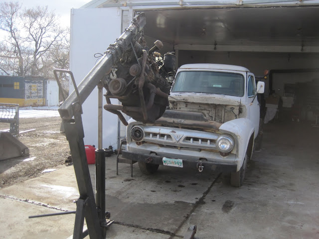

    After a winter looking for a 46ish block to replace my original, I found a running 53 to put in until I can find a good 46 blcok...

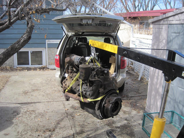

    The donor...
    Brought home in the mini-van....Not having a truck SUCKS!

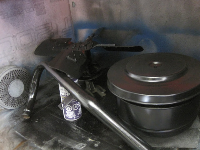

    She goes together this weekend....:D

    All you need now are the correct water pumps?.Looks good all painted up & to nice to get it all dirty again?,LOL.

    Looks like the oil block got frozen.

    Yep - but it didn't show for an entire summer. Guess it widened while sitting over the winter....
    I'll have the donor '53 in until I can mag the 46 block I found and get 'er all together. It'll be good to have a spare.
