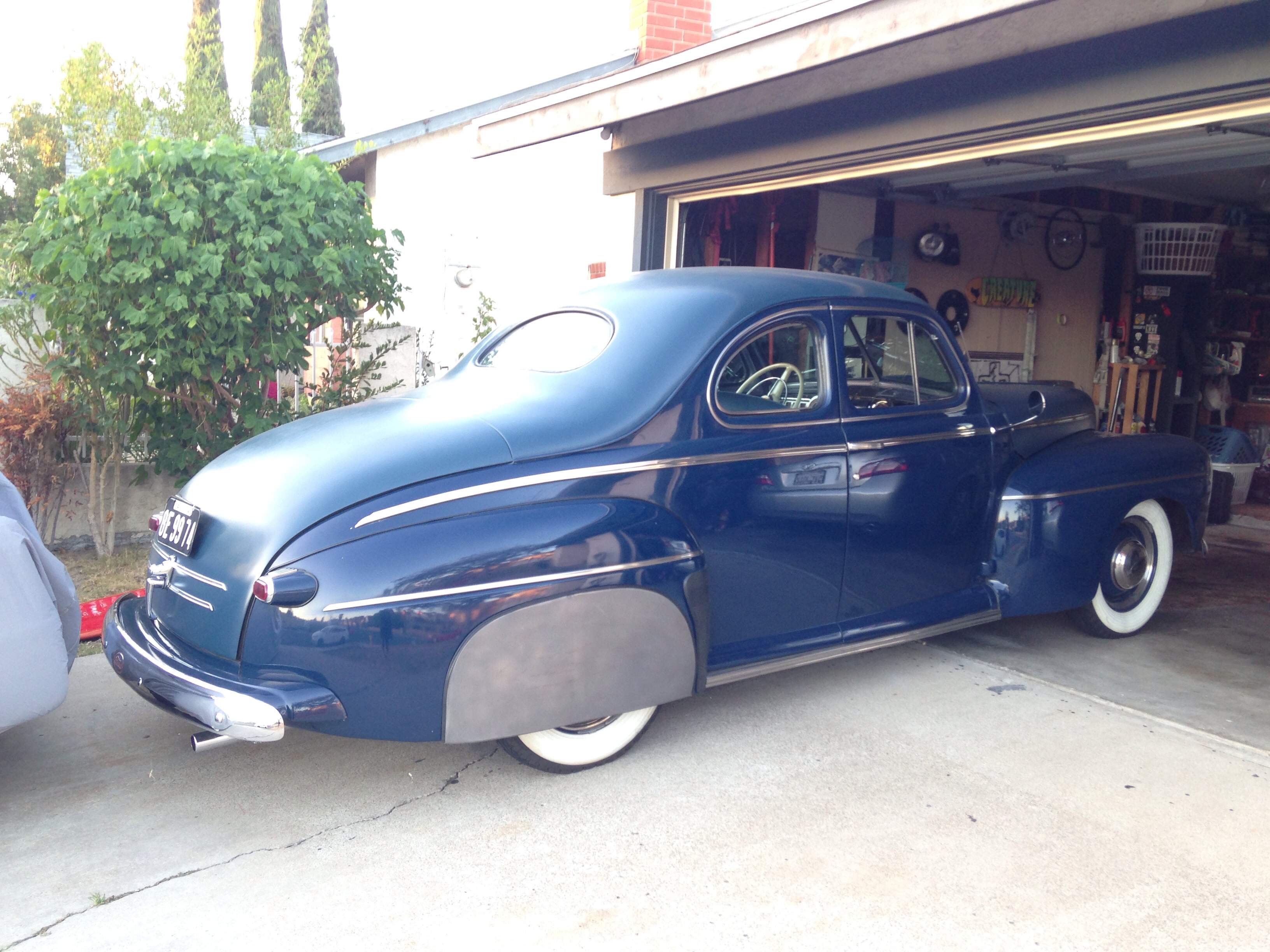

    image.jpg Here's my 46.....
    Great looking project man. Love the chop and stance. How long are the shackles you made? I also made some to lower it, added skirts, but feel like I should lower the rear more.

    Thats a good looking short door! I cant remeber off hand how long i made the shackles... i should be pulling the rearend soon to finish everything up. I'll post pictures when i do.
