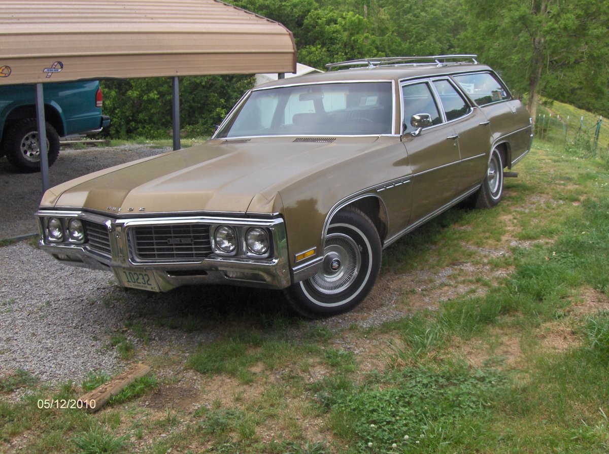

  7. 410 mer. I had one in this one .Man it would leave everyone just sitting at the stop light .She was a real sleeper but man, sucked the gas but she was fun. Bruce. Justin012.JPG
    410merc likes this.

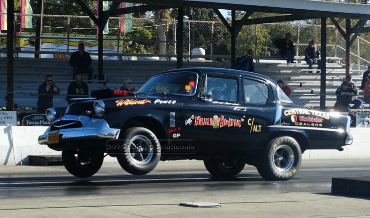

    I've got a 430 Buick in my 55' stude. Goes 11.70's, I shift it at 5000, goes through the traps at 5400. 3.73 rear. Weighs almost the same as a small block Chevy. Torque by the ton. They're only as ugly as you make them look. Oiling can be a problem, do the mods and they will live. I drag race the snot out of mine. Motor has been in the car for 19 yrs. They don't rev like a small block, you just gear it right and hang on Go to v8 Buick.com. Everything you need to know is there. IMG_20160407_033637.jpg day-of-the-drags-2014-texas058.jpg

    I have seen this Stude run at Little River Dragstrip. It hauls ass.
