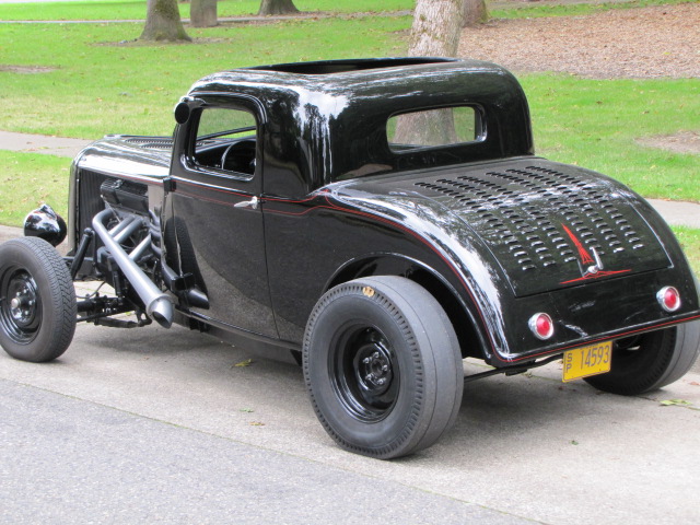

  18. frankinplymouth
    Joined: Sep 6, 2008
    Posts: 358
    frankinplymouth
    Theyt all should have 440's............mine
      144.7 KB
      97
  19. OldBlueOval
    Joined: Jan 10, 2006
    Posts: 197
    OldBlueOval
    from Upstate NY
    your car is awesome!!
