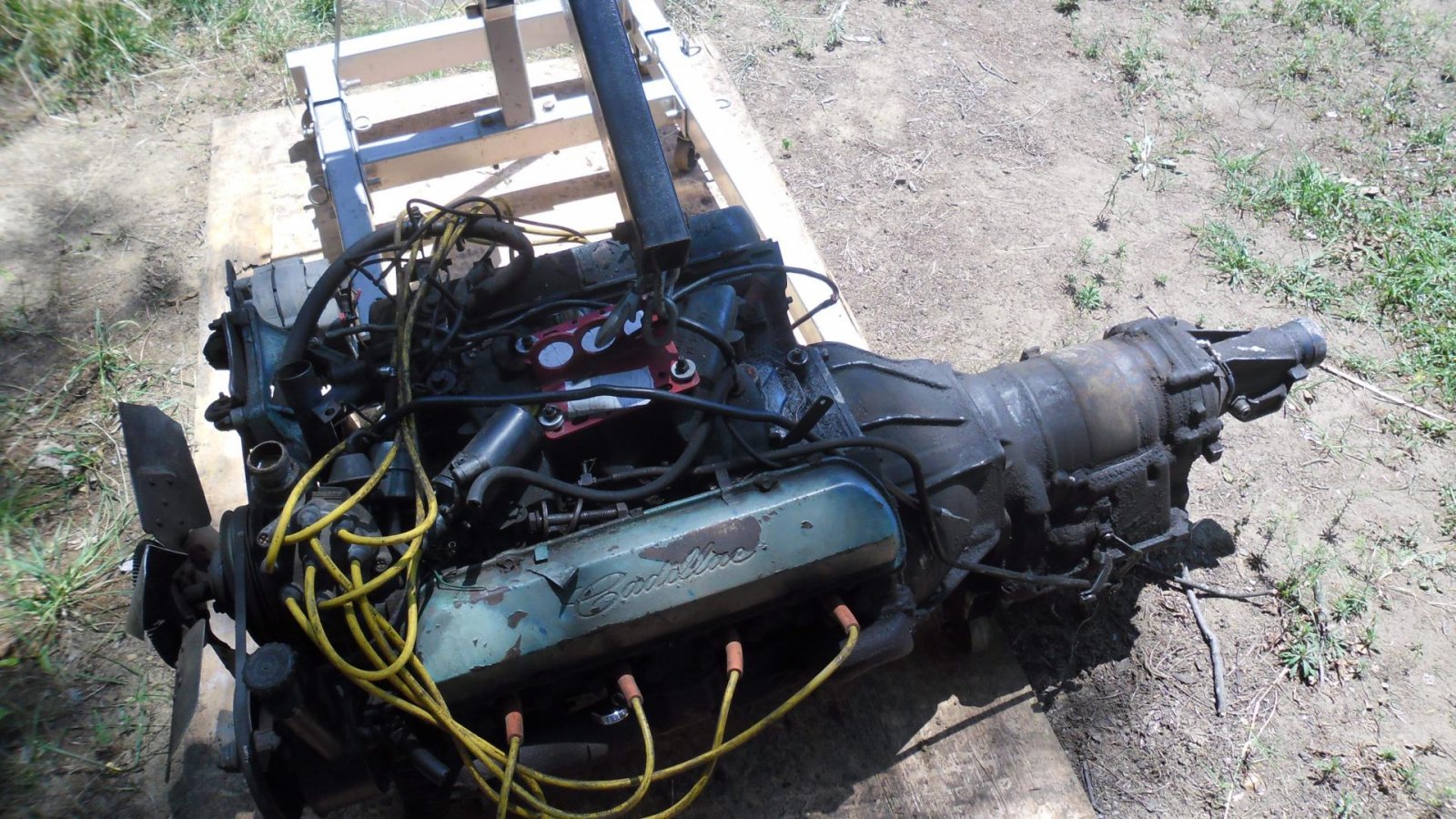

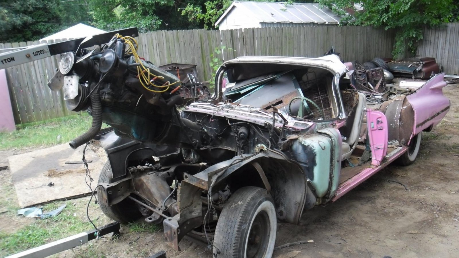

    vince89, your 429 will drop directly into place in your 58. you will not have to change anything, nor do any cutting. I though the 429 was gonna be a hassle when I was putting one into a 59 some years prior. it wound up fitting exactly like the 390. unlike the 472 and 500, the oil pump/filter, tucks up against the block, it doesn't not stick out. look at the pictures below
