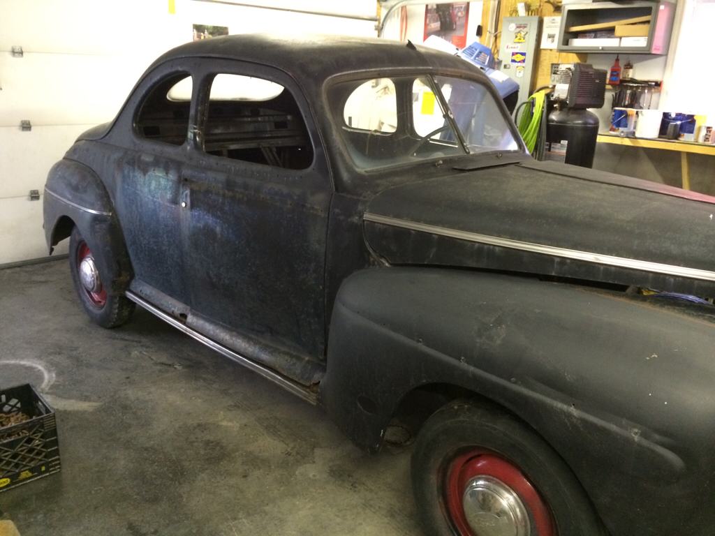

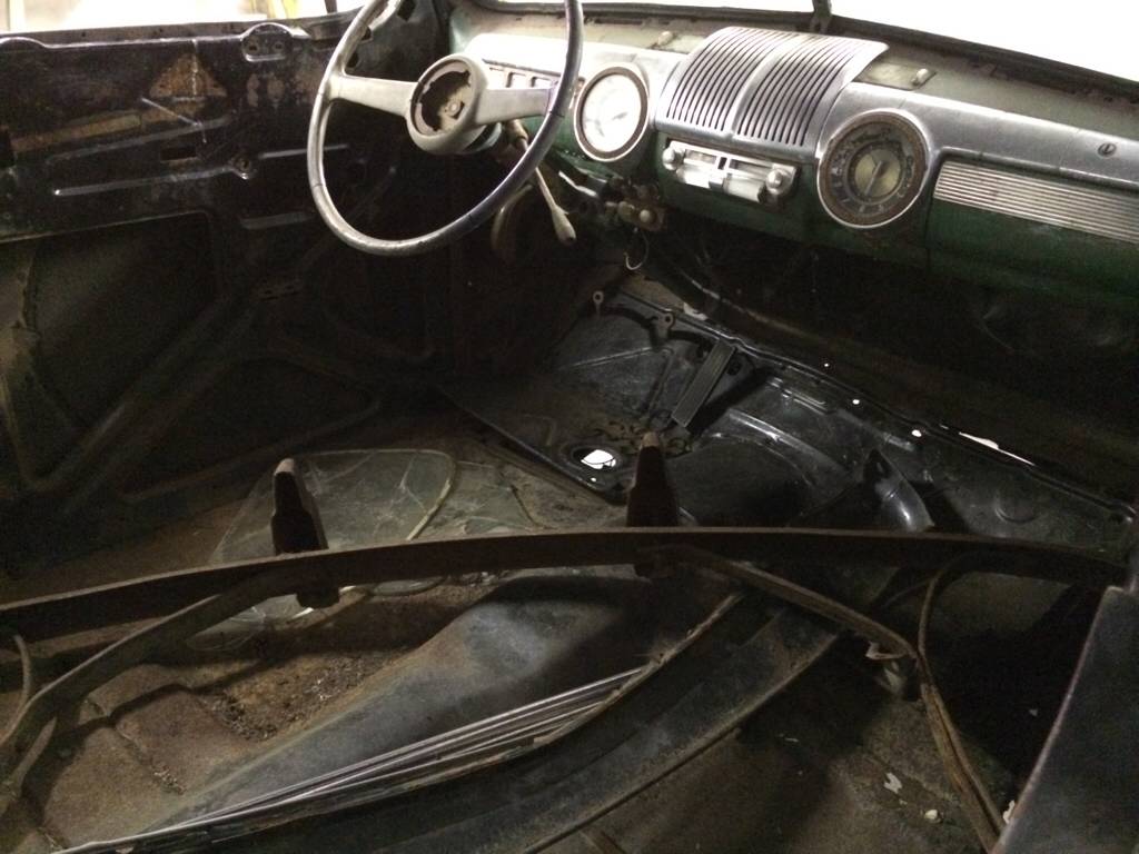

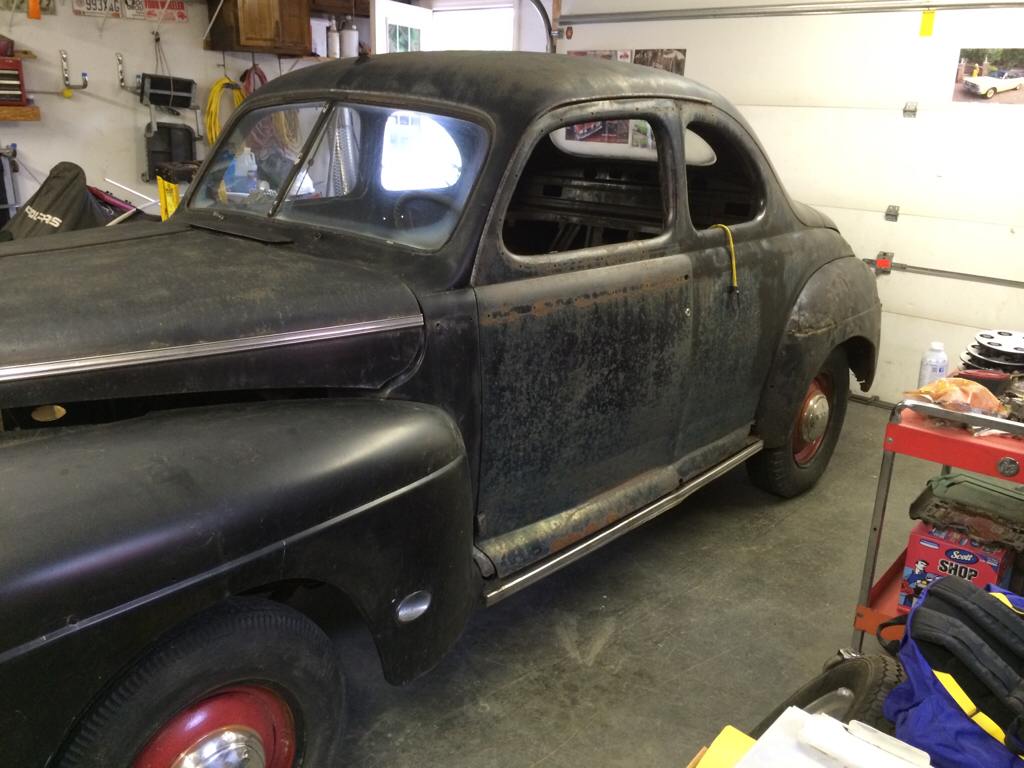

    ImageUploadedByH.A.M.B.1402689698.560771.jpg ImageUploadedByH.A.M.B.1402689720.862299.jpg ImageUploadedByH.A.M.B.1402689739.682469.jpg
    Here's a few pics, I've been looking for a couple of years for one.
    slayer, aussie57wag and Model T1 like this.

    nice project what are your plans for engine

    Looks pretty solid for a Vermont car.

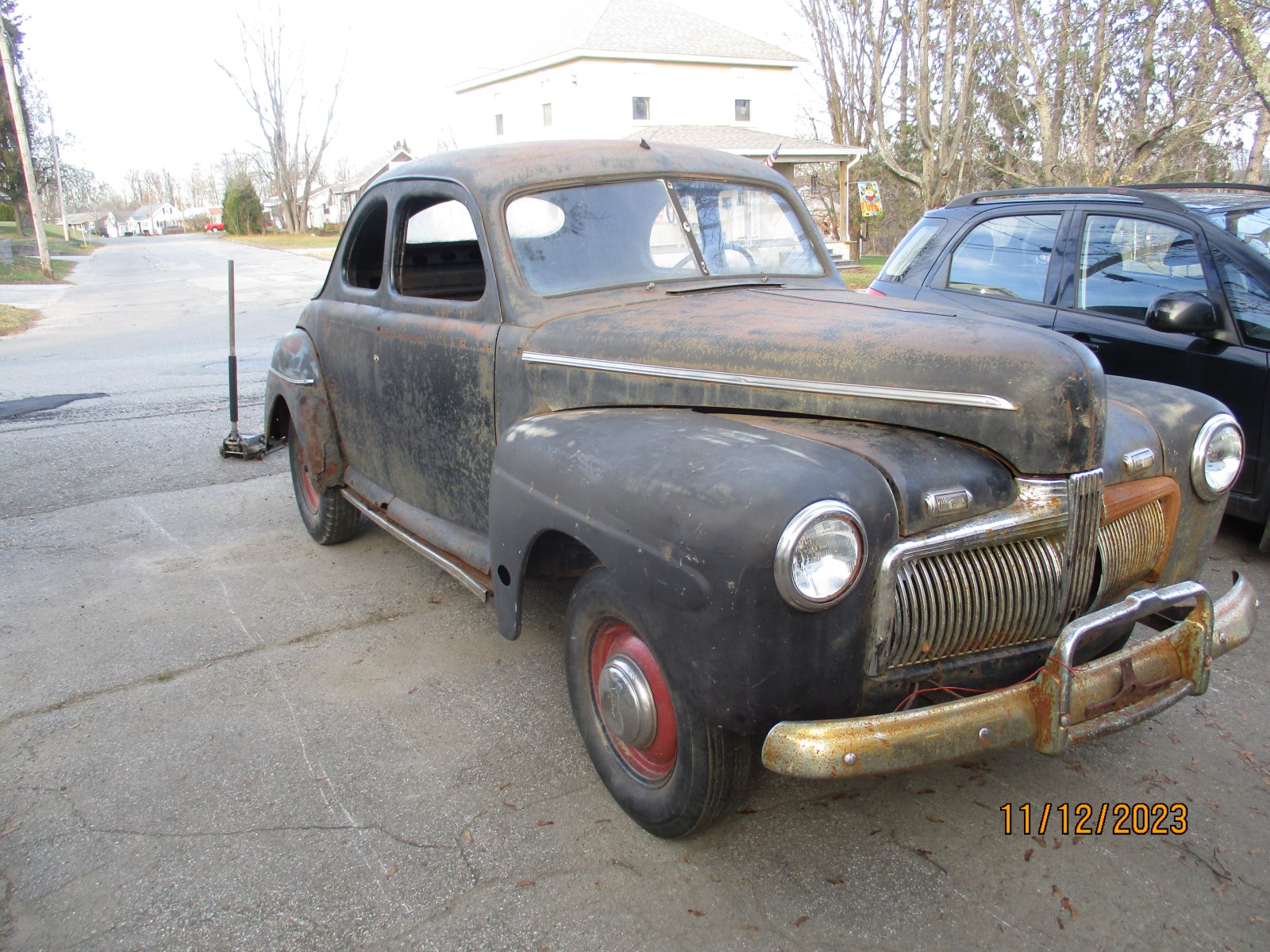

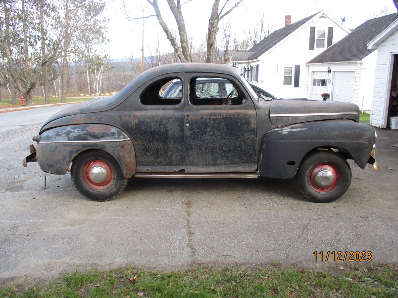

    Hello from northern N.H. I just bought a 42 coupe and was checking out this forum for some information and inspiration. To my surprise it seems that my car is this car that vtmopar once owned. It is in the same condition as it was in 2014 and I'm wondering what ended this build. the author of this post hasn't been active on this forum in sometime. Anyone know the story ?
    lothiandon1940 likes this.

    When one dream ends another begins. The prior owner started out very enthusiastic and it appears in 9 years nothing ever was started……..Good luck with your project.
    Packrat and lothiandon1940 like this.
