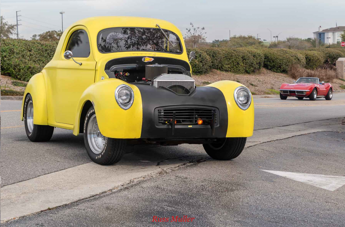

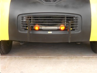

    I have a 41' f'glass Willys sitting on an S-10 chassis that I made a set of front Nerf bars (And grille). Anyway, I'd like to do the same on the rear but it's a bit more involved... Anyone done it?
    Not much traveling space for clothes or tools and would like to hook-up a receiver hitch & attach an Army style foot locker arrangement to carry my stuff... Ideas? upload_2019-3-5_6-41-38.png upload_2019-3-5_6-40-39.png
