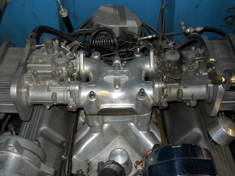

  5. jan bogert
    Joined: Jul 11, 2011
    Posts: 655
    jan bogert
    heres the motor a 350 chevy with this unusual set-up. its two side draft mikunie carbs. this is the first I seen this . I want to keep it on, but I don't know to much about these carbs,niether did the previous owner he had 9lbs of fuel pressure, the idle set screw was all the way out, and the idle mixture screws were at 5 turns out. I need to find more about these carbs., don't want to go with a four barrel that everyone has.
  6. big duece
    Joined: Jul 28, 2008
    Posts: 6,830
    big duece
    from kansas
    Go with the 4 barrel; for now. Send those off to Jim Inglese in CT., he will make them run like a top. There is a science to setting those up, and he knows how they work better than anyone. I can tell you right off 9 psi. is way too much. Idle mixture settings sound way off too. Might need closer to 2.5-3 psi. for fuel.

    That carb setup looks like a major headache. If it was a reliable, efficient setup they would be more commonly used.
  8. Cool looking set up but looks like a head ache to toon !! I would swap out for a 4 barrel and go from there . At least you can hopefully fine your problem! Good luck

    so today I changed the base gasket on the B&M blower thinking it was bad and loosing vacume. well it wasn't that, and I then went out and bought a edelbrock 1406 four barrel. tomarow i'll install it, hope that's the fix.

    Are the pipes black? Could rule of if its running rich or not. Does the dist. have vac. advance, its hard to tell in the pic. Check vac. source to it, if it does have one.

    vac. ad. is hooked up. I got the carb the best I could took it out today, takes the throttle ok, but at stops it wants to stumble and stall
