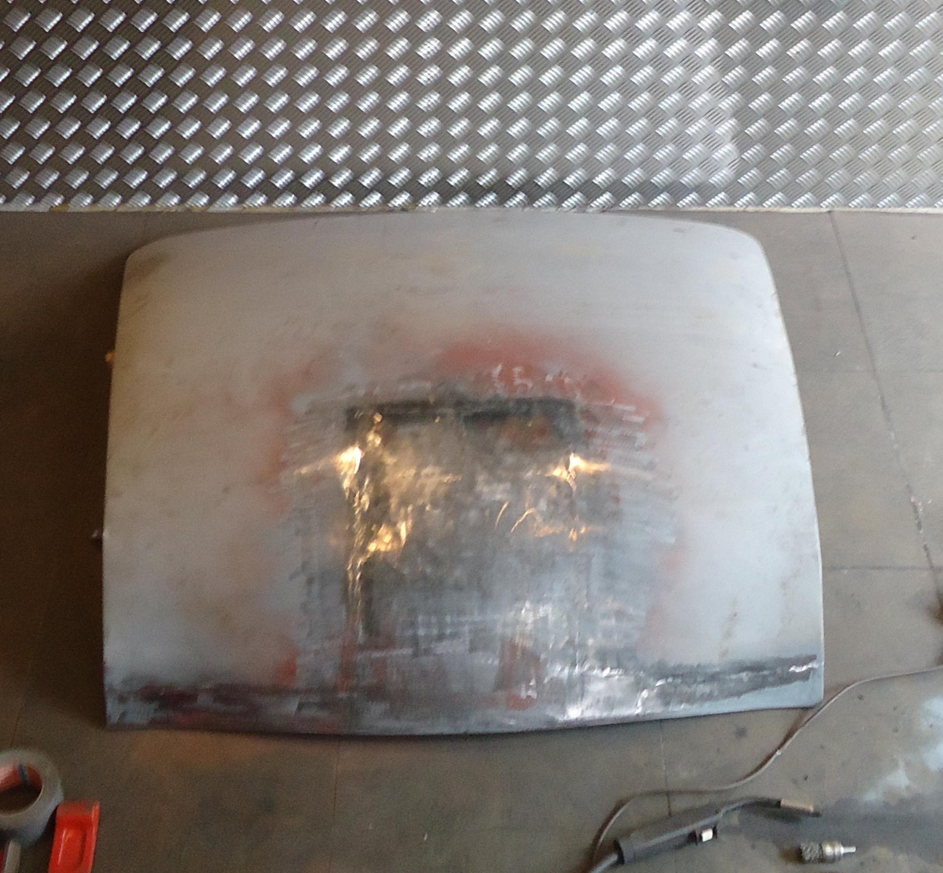

    Spent most of the day finishing up the welds and smoothing it out the panel some more. Gave a quick coat of primer and made a slapper from some steel I had laying around. I'm going to do some serious slapping and hammering the coming days!

    Eric you probably know this tip but if you don't have a torch for shrinking just put a flat sanding disc the wrong way round on your grinder and use that. They make great shrinking discs.

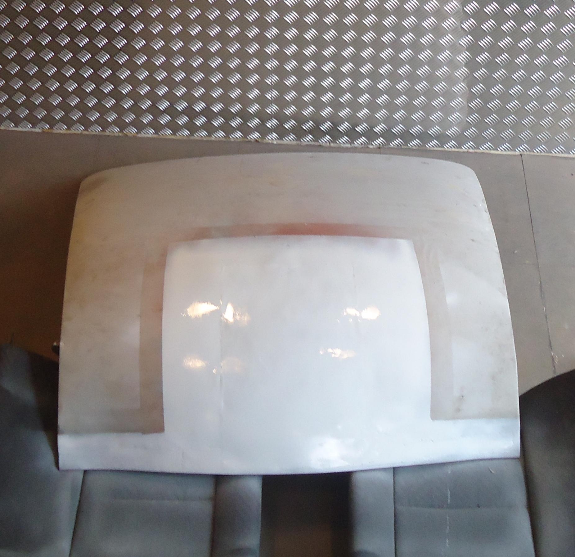

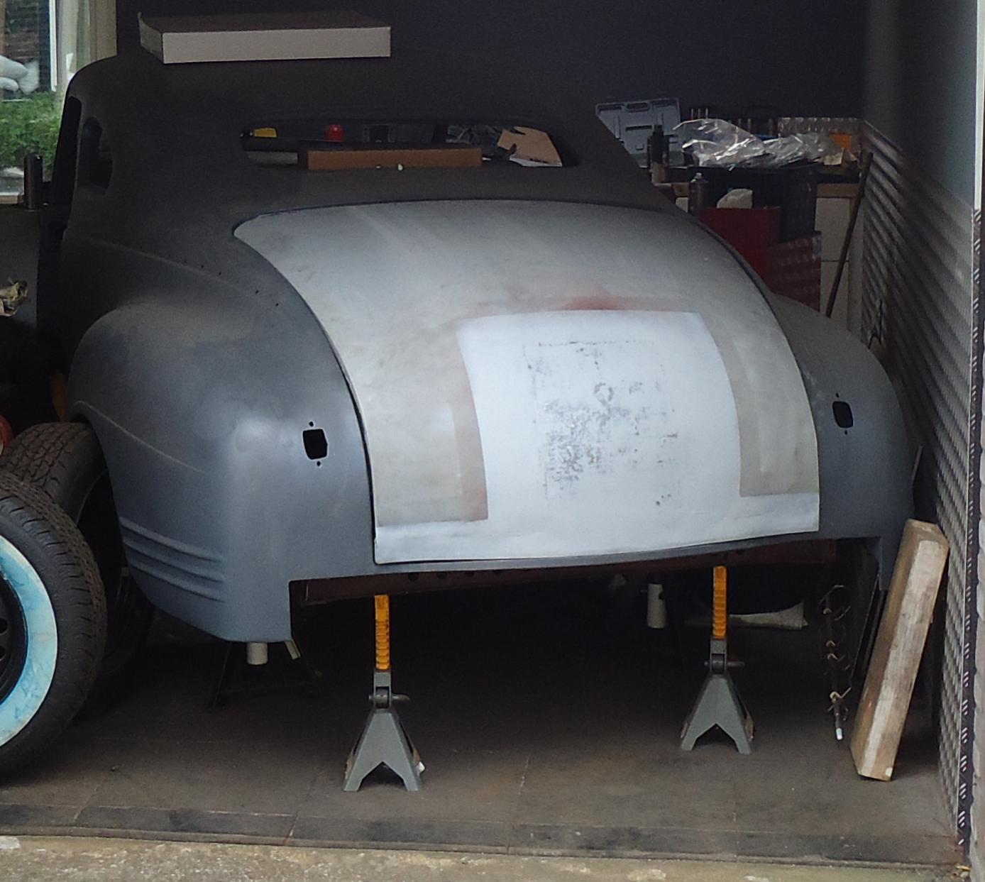

    After a few hours of slapping/hammering/etc I'm getting close to getting it smooth. I decided to test fit the outer skin to see if it would still fit. The only deformation was at the bottom(as expected), but considering it's sturdy metal at the bottom, I should be able to bring it back into shape with a little heat and hammering.

    Thank you finnrodder. If you closely where the bottom meets the body, the sides are slightly protruding outwards. This is the area requiring a little attention. No major job, but I want the contour to be correct before I start on the inner structure.

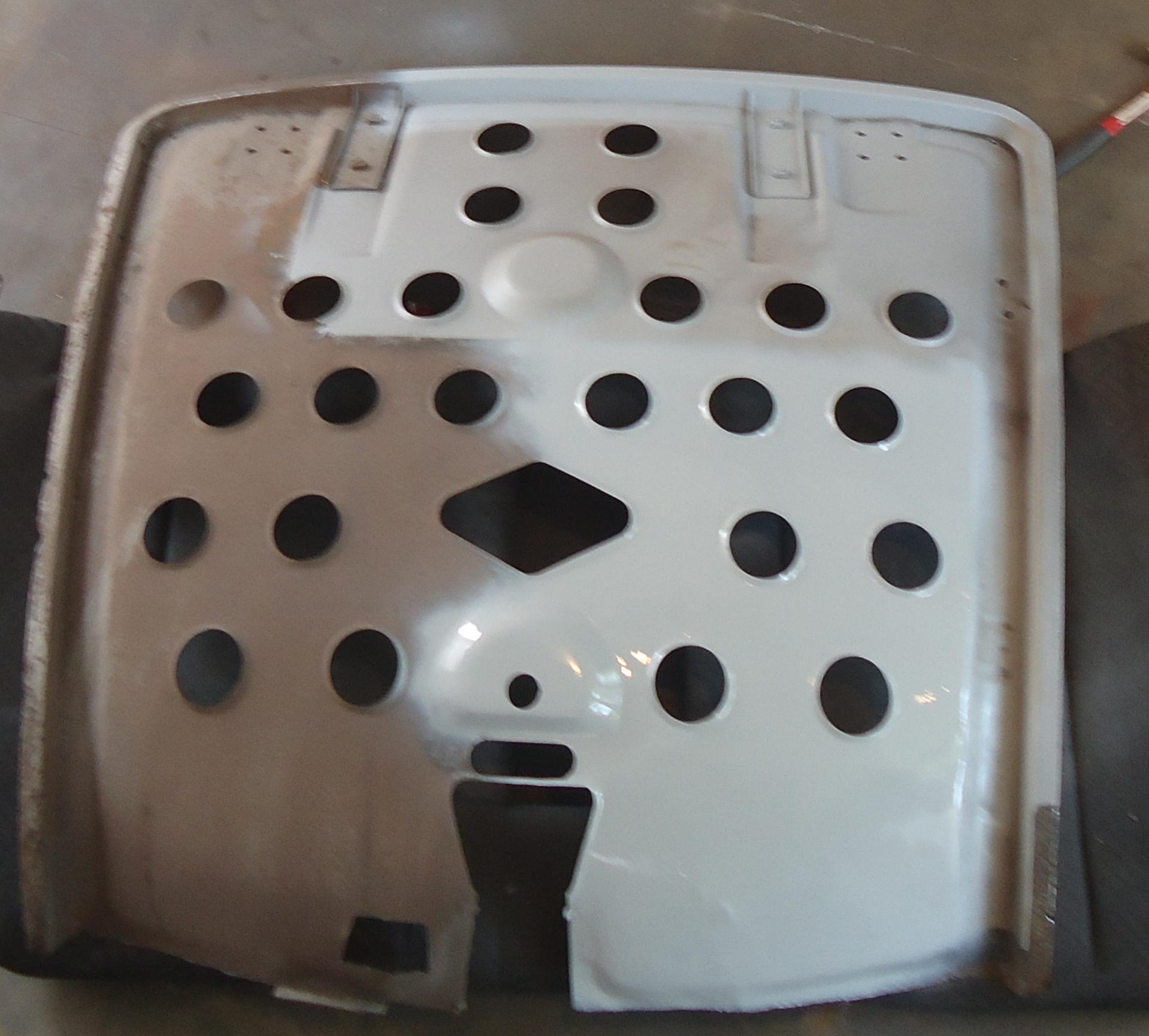

    Spent most of the day on the inner deck lid. Started by methodically cleaning one area, a little welding and hammering and finally giving it some anti rust primer. Then on to the next area.
    I realise that no one will ever see this whole surface but now is the time to completely get rid of 71 years of surface rust. The surounding edges are rusty in places, so I'll be replacing and repairing them in the coming days.

    That inner piece looks like pretty solid.I guess your car was originally from some dry area of US?

    The inner area is very solid, it's just the edges (I'll post some pics in the coming days)that are bad in certain areas. As far as I know, the car is from CA originally. Here's a pic of how the car looked quite a few years ago.

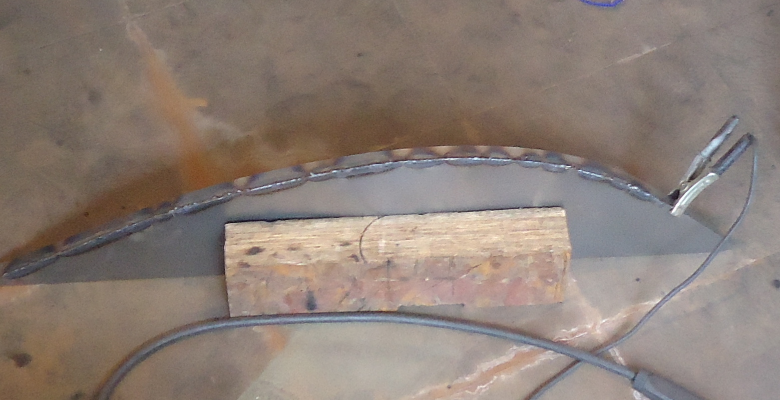

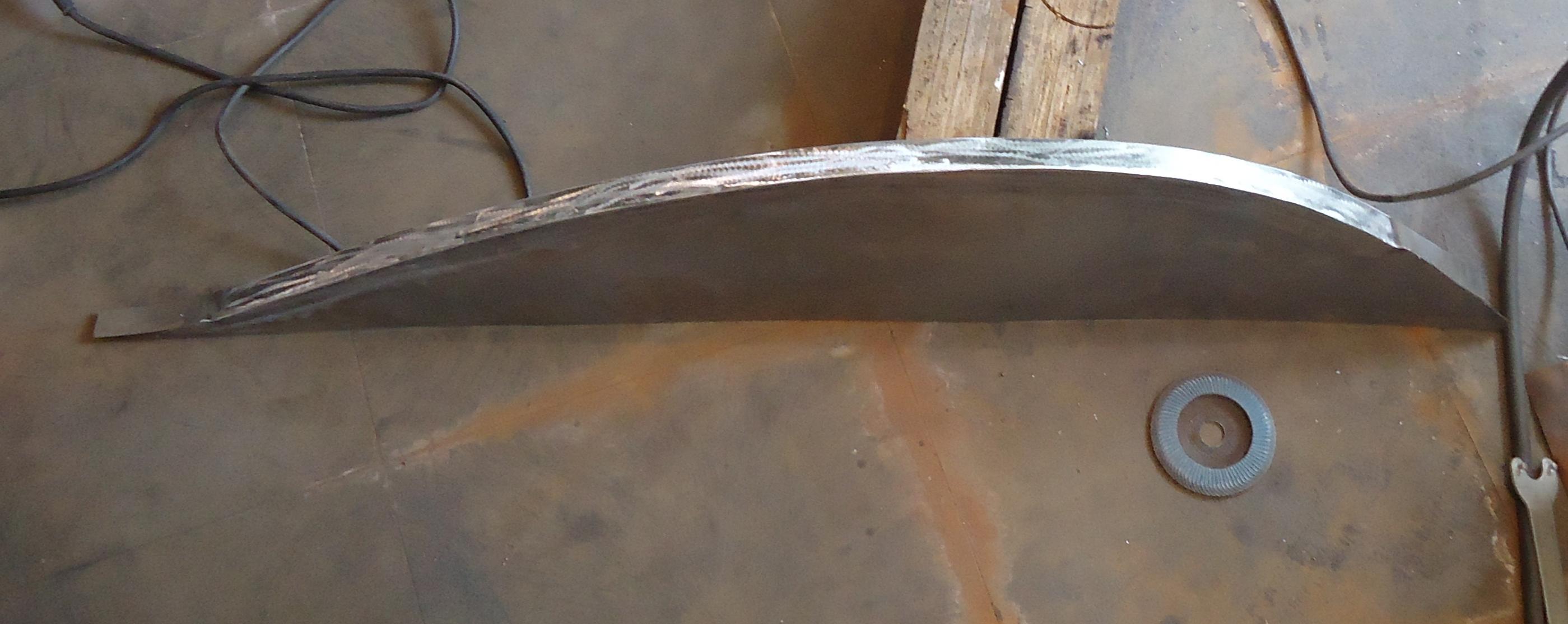

    I needed to replace the rusty channel of the inner deck lid. The first pic shows how rotten it is.....I traced the outline onto a sheet and welded an inch long strip to it, inside and out, to ensure maximum penetration. Then cleaned it up with my grinder.
    The last two pics show the channel just laying on top of the original, and the fabricated piece seems to fit perfectly. More progress next week.:D
