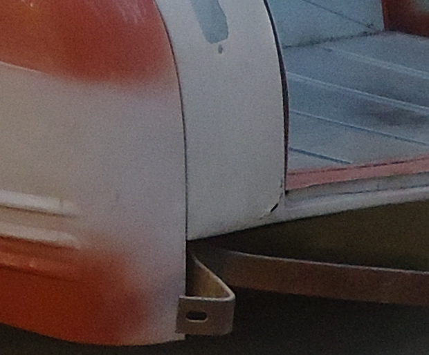

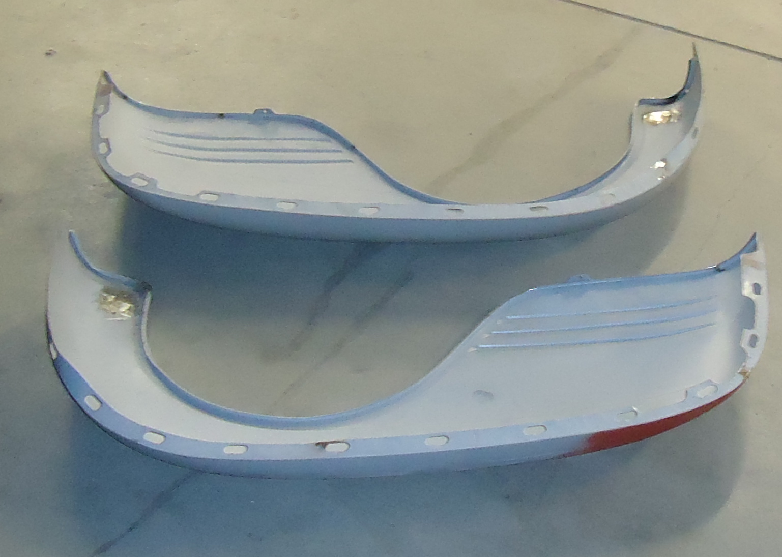

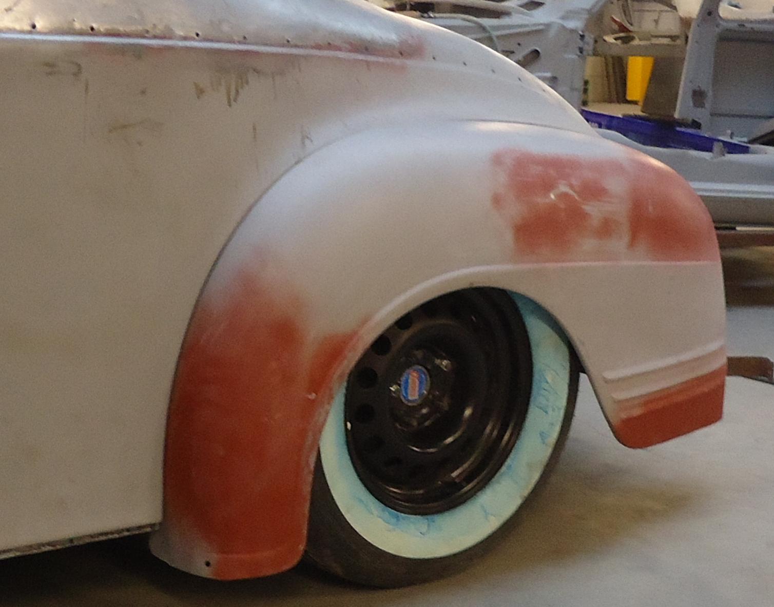

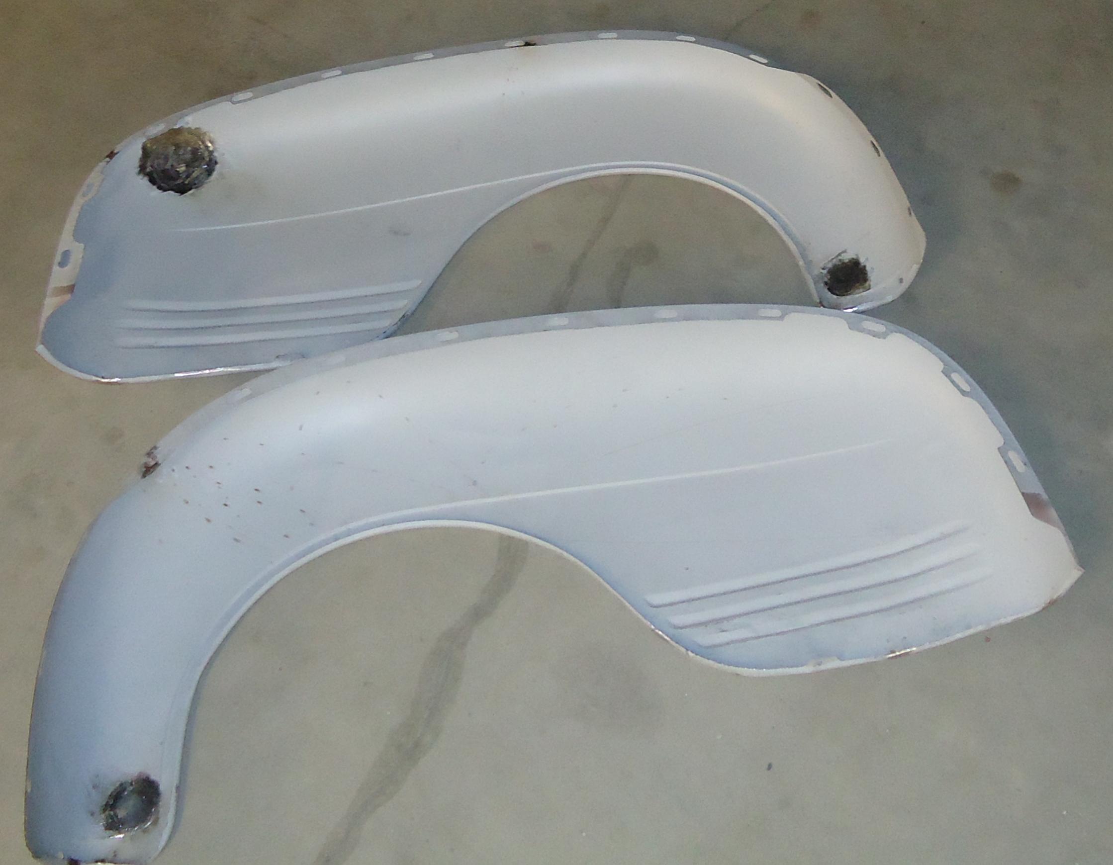

    This morning I started off with filling the hole of the passenger side rear fender. This all went quickly. The picked up several dollies and hammers and started work on all the lips of the fenders. I've spent most of the day re-shaping them. Some of the lips were torn or bent. The most tricky bit was hammering where the radius was small and the lip was bent inwards. With a lot of patience I managed to get lips back into shape. Tonight I started on the left rear fender, beating out the dents that had been created in the last 70 years.

    Good to hear you're still at it Jason. Post more! The hammer and dolly work is quite an art, I'm starting to get the hang of it now. Patience is the key. Good luck with your Plymouth build!

    Hammering all day certainly gives you a sore arm! I finished off the left rear as best I could. Mounted it and it actually fits better than before! Then started on the right rear, which was in worse shape. The final hammering of the two panels I'll do with Martin in a week from now. I can tell you that after 5 straight days of body work, I'm glad it's weekend...man, it's tough work.

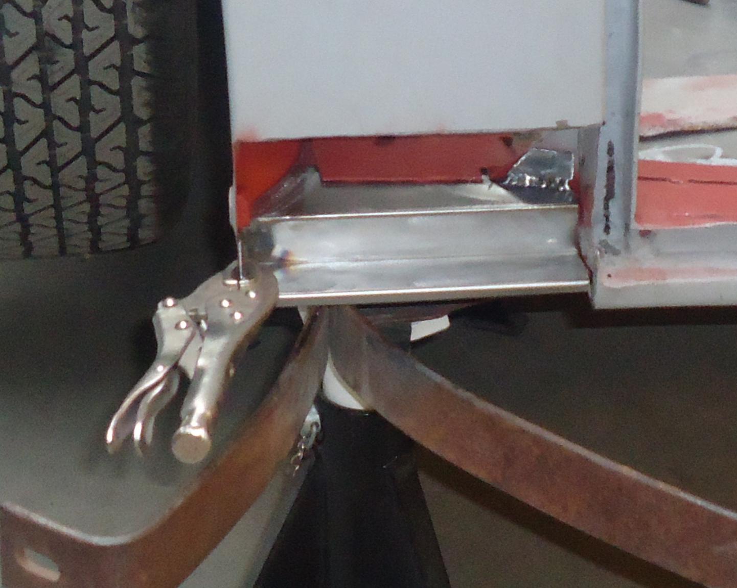

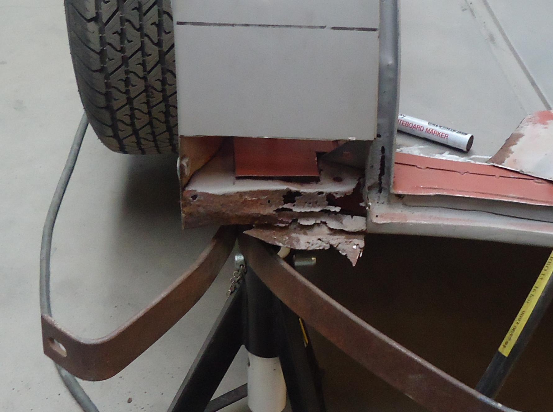

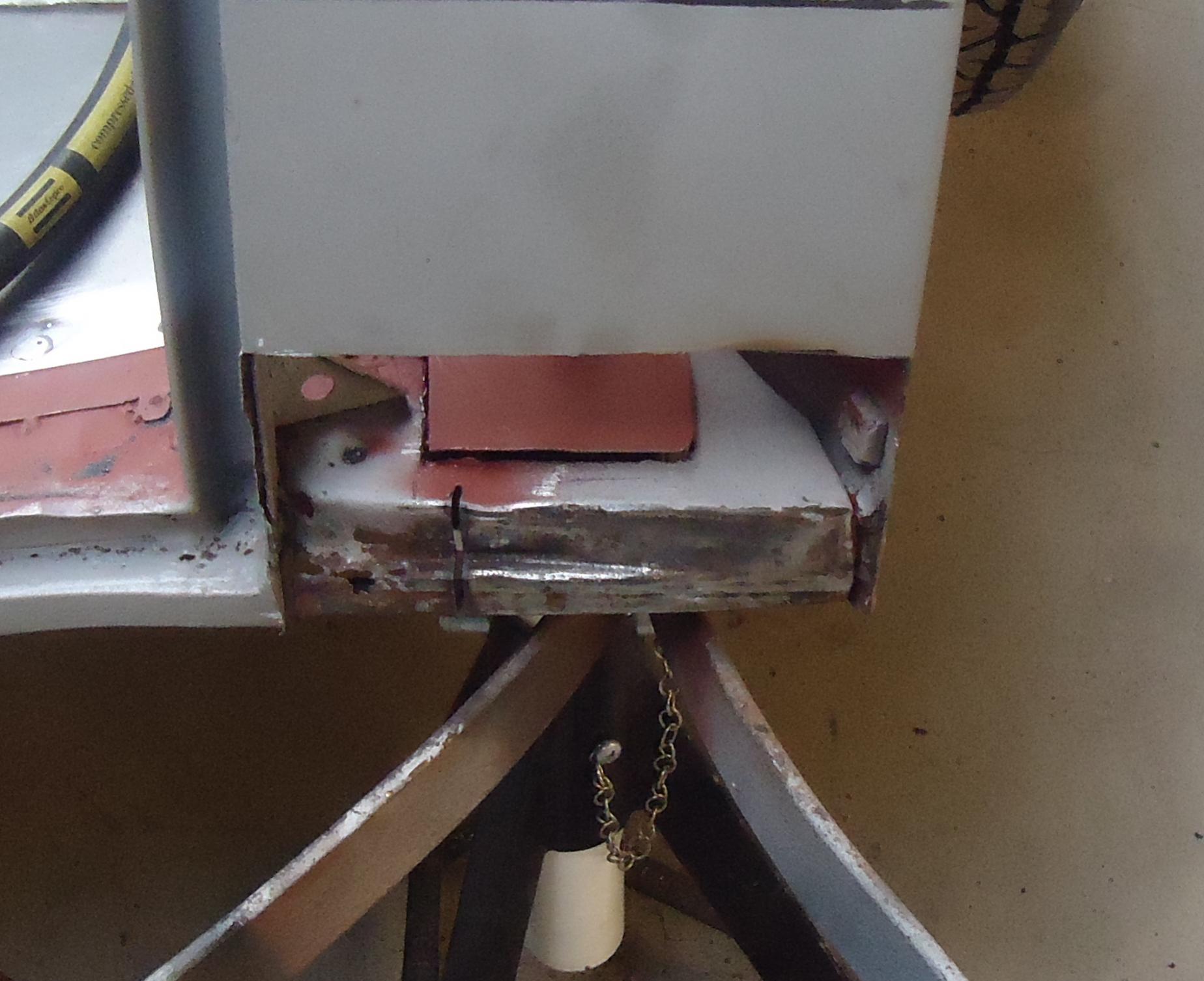

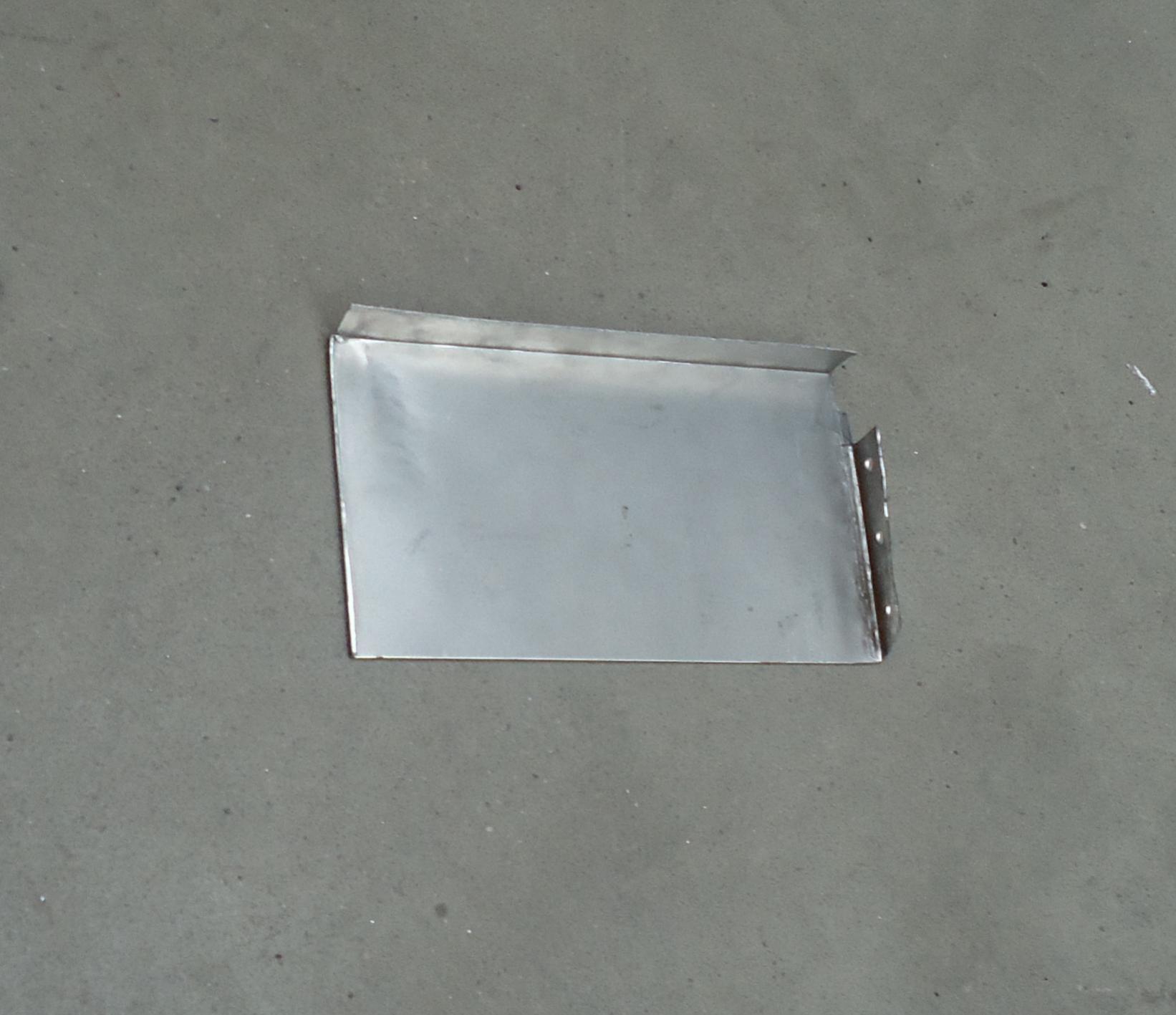

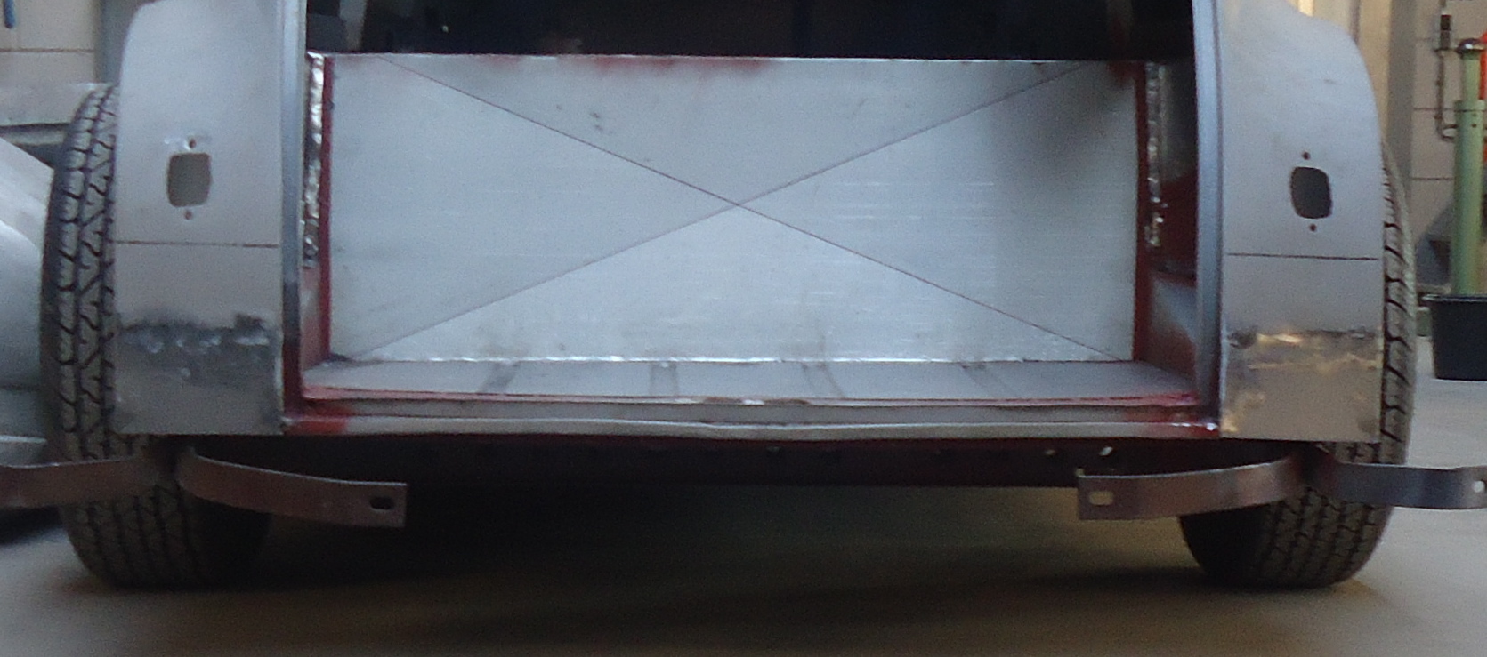

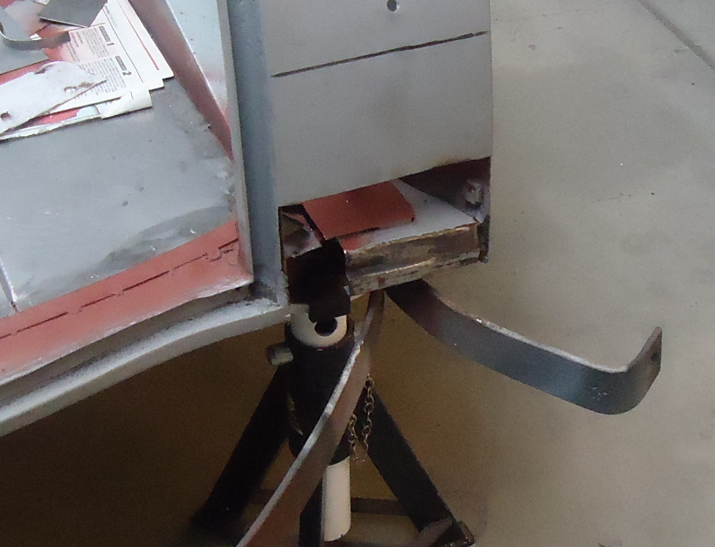

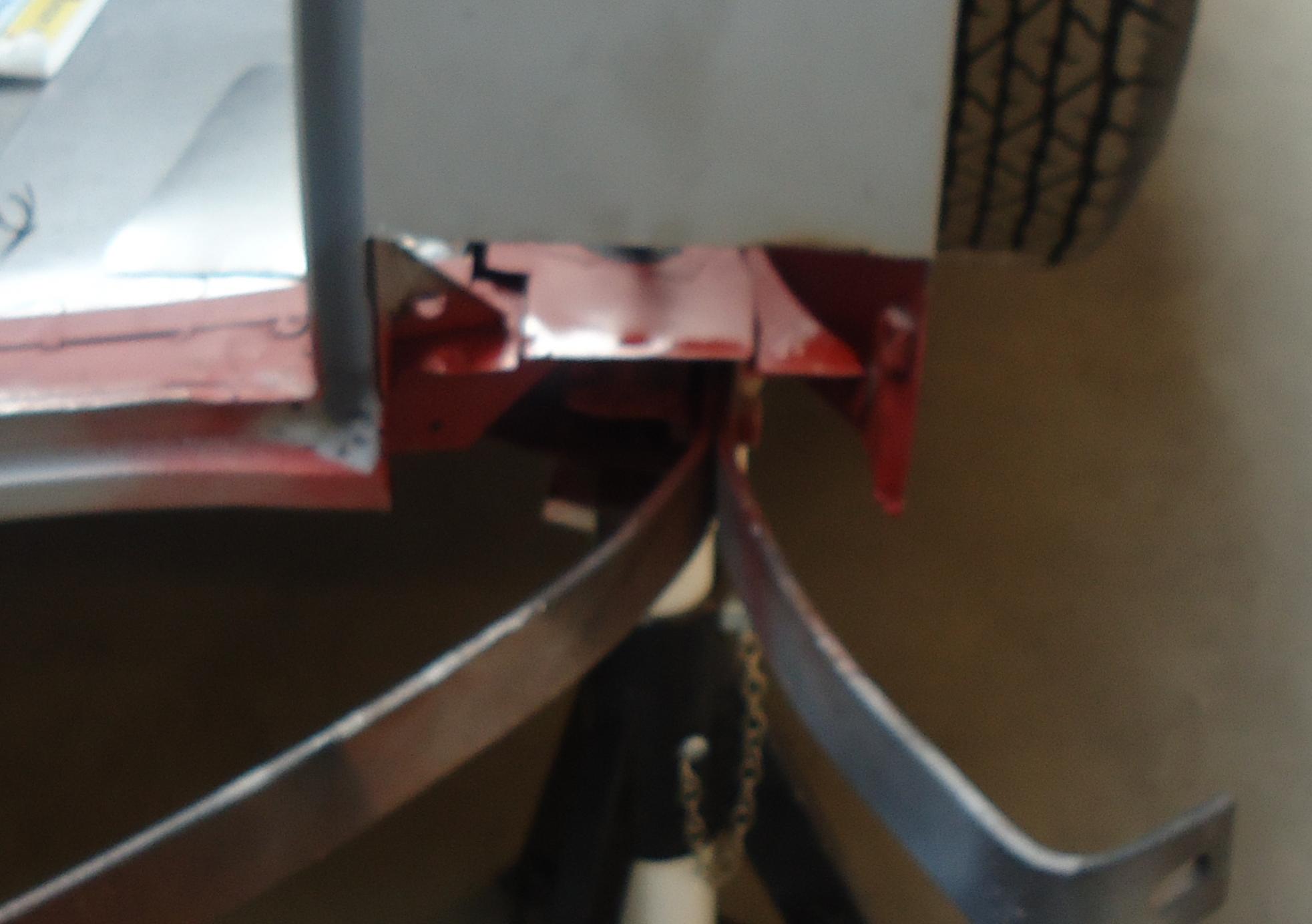

    Yes! Got back to work on the car again today. Made a plan to work on the body from the rear to the front. I want to get it all done in the next two weeks so I can work on the chassis.
    I started this morning drawing cut lines on the rear, the top lines are reference lines. Then got the grinder out and drilled the spot welds. It was no surprise to me what I uncovered: swiss cheese! I was going to replicate the old piece inside but decided to add a few changes for strength. This way I can weld on part of the gutter rail which is rusty as well.
    Then it was time to measure, cut and weld a new piece. After slight adjustments I got it to fit perfectly. Tomorrow I'll weld a piece on the right side to act as part of the gutter rail and fabricate the outside piece. Then it's on to the other side......

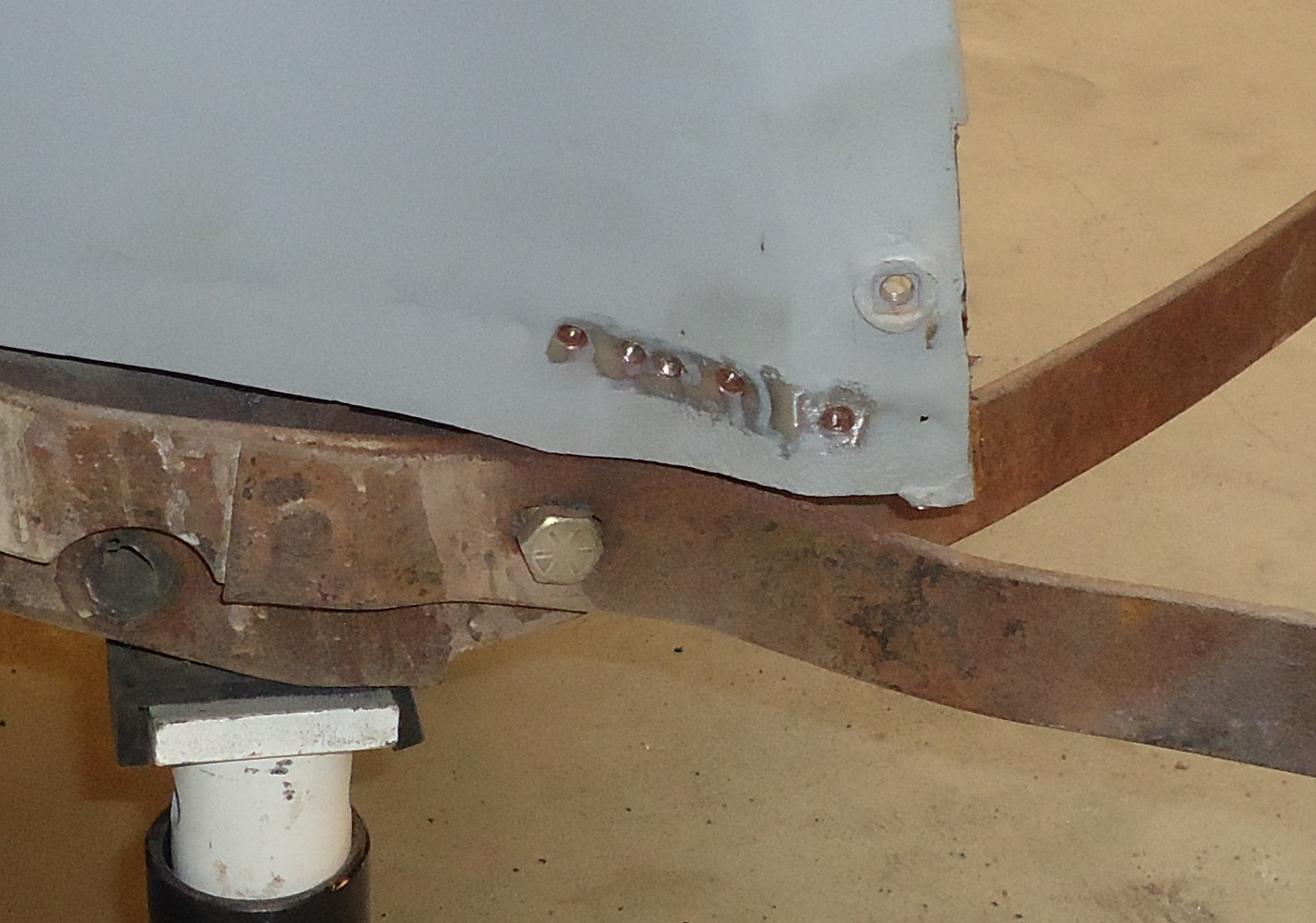

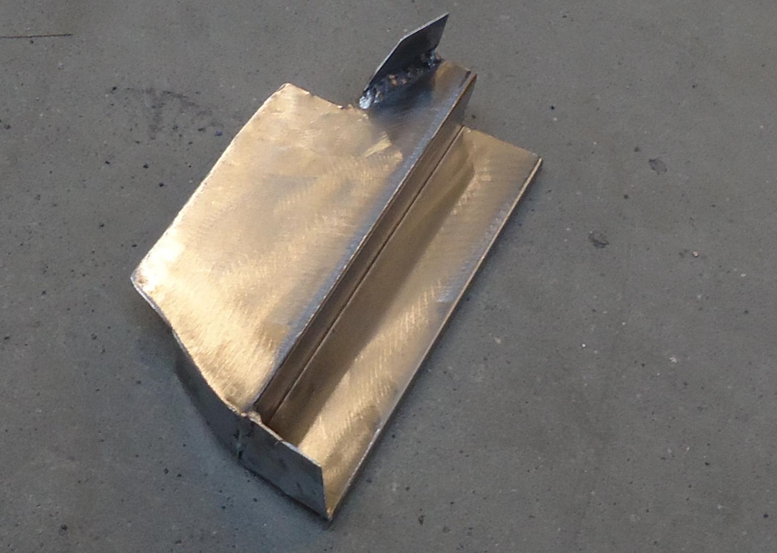

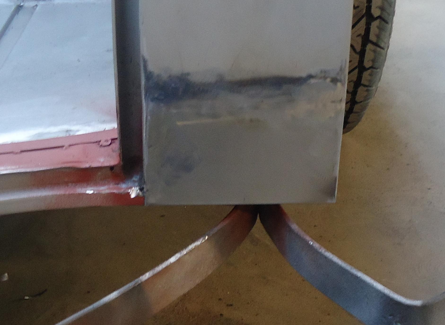

    Welded on the remaining piece of the gutter today. Then fabricated the outer skin, welded it and ground it smooth. Came out looking good. Still need to hammer it slightly though.

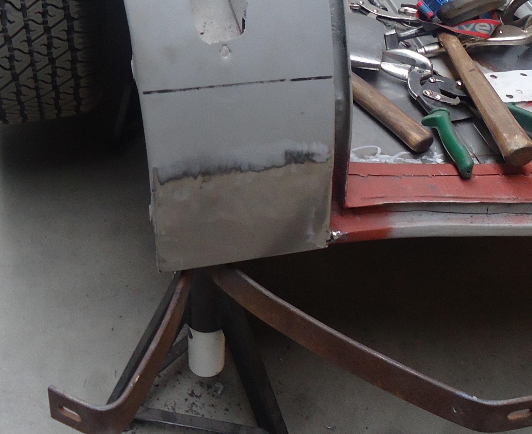

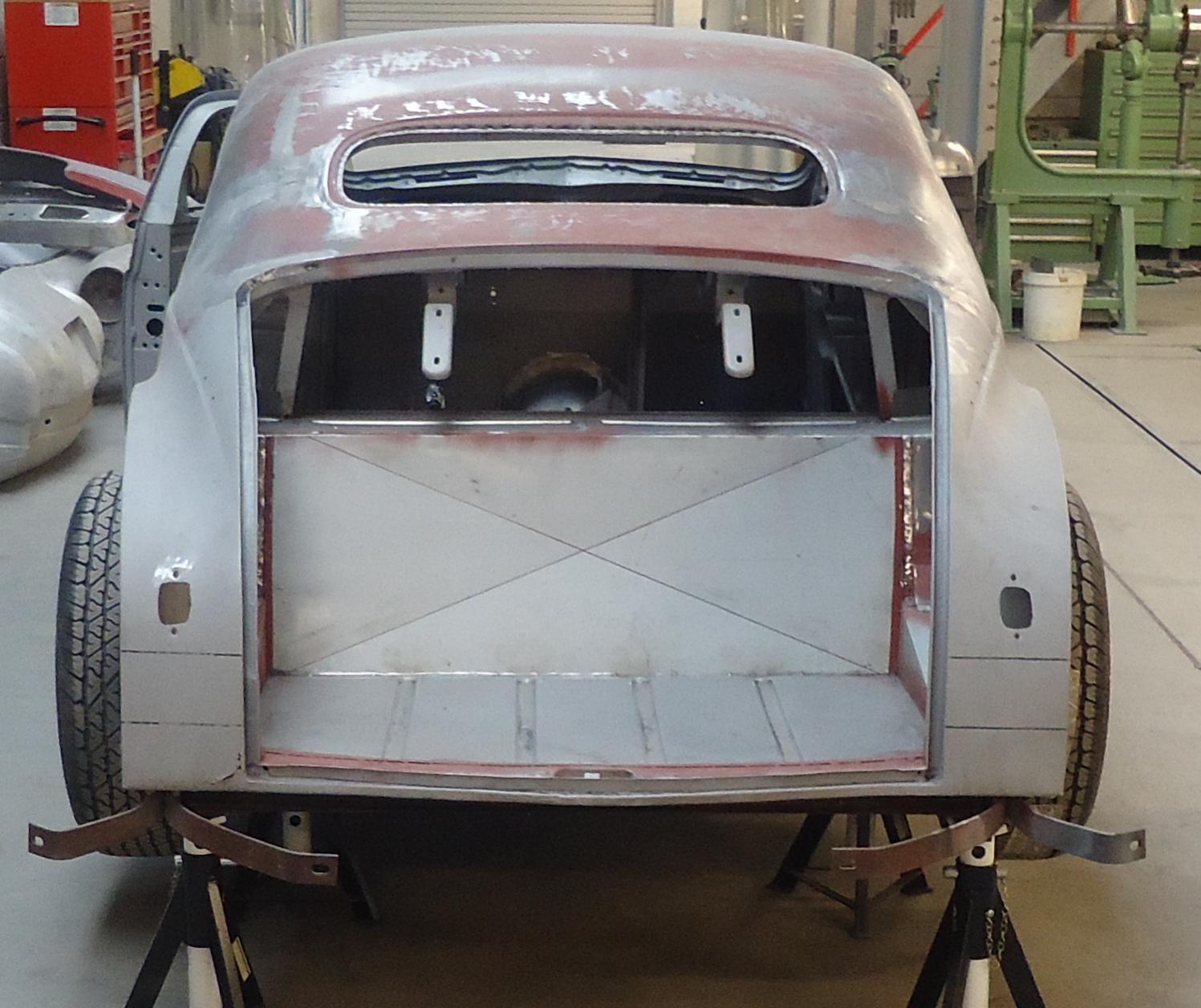

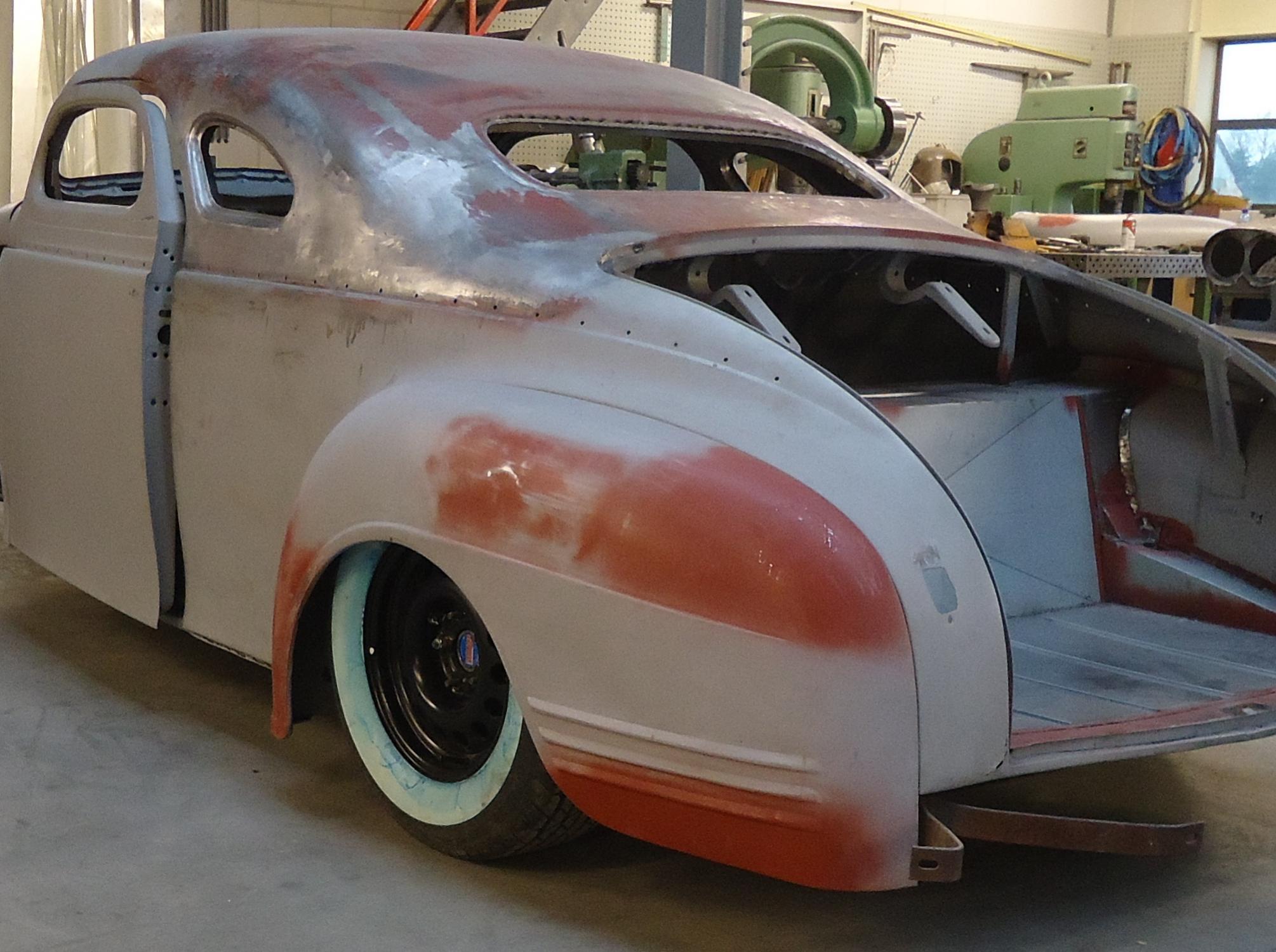

    Now the left side is pretty much done, I've started to cut up the right side. This side is in better condition, requiring a smaller insert. Continuing with this tomorrow....
  26. farmer12
    Joined: Aug 28, 2006
    Posts: 7,717
    farmer12

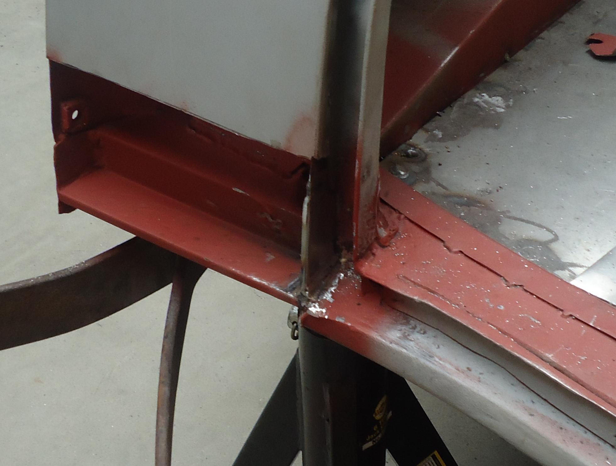

    Changed plans again.....I was going to leave part of the inner structure in place, but just got the grinder out this morning and cut it all out. Fabricated a new piece and welded it in place. Next was the outer skin. Got it all done in about 5 hours, a lot quicker than the other side..... The last pic is a rear shot of the car with both sides done. Another update will follow on monday, it's off to work tomorrow.
