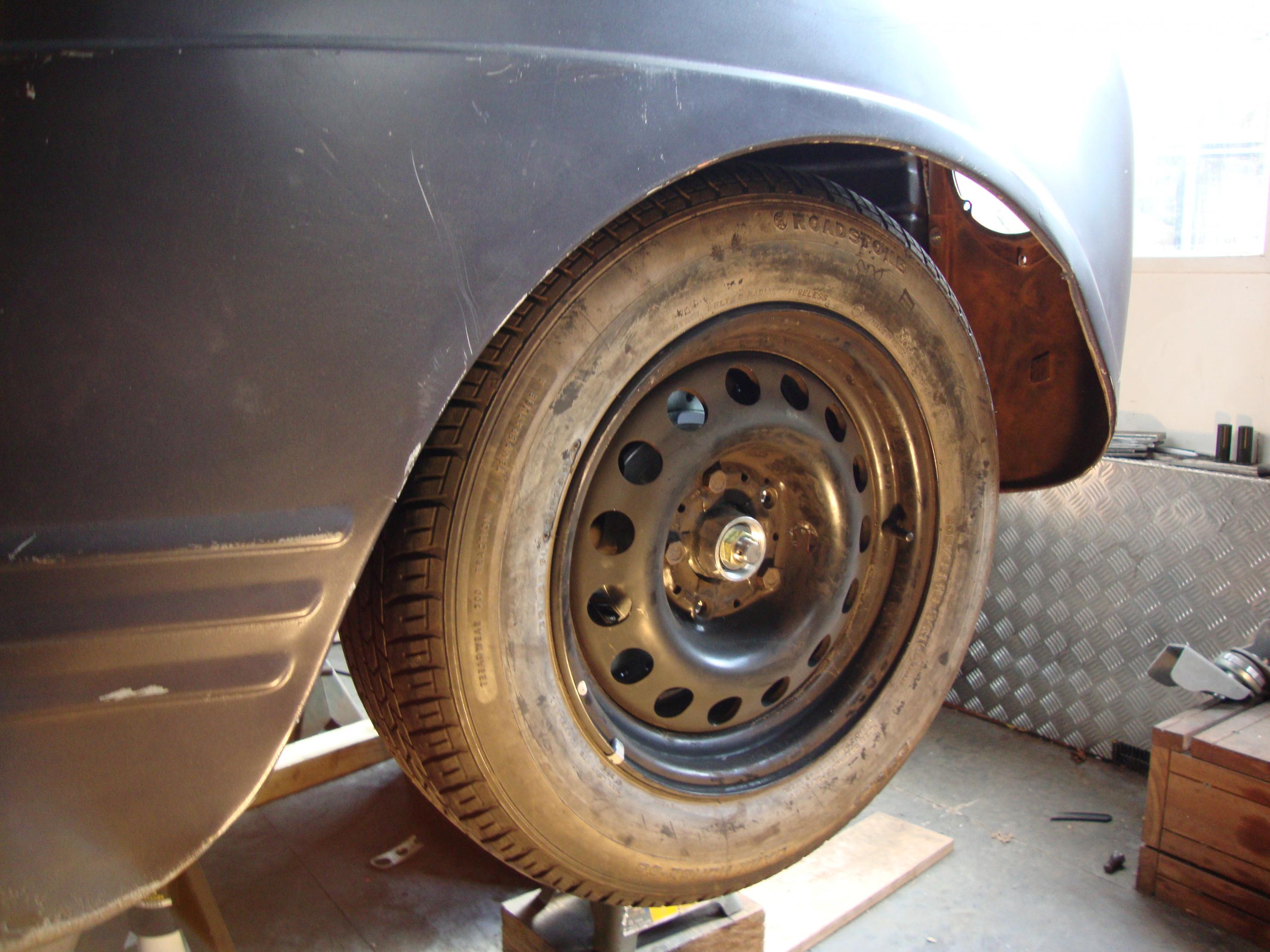

    Here's a photo of the wheel mounted, fitting nicely in the fender. Only touching the front bar with the wheel turned fully left. Will cut some steel of this bar to ensure clearance when the whitewalls will be mounted eventually. The wheel sits fairly deep in the fender allowing me to use some decent hubcaps without them sticking outside the fender. Dutch regulations stipulate that nothing may protrude outside the car.

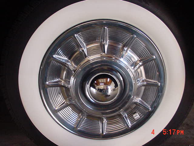

    Found these 15 inch 57 Cadillac hubcaps on the internet. Love this style with the bullit in the middle. I'll probably go with these to get the traditional look that I'm after. Just hope these suckers will fit on my steel wheels.Then again, how different can European 15 inch wheels be compared to the US version? 15 inch is 15 inch after all.....
  21. skooch
    Joined: Feb 7, 2007
    Posts: 254
    skooch
    Hi, Cadillac hubcaps will require modification to mount on any non Cadillac wheel. Should be easy for someone with your skills. Kool car!

    Well skooch, considering I'm a first timer, I suppose as long as the hubcaps are steel and not plastic, I'll find a way to make them fit. Somehow...

  25. Hey Farmer, i remember when i was looking at this the owner had a cool lil metal flaked bobber he rode to and from work.
    Your new front end set up lays much camber it looks like compared to how he had it set up ! Congrats man-

    Camber wise, the wheel has been fitted, but the upper arm has just been losely bolted on. Steering rack has not been connected to the spindle yet either. I just wanted to make sure the wheel would fit. Camber and the rest of the set up will be determined once I get the bag system. Previous owner used the old Plymouth front end.
