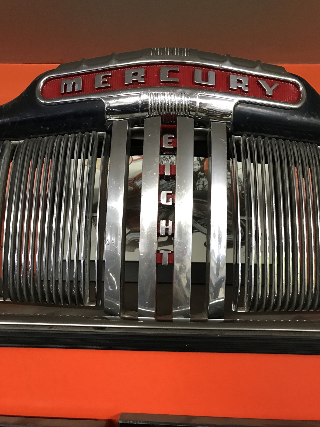

    Yes I do[​IMG][​IMG]

    And I have the grill

    The merc has a fantastic looking grille. Why do you want to make a merc look like a Ford?
