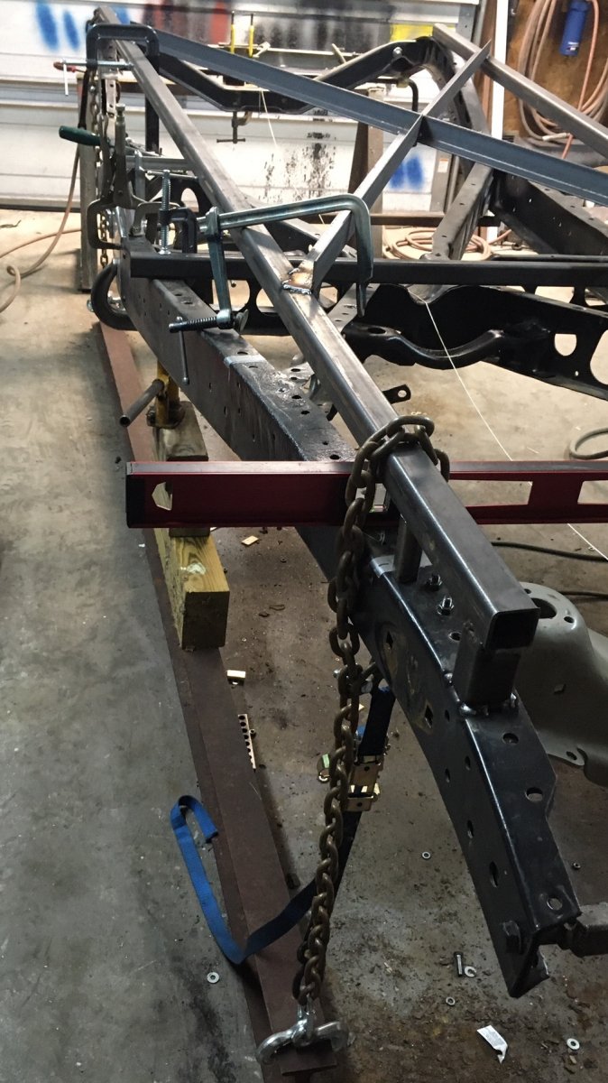

    I'll be moving a little backwards for a while; There is an unsatisfactory frame repair on the passenger side forward of the X member. I didn't notice it until I removed the earlier front cross member to install the correct ( 40 ) part.
    Cab removed temporarily on an old trailer frame.
    We're all ready to go out back for the cross member change and rear end swap.
    The frame is leveled on jack stands with some square tubing to hold stuff in place.
    The metal is thin on the top and side between the tape marks and we're going to replace the outer C first then the inner C . I'll put rivets back where they are supposed to go.

    We started on the repair.
    This added tube and angle iron is supposed to hold the frame in place.
    IMG_1582.JPG I'm going to start cutting welds and removing rivets now.

    I'm deep into it now and I've not provided enough bracing to hold the frame in position. You can guess what's going on from the pics.
    The rear section is tacked on and seems fine; the front section went south. Stay tuned.
